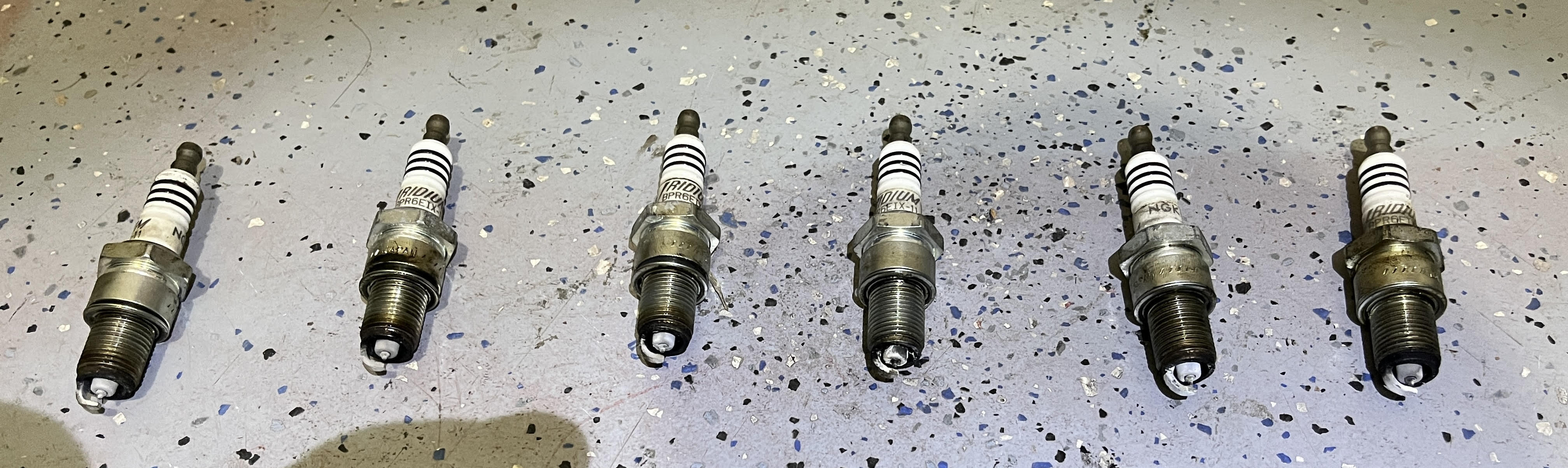

Spark plug question.
Plug image below.  NOTE: cylinder 3's plug's ceramic was cracked so I pulled the valve cover and noticed that cylinder's exhaust valve was loose by at least .004 and has now been fixed.  All other valves were sitting at factory spec.
I pulled the plugs (they've been in there for a few years) and they're white on the top.  I have been using NGK Iridium BPR6EIX-11 plugs.  Since the car is running leaner than stock 280zs (14.7), should I change the plugs' heat to BP5, keep them at BP6, or change to BP7?
Edited by chaseincats
Those plugs show lean and or hot - I would be concerned if my plugs looked like that . I haven’t read your complete thread , but those do not look good
