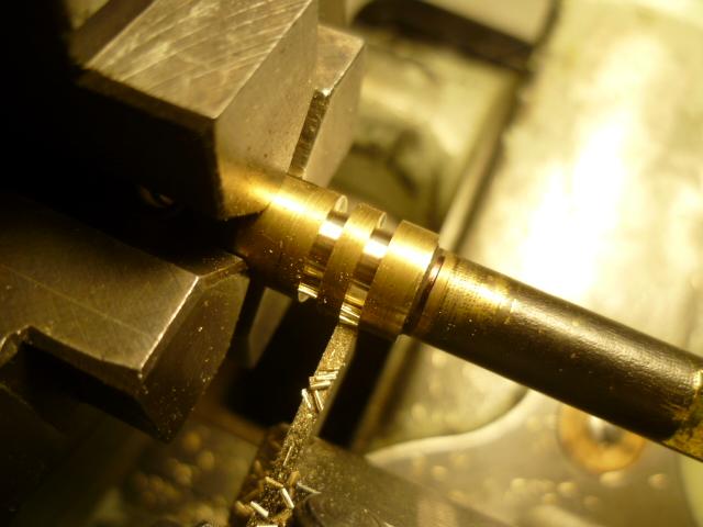

As a remedy, replacing or re-chroming the shafts doesn't seem to be an option and (based on what I've read) re-bushing is not a trivial task.  If I had a jeweller's lathe, I suppose I might consider turning down the shaft ends and adding oversized sleeves that I could then turn down to the correct finished OD.

I don't think you want to entertain turning down the shaft ends just for sleeves. Alignment would be very difficult. Would probably be easier to just make a whole new shaft.

Could one have a machine shop weld in new brass, lathe proud areas to spec then rechrome? Or would it be easier to be completely remanufactured? Seems there should be a bit of market demand for repro throttle shafts?

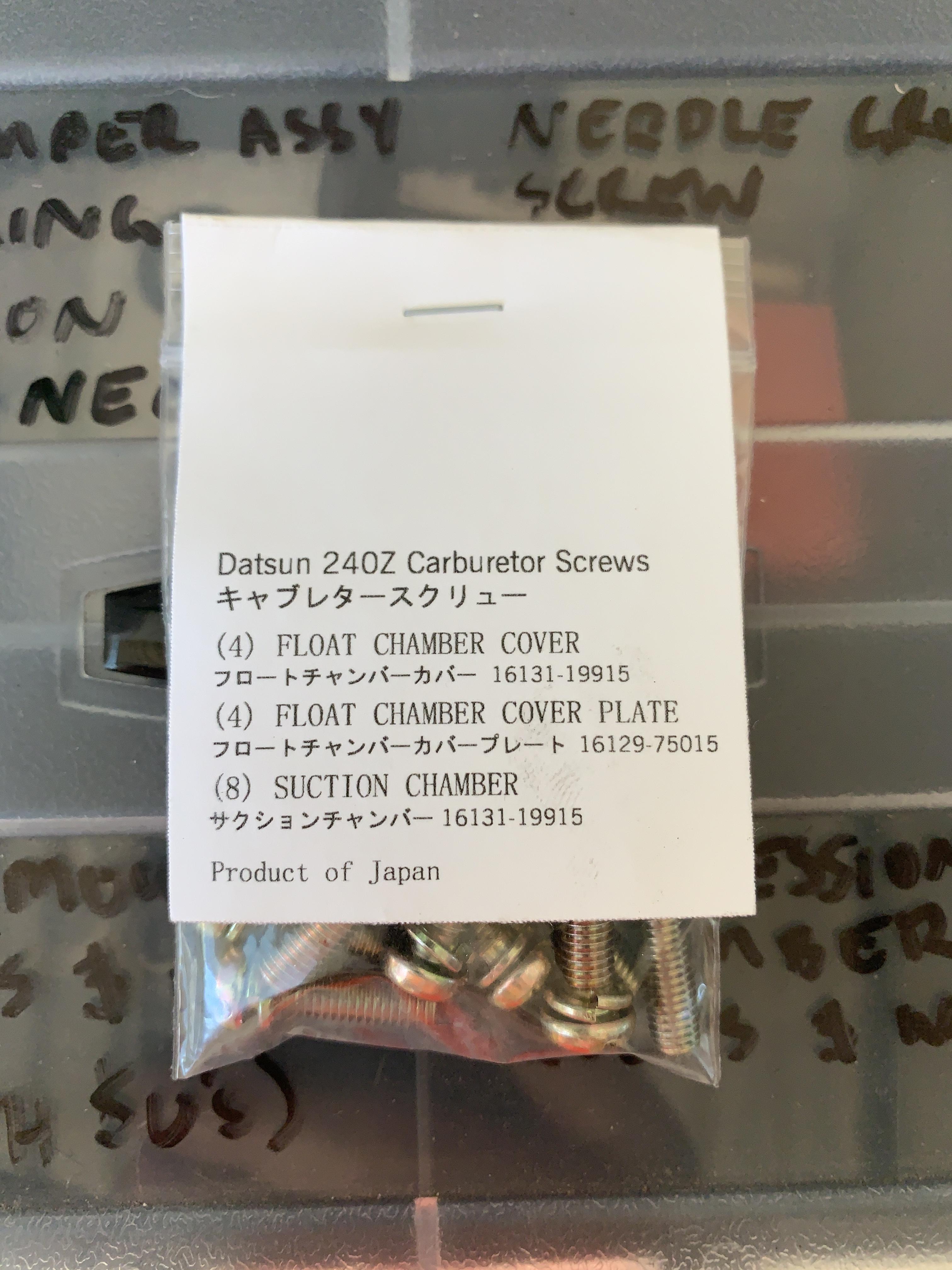

Just for the record. ordered and received these eBay SU screw sets. Excellent quality and perfect match for the old screws. If anyone needs new depression chamber or float cover screws don’t hesitate to buy these.
https://www.ebay.com.au/itm/Datsun-240Z-Float-Bowl-Suction-Chamber-Carburetor-Screws-Set-/164620649300?_trksid=p2349624.m46890.l49292
comparison with old screws, yellow zinc coating looks great
thanks @Zup for finding them and sharing the link!
