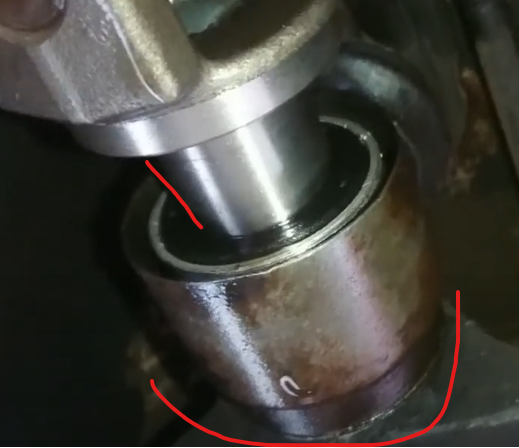

My imagination says that seal is not actually tight on the slip yoke.  Can't really tell from the video.  I notice that the aluminum seal seat is kind of dinged up also.  Could it be that the tail shaft housing is cracked, or gouged?  There are two sealing surfaces, one at the yoke and one at the housing surface itself.
I used to have several shafts and transmissions out in the garage but don't now, otherwise I'd be out there comparing slop.  Maybe somebody here can do that.
And, more spitballing, there seems to be a lot of fluid up at the front of the dust cover.  Still wondering where, exactly, the fluid is leaking from.
Last one - the yoke seems like it should be seated farther in to the transmission.  That would affect how much support the bushing gives it.  Might be an illusion because the dust deal has been removed, but usually the shaft dust seal inserts in to the transmission dust seal.  Your propeller shaft looks too short.  There is a short version of the shaft out there that was used on the very early 71's.  1 1/2" shorter, I think.

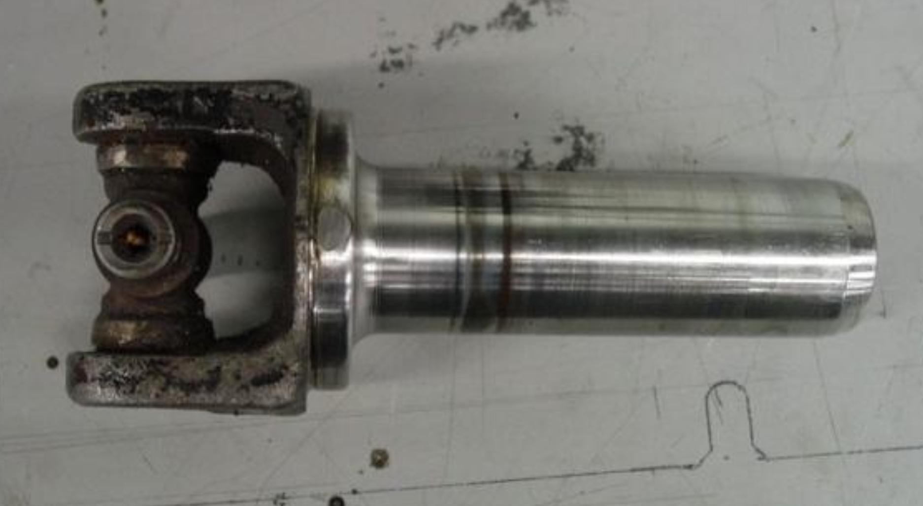

This is the amount of play the yoke has:
Well.. THAT is MUCH to MUCH play!!!  The spleens (Hope i have the right words haha)  In that yoke have to meet the spleens on the out-shaft perfectly.. with no play, i can clearly hear in your vid. that it rattles..  I looked at the vid few times at it seems to be that your propshaft does NOT fit your gearbox at all!
Also i hope you hadn't installed the propshaft, (just holding in your hands) if the shaft was installed, it's a to short shaft!   (Like zedhead sayd, from a diff car year..) Get yourself an other propshaft, with good spleens in it and look if your spleens on the outputshaft of your gearbox are not damaged!
Must i say it... again.. there should be 0 play on that..  remember also, if your driving in 4 of 5th gear at high speed, that propshaft turns at a very high speed!   If that connection breaks  there is a possibility that tha shaft will hit the bottom of your car very hard, some say that it can take off your leg(s) if your really unlucky !!    So, don't take it lightly.
btw, if i see the video, i'm surprised the oil does not leak out immediately..   The play is also that big because your yoke is not pushed far enough onto the outputshaft.

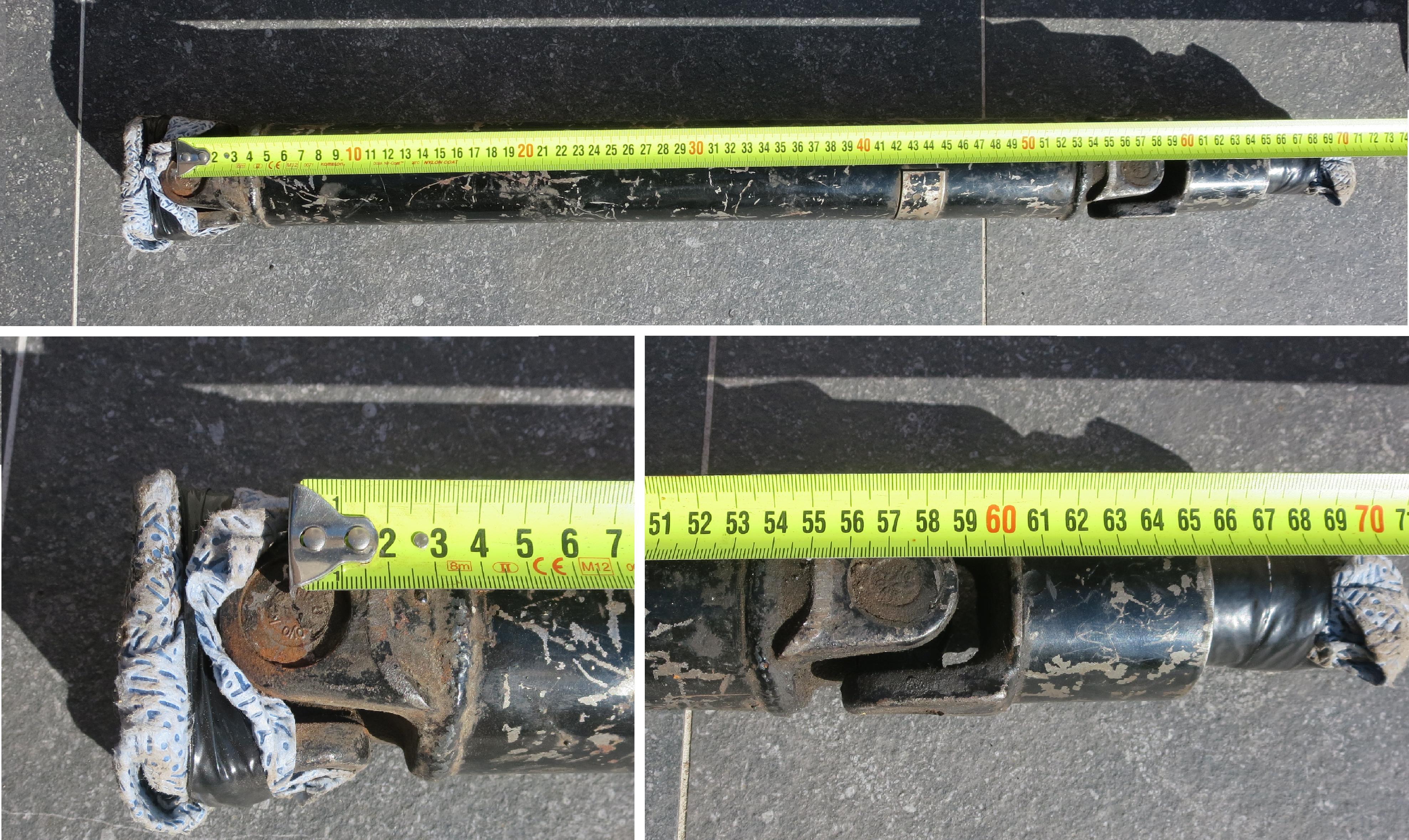

The proppeler shaft should have a uni-joint center of cup to center of cup measurement 575mm. The shorter version should be 525mm., give or take a couple mm. I took these measurements with a tape measure.
The 280Z with non servicable uni-joints is 565mm and the 2+2 is 865mm.
Looking at the screen shot Zed Head made, I don't think you have the short one. It doesn't look like you can get another 50mm between yoke and tranny housing.
You can see where the seal was in the my photo's.

Did you try it on the slip yoke first?  Just curious.  Looks like a good bushing, meant for the job.  Did you put the hole at the bottom?
