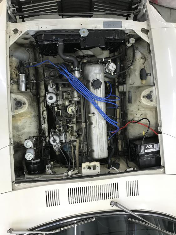

Some pictures would help out in this case, I think some of the float bowls do not have drain plugs. What does yours look like? On the dome of the SU carb are there 3 screws or 4 screws holding the dome down?
This is the best I have tonight. I’ll get more pics tomorrow morning if necessary?
This is bothering me. :rolleyes:

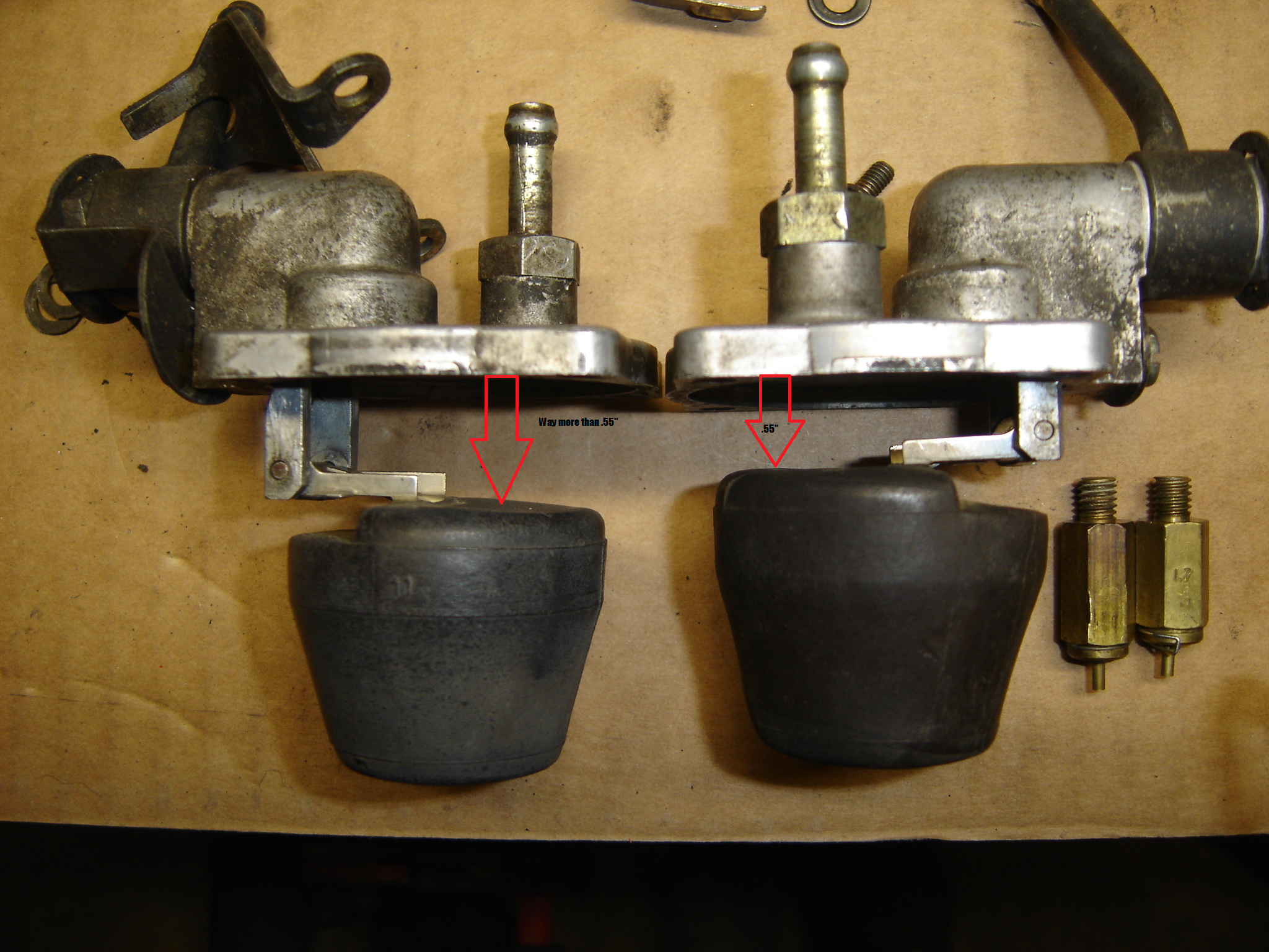

I don't see there's any way to put the bowls on wrong. He's got to be talking about the lids.? The front carb lids have longer ears that attach the floats. They did this to compensate for the fuel sloshing back on acceleration but that was the 3 screw domes @heyitsrama spoke of earlier.
Here's a pic I posted to show someone the different length valves. You'll see the mounting difference for the floats. Good luck figuring out your issue or non-issue I guess.
 I agree. The bowls should be the same with the confession that I've never had a reason or felt the urge to remove the float bowls from the carb bodies.
