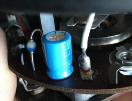

And, on the capacitor question, he showed a nice shiny blue electrolytic capacitor in one of his pictures.  The side view.
Yeah! i figured i had it all apart, and I had some of the correct caps in my parts drawer, the original one seemed like it was working correctly. The varistor is tucked nice and cozy inside the tach in the dash now. I don't see it used on the 260z tacho that is on the bench. But I still need to get the the 280z tacho tuned with a known good RPM source as i messed with the potentiometer. I asked the neighbor if he had a wave form generator, he did not but he was able to make something with an arduino and a potentiometer, we tested 0-300hz @ 5v and the tacho did not respond. I think it might have been an issue with the waveform that we used, i did not ask him which one it was, ill ask him when i see him. I dont have a 12v transformer that i can use to test it out, that might be another option.

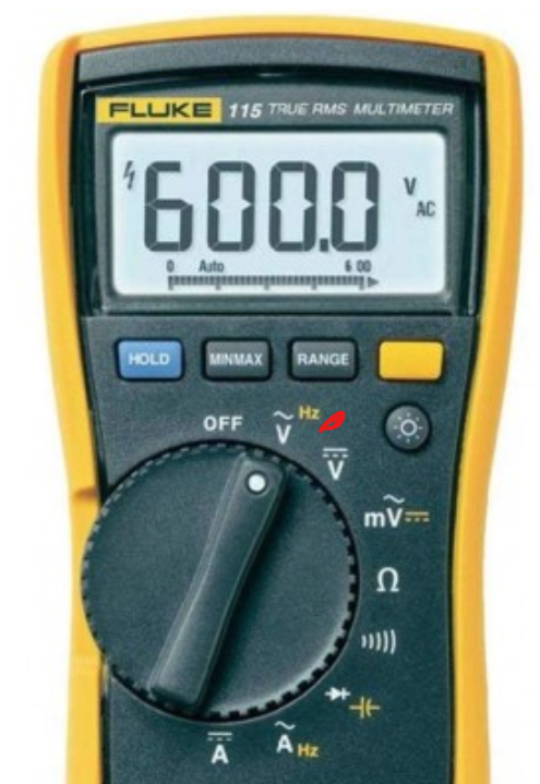

You can use the AC Volts (Hz) measurement function on your meter if it has it to count coil discharges.  Not typical alternating current but the meter doesn't know that.  I'd guess that's what the automotive meters do, but with internal software to do the math and convert to RPM.
