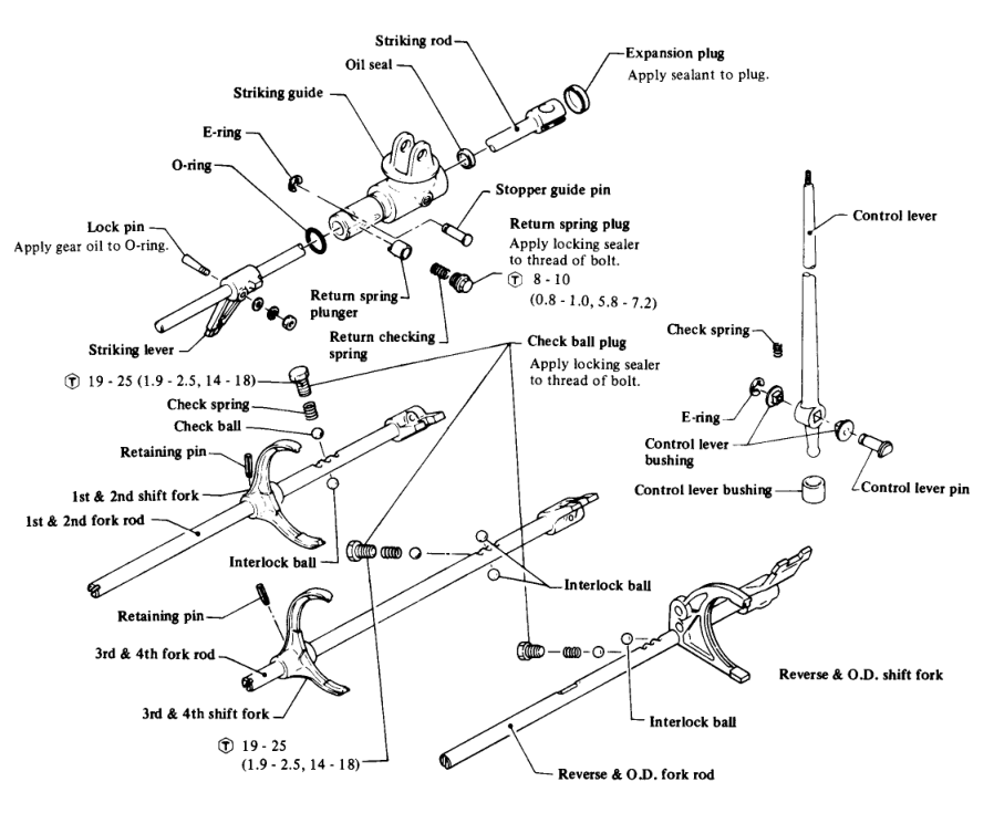

Could be something to do with the check and interlock balls.  Balls that are pushed in to notches to keep the gears in the correct place.  I think that you can check those without removing the transmission.  EuroDat knows more @EuroDat

I don't think your selectors are an issue atm.
