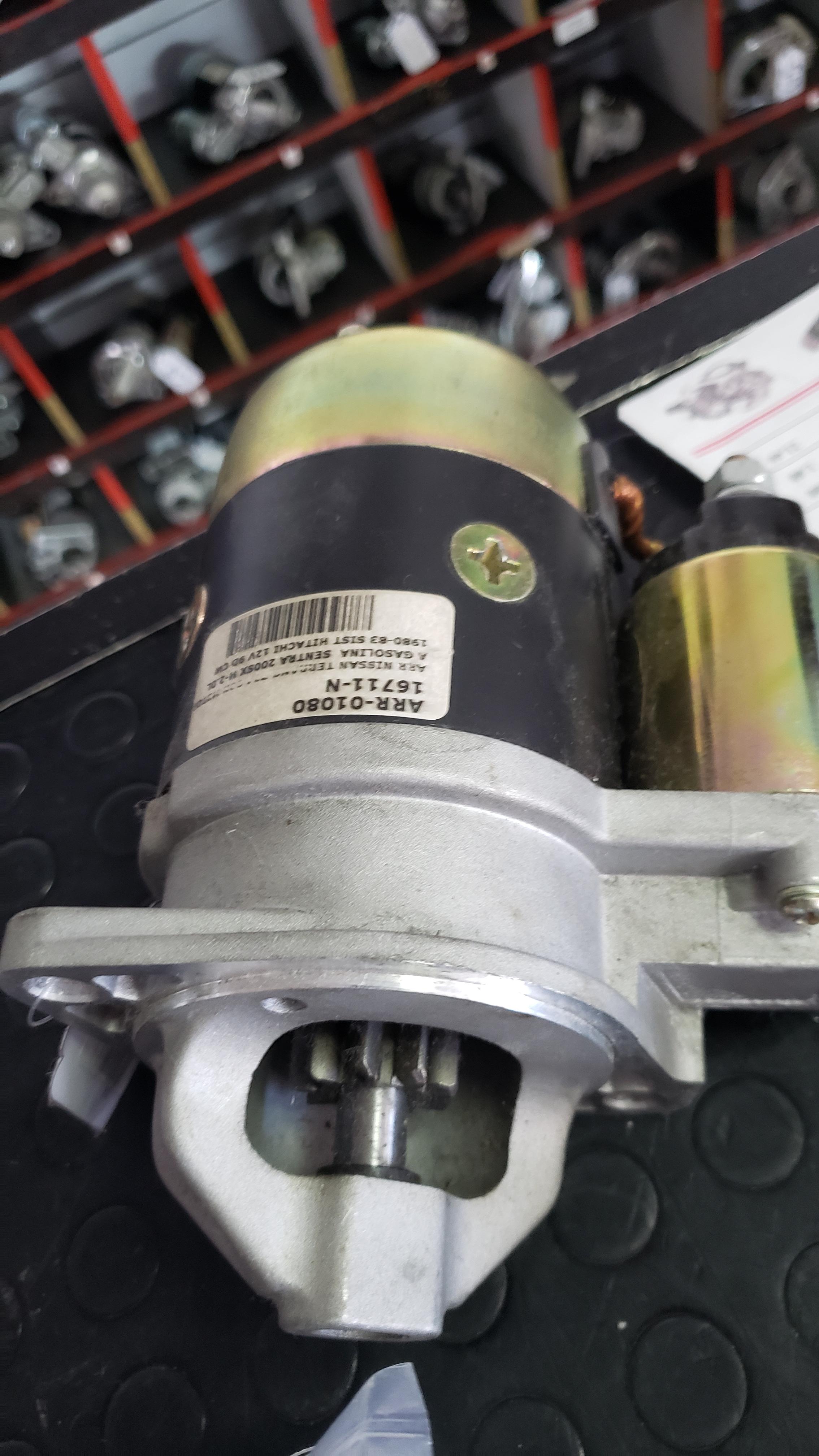

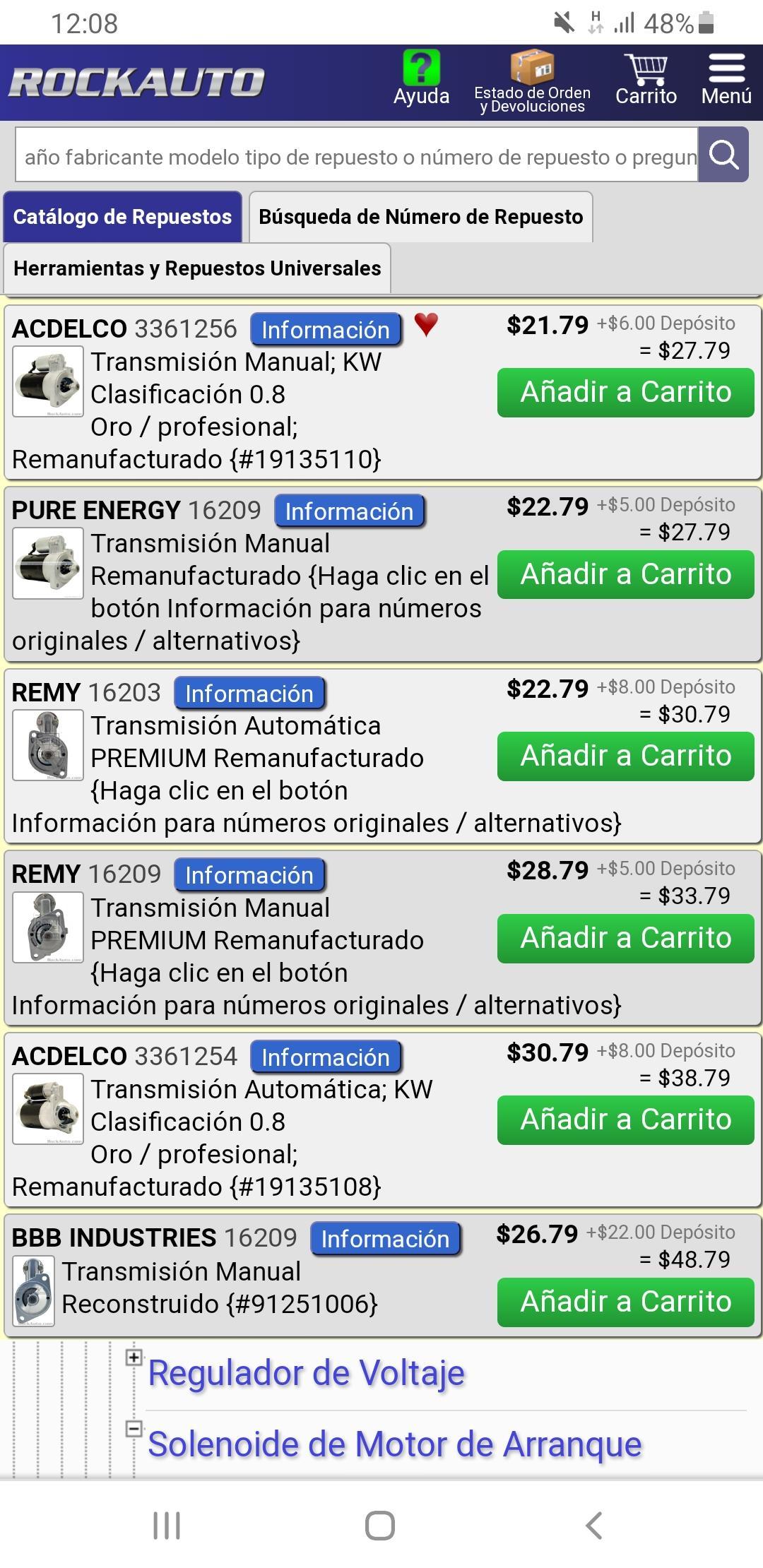

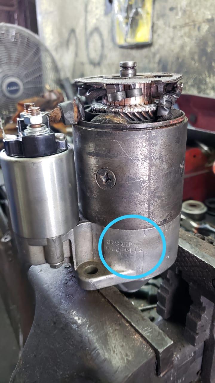

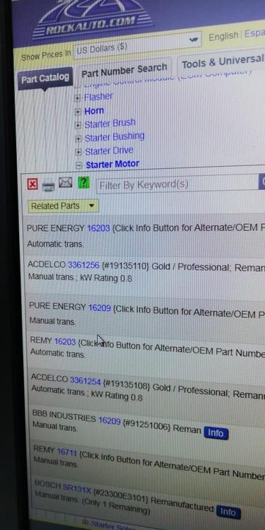

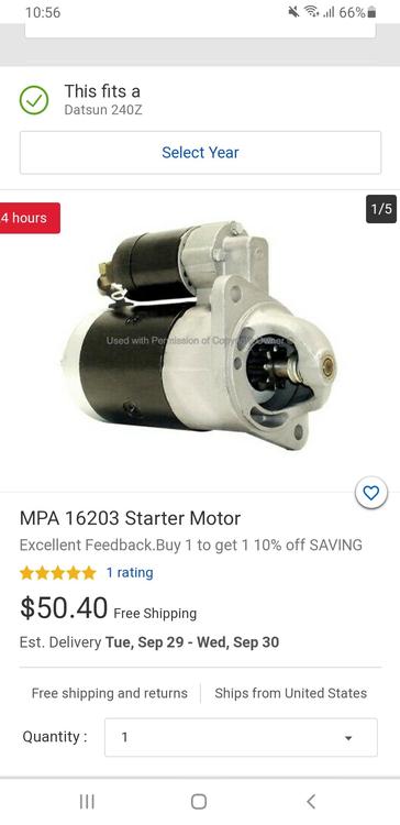

After several attemps of rebuilding my starter motor i figure out it was better to purchase a new one. Which one would you recommend? I can source the one in the first picture locally. The other ones by internet. Please give me your feedback.

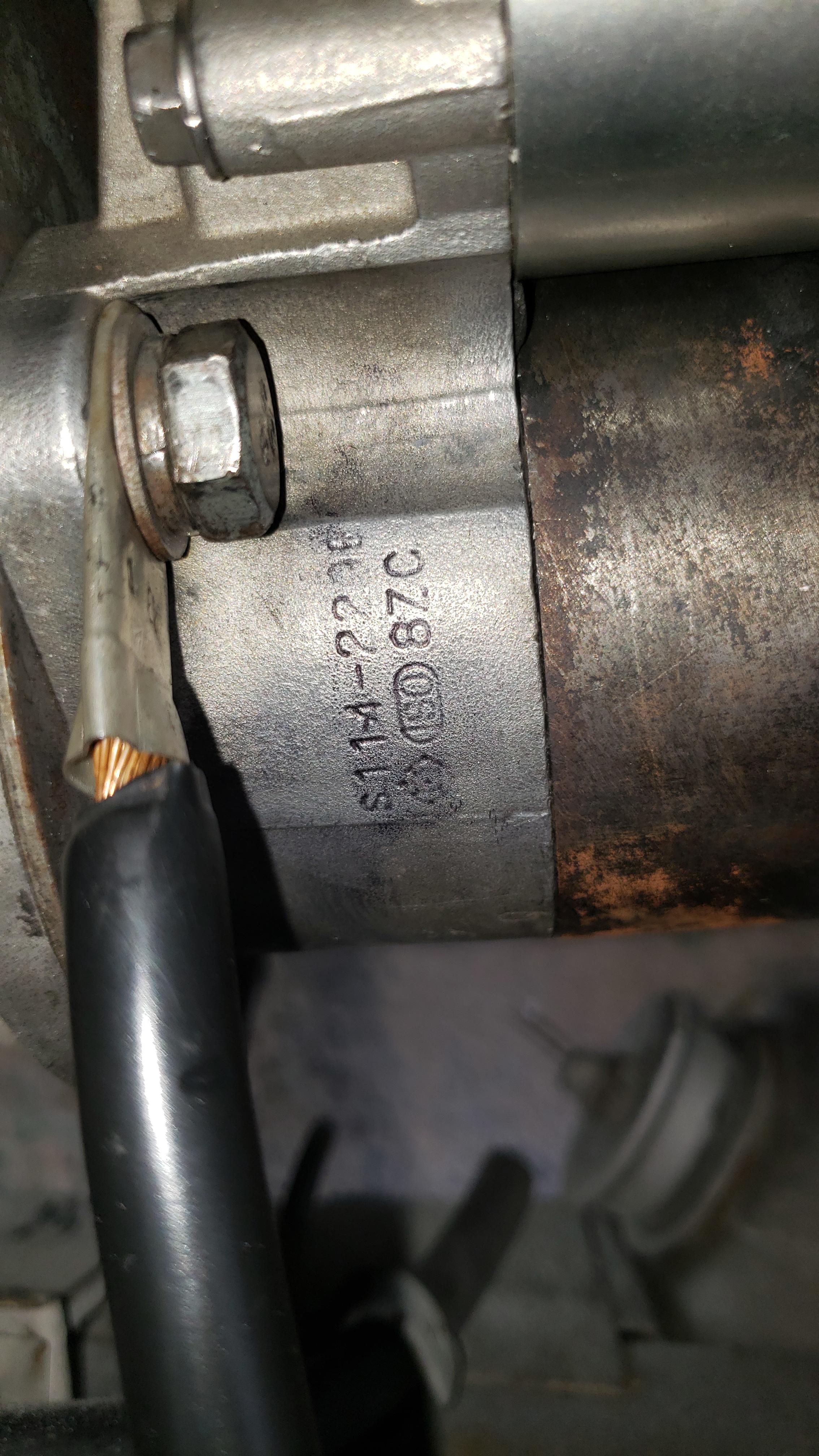

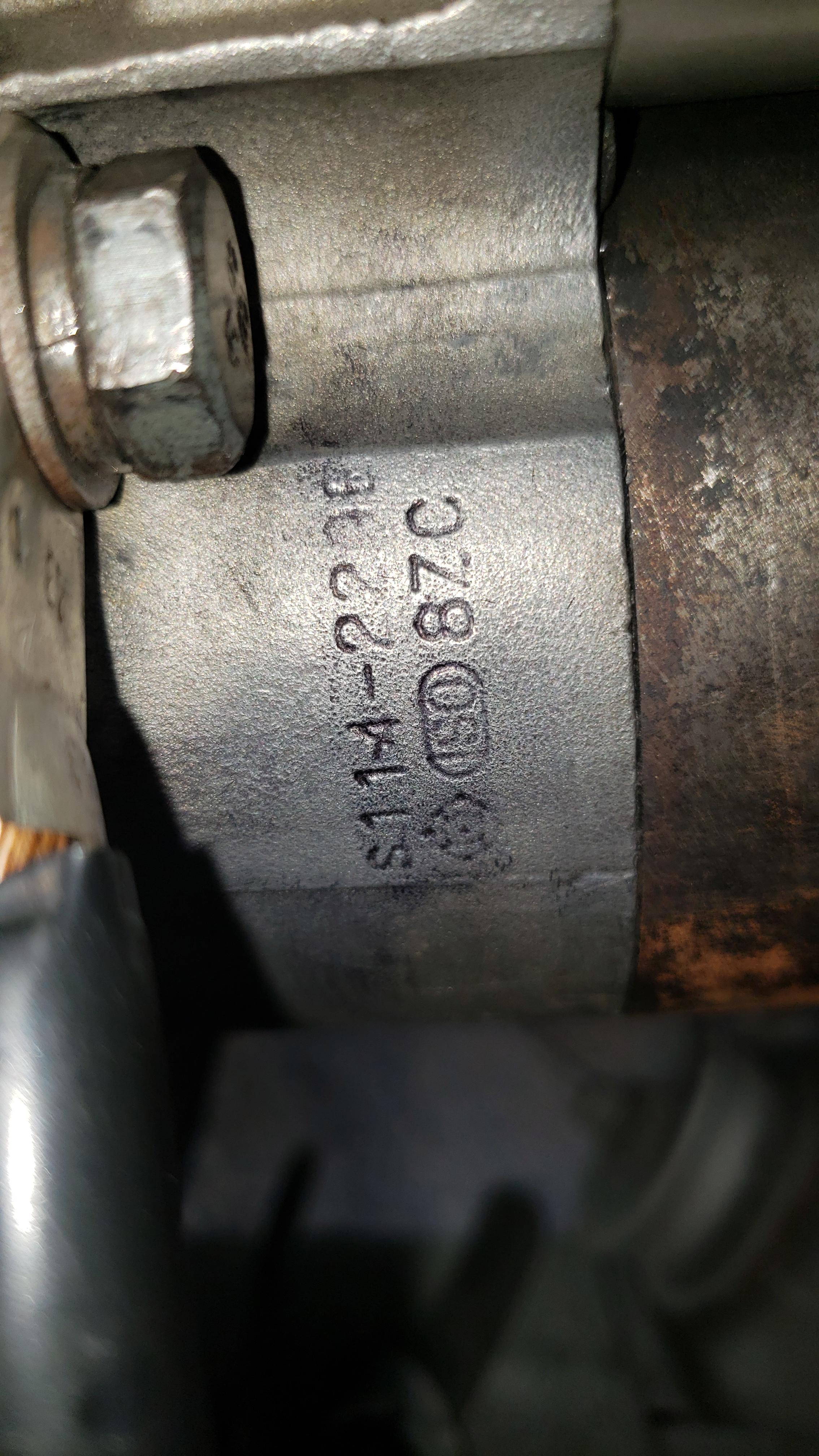

Ok guide me with the correct part number as replacement starter motor for my 1972 240z with a 5 speed 280z manual transmission. Im posting the picture of the stamped Hitachi code as reference. Apparently here in Panama no one seems to figure out the correct part number.

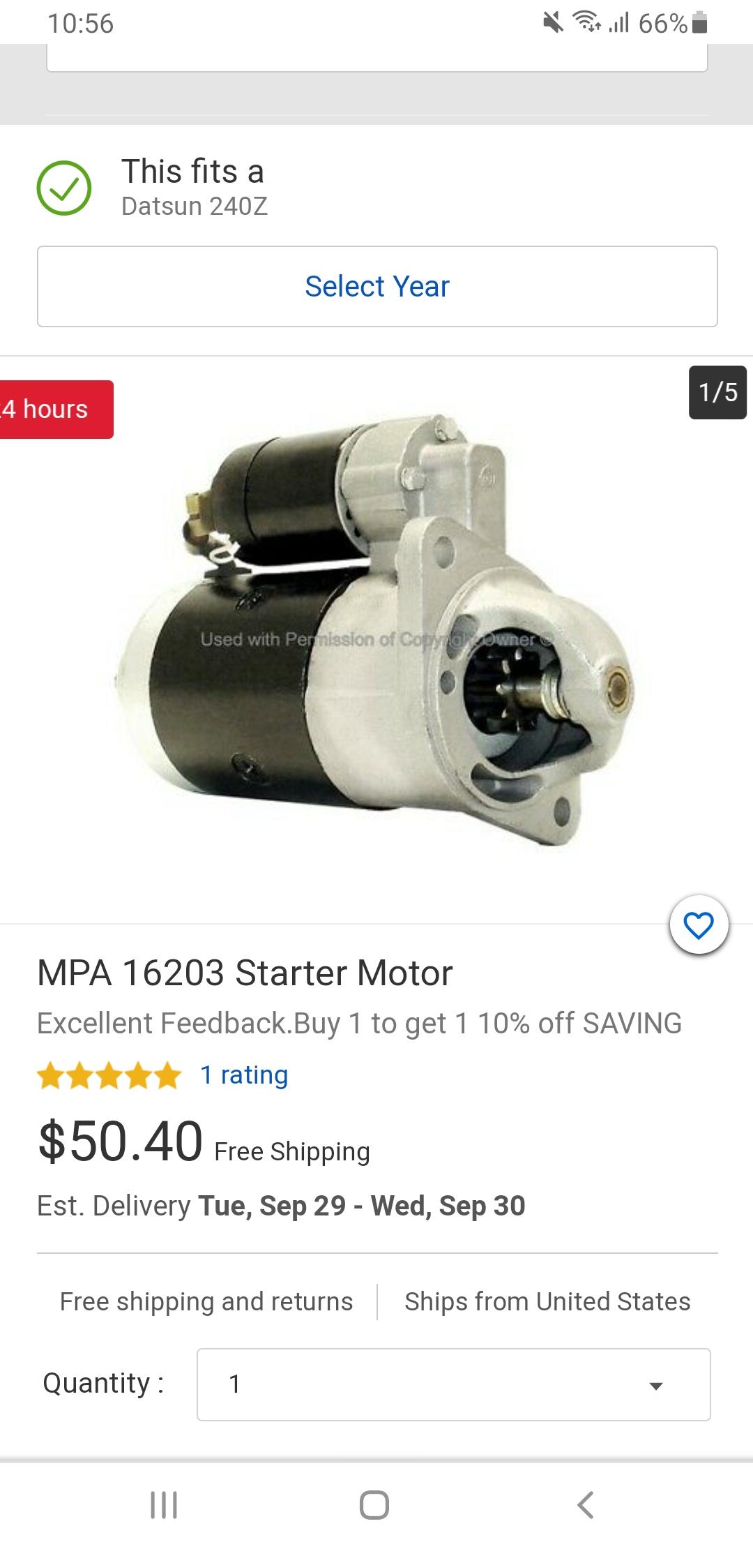

Another thing, which brand is more reliable? AC Delco, Remy, Mpa? Will 16203 work on a manual 5 speed transmission?

Doesn't the local source have other part numbers?  Shipping is going to cost you a lot if you buy from the internet.  Even if you buy directly from a manufacturer.
Many manufacturers have their own internet presence now.  You might not be able to order from their web site but you can get  feel for the company.  Like zKars link.  Or the links I showed in your other thread (always another thread...).
