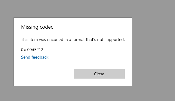

You should put your videos on youtube.  They won't play for many people.
