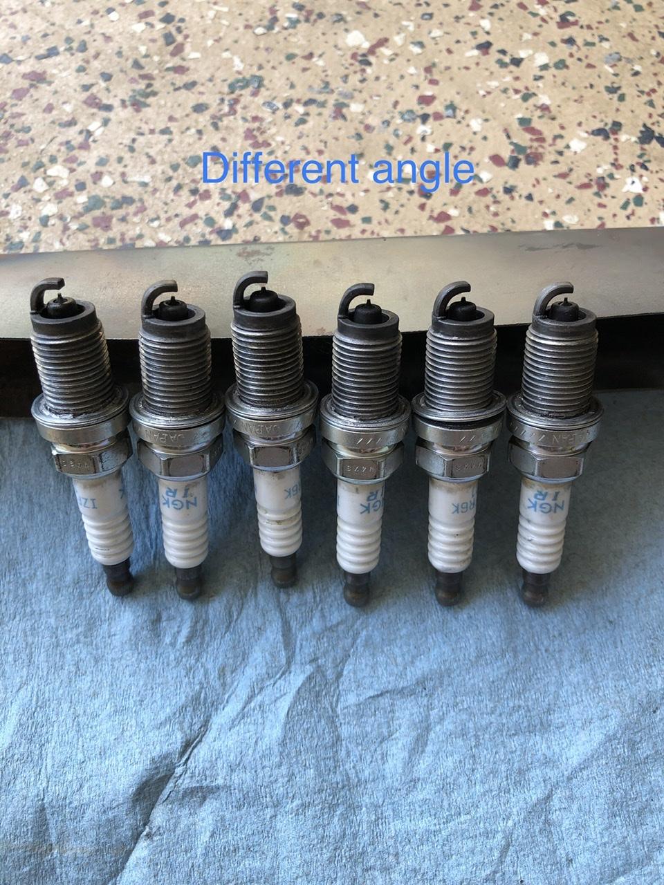

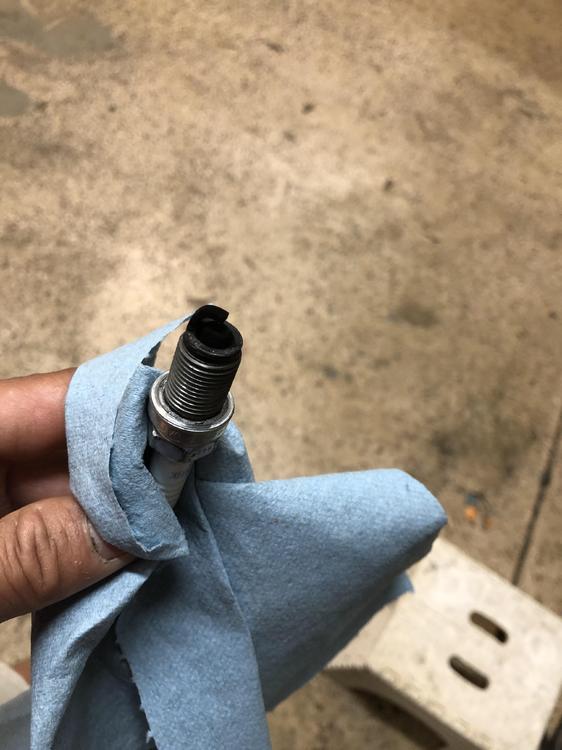

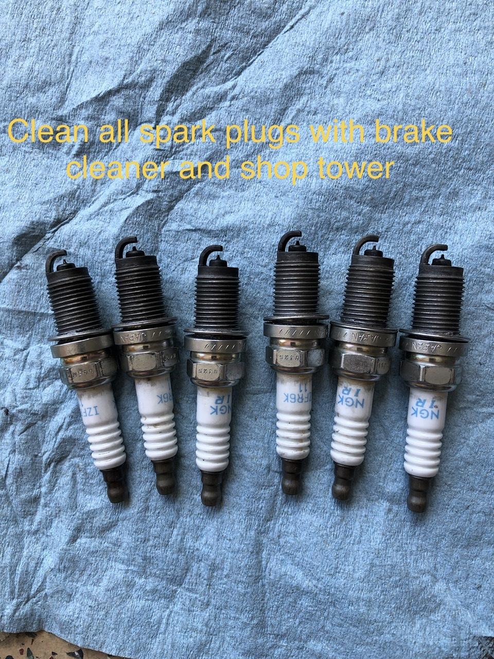

the engine idle, rev fine. Look at the spark plugs, 1,2,3 run rich and 4,5,6 run lean.
The spark plugs of 4,5,6 looked clean compare to dark smog 1,2,3.
1,2,3 engines look like this
4,5,6

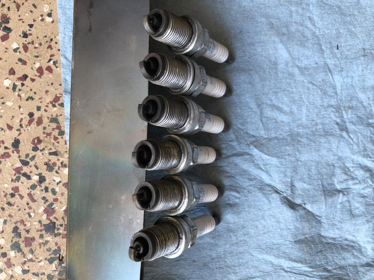

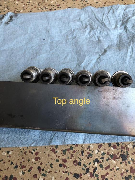

Maybe post pics of all plugs. Your idea of lean may not be lean to anyone else.
I can tell you now you will more than likely have difficulty with the smog test with plugs that look like that.
Make sure the plugs are gaped right, the right ones, etc. Again pics are a good thing.

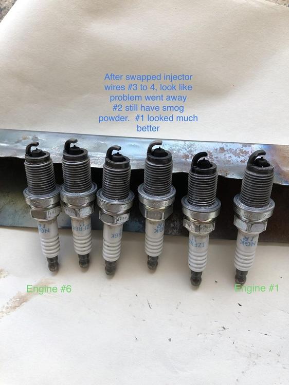

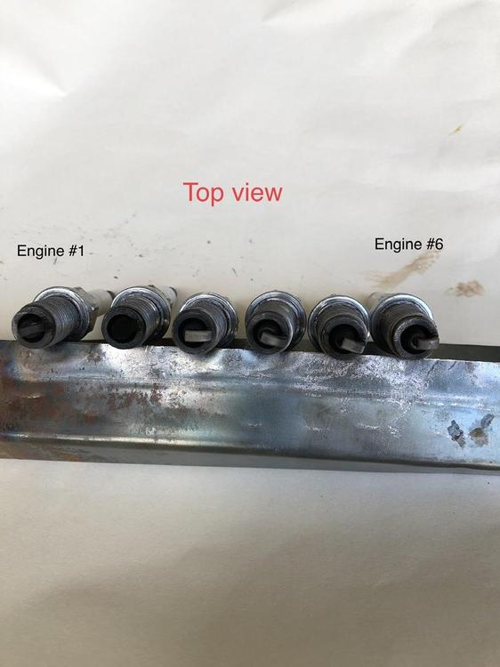

Hi all.  Seem like the problem is gone with swapping the #3 and 4
Isn’t the firing sequence 1,5,3,6,2,4
#3,4 is opposite isn’t it?
please see the photos with notes.
before swapped the wires of 3,4
after swapped the wires.
#1 look much better but number #2 still have smog powder on it.

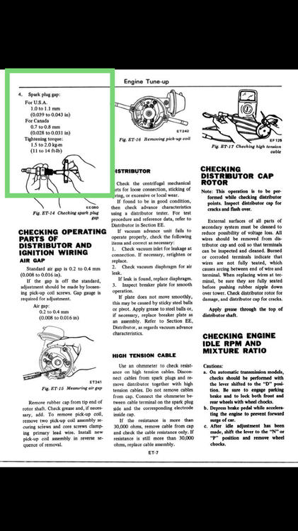

Edit - Left out some zeroes below.  .032", .043" is correct.
Those spark plugs are much dirtier than they should be.  Looks like your EFI system is running rich, which is a very common problem with the 280Z's.
Have you checked the gap on the spark plugs?  It looks too big.  1977 still has the weaker electronic ignition system, gapped at ~0.32".  If your engine has the ballast resistor then gap to 0.32".  I haven't found an FSM that I'm sure is actually 1977, so there might be specs showing 0.43" gap.  But I don't think that's right for a ballast resistor system.

I never give a second thought of checking/adjusting the spark plugs gap.  Installed it the way they are when I bought the spark plugs.   I just ran the engine for half and hour and wait till it cool down a bit to open.  Too hot in the garage ?
the FSM says 0.39-0.43 gap should be good.  The gap does look wide.
