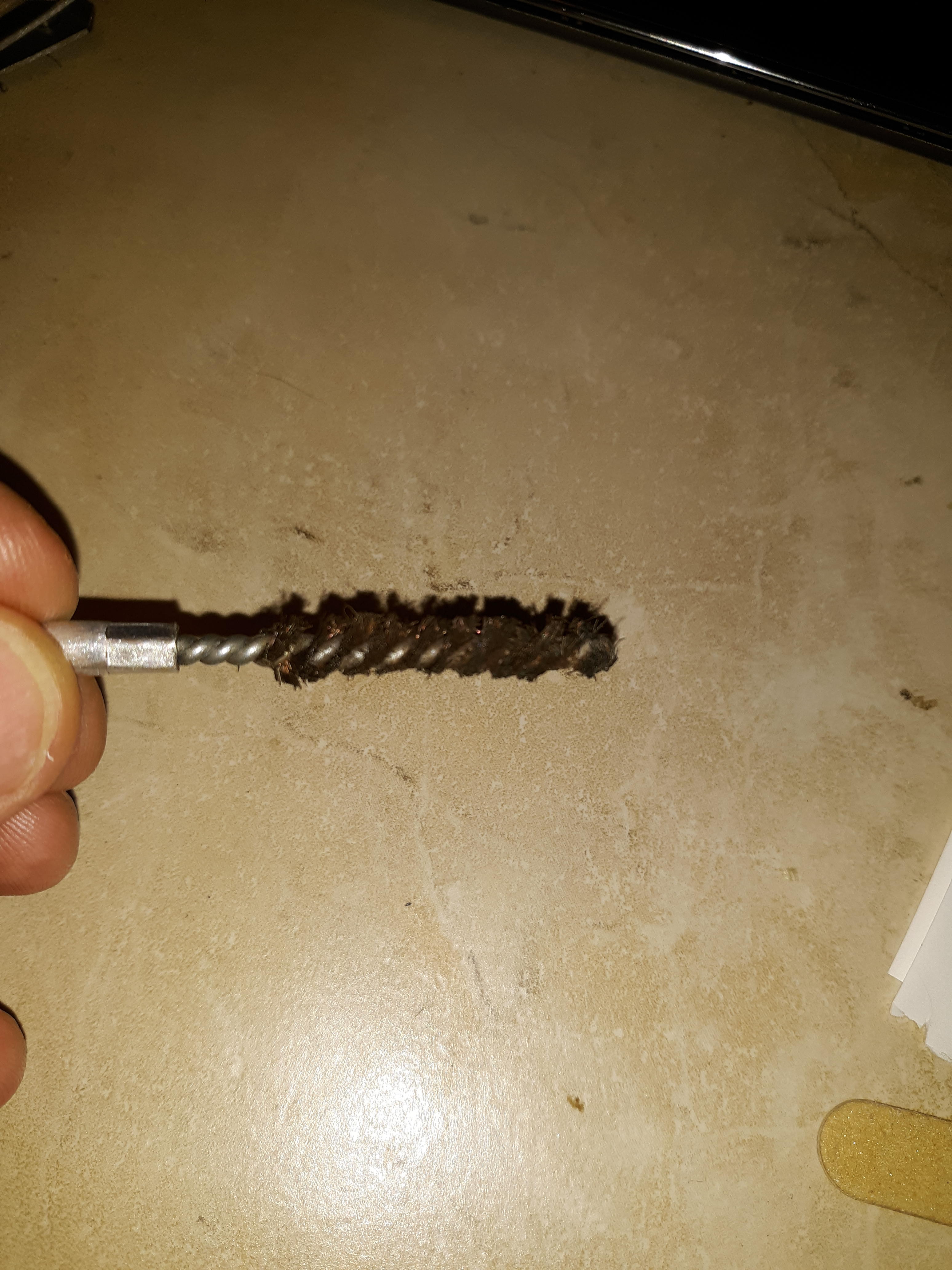

I used a .22 caliber wire barrel brush from my gun cleaning kit. 5/16" on my 280. Worked good for me but was nerve wracking the way I tied it with picture hanging twisted wire.
Maybe I wouldn't do it again on second thought. LOL

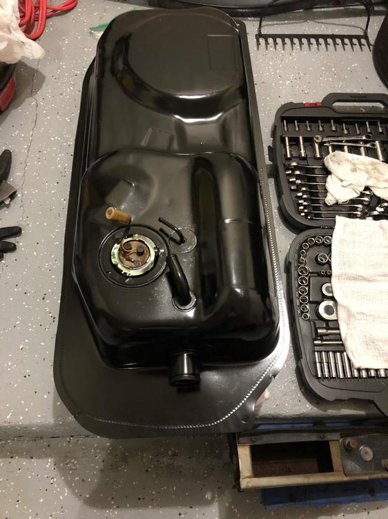

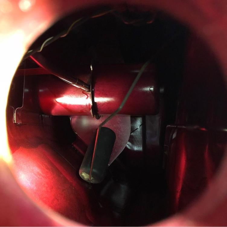

I went through this about a year ago. I was going to do it myself but I changed my mind and had it done professionally after meeting a guy who was doing it himself.and I’m glad I did. This guy put BB’s in the tank to break up the rust and could never get them all out: he has to cut the tank open to get them out and used that hole to put the POR in. It looked like a mess and environmental disaster. I took it to a shop that did work on Big rigs in Memphis. They had a hot tank and did an acid bath and then treated the inside with a red coating. He said it would last longer than anything on the market. The tank came looking brand new inside and out. Total cost was $320. Pricey but I wanted it done right and put it behind me. Wish I took before pics to show you how good of a job they did.
