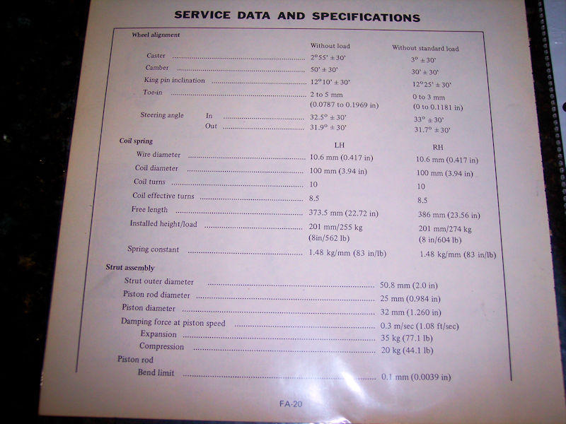

Spring rate metric to SAE conversion units are inverted. Kg/mm to in/lb rather than lb/in. Numeric part is right, 1.48 kg/mm is 83 lb/in

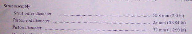

Close but no cigar.
