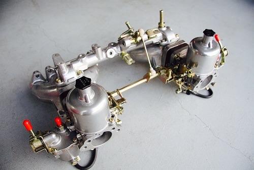

I would definitely go with the SU’s. They are so simple and absolutely no problem feeding your set up. Get Ztherapy to build a set for you. They do a great job on my 3.1 Stroker Motors.

If the SUs are getting their proper fuel you can't beat them. I finally got mine right and cannot make them stumble for anything. Believe me I've tried. LOL
I have a very similar engine to yours but with shaved E88 head. SUs are producing a measured 232bhp at 6200 rpm and the tuner said he thinks it would be over 240 if he had taken it to 6800 but backed off as he is used to dealing with British Layland cars ;) also it was going a little lean.
While getting lean at the top, it had no trouble breathing. The right needles will sort that out. I’m still in the process of finding the ideal needles as the tuner was modifying my SM needles while we were unaware of several air leaks behind the carbs. ZTherapy thought that my engine should be fine on SM, so that tells you something also about SU carbs. I think either lightly modified SM or unmodified MC would be correct for my car but I have yet to find the time to fine tune.
ZTherapy run their SCCA car revving to 8K rpm on stock sized SUs with modified needles and producing big numbers.
The beauty of SU carbs is low and mid range throttle response and power for the 70% rest of the time you’re not WOT. Also a piece of cake to set up.

SUs will work nicely, and if you decide you really want EFI instead, you can convert the SUs into throttle bodies with a kit from Patton Machine. http://www.pattonmachine.com
Thanks for all the great input.  Didn't realize the SUs would be enough.  Think I will go with them for now since they are in great condition. As far as the future, who knows.  Thanks again.
