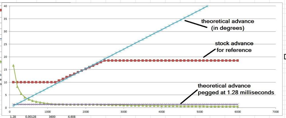

And just because everyone likes pictures... Here's what the timing would look like if you just hard peg the advance at 1.28 milliseconds BTDC. I tried to model the extended curve using the stock slope as a guideline and that's what I came up with. Mechanical only (no vacuum):

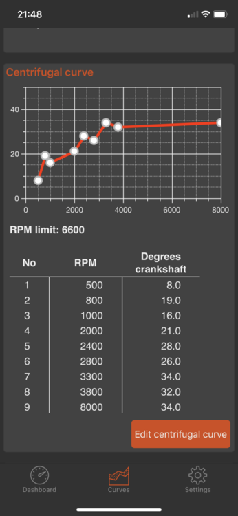

@AK260, you had posted a pic earlier showing the timing you're using with your 123 device...
The button at the bottom right of the screen "Edit centrifugal curve" indicates that this is what you're running for your mechanical advance. Is that correct? That pic looks much closer to what I posted above than the original stock configuration.

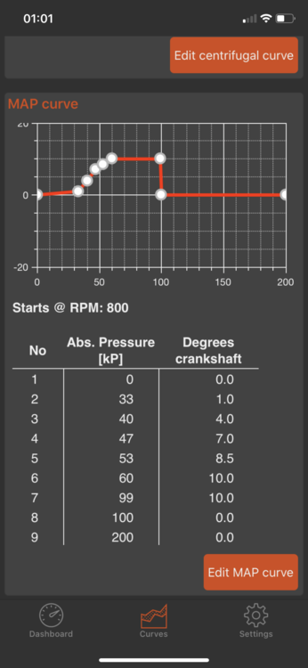

Is this just mechanical, or is this mechanical plus vacuum? :
c94d1edfbd784d14af395edbc9b9a7ef.png&key
So Captain, this is purely my mechanical advance. I have zero base advance, which does mean I have to crank the car a bit when cold but at least it’s WISIWYG and I won’t do something dumb + cranking the extra 5 - 10 secs helps to oil get round before the action starts.
The vac curve is a work in progress at the moment.
