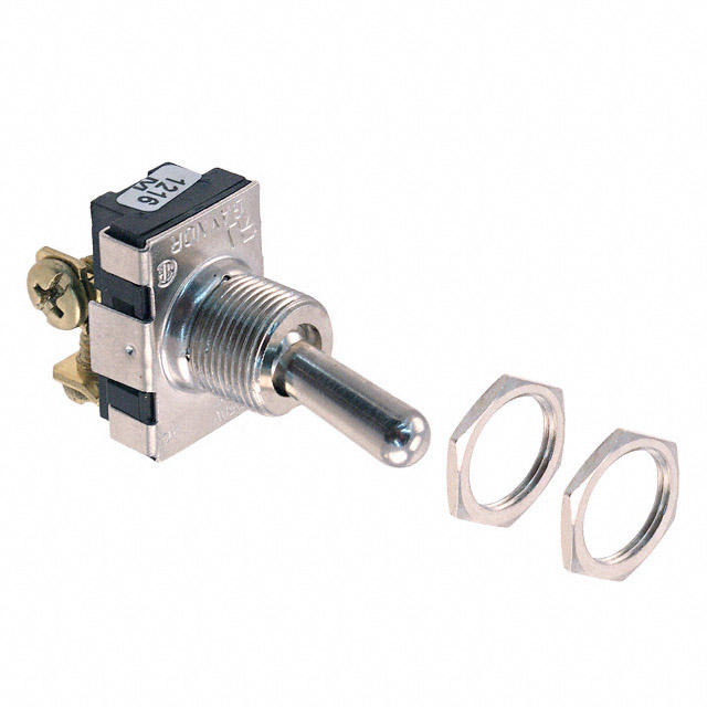

jfa.series1 Posted March 6, 2020 Author Share #25 Posted March 6, 2020 Thanks again to @SteveJ for the link to DigiKey. Going thru their catalog I located this switch that has dimensions very close to OE. I've got 5 on order, will update this thread with fitment results when they arrive. https://www.digikey.com/product-detail/en/electroswitch/7105B/451-1156-ND/2679539 1 Link to comment Share on other sites More sharing options...

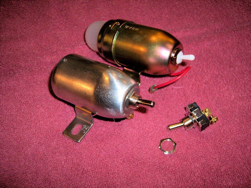

jfa.series1 Posted March 10, 2020 Author Share #30 Posted March 10, 2020 I think we have a winner! Here is the new switch installed in a light body, pictured with a NOS unit for comparison. No interference inside when installing the switch. The bat (toggle) is larger and the bushing extends further out of the body. The exposed bushing length can be adjusted as there is a hex nut inside the body for that purpose and one outside to lock it in place. I plan to have the hex nuts yellow zinc plated and will paint one of the switches to more closely resemble OE. Stay tuned to this station for continuing updates. 4 Link to comment Share on other sites More sharing options...

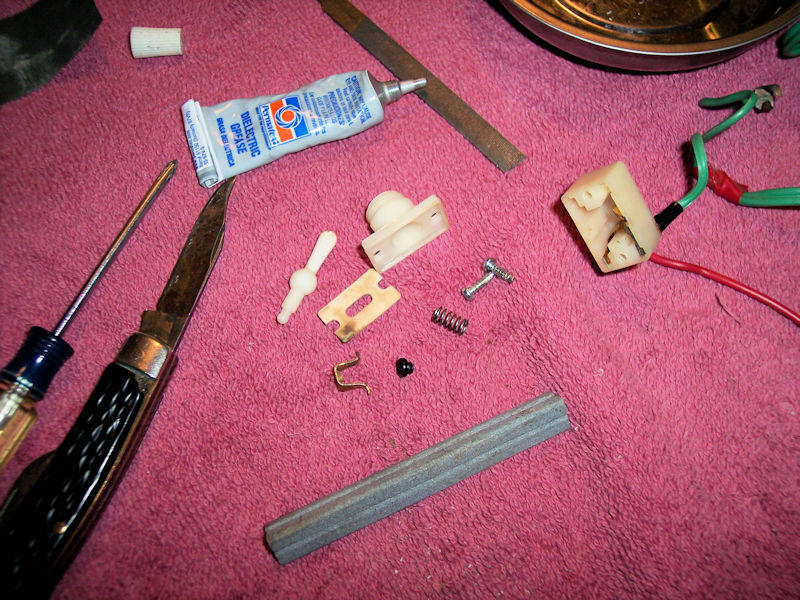

jfa.series1 Posted March 14, 2020 Author Share #31 Posted March 14, 2020 Today's mind-numbing exercise: servicing 18 switches with disassembly, cleaning, burnishing the contacts, dielectric grease, assembly. About 3 hours for 18 units. Two others in the batch have broken toggles and will get the new metal toggle replacement switches. 3 Link to comment Share on other sites More sharing options...
