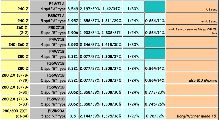

Do you think this is a good deal?  How would you choose which one to grab? Lowest miles?  Year?  How do I know which year is best for street use?  I know there was a open and closed ration....not sure exactly what that means but word is closed is the one people recommend on the inter web,  How do I know before pulling it that it’s the right one.?   Are they hard to rebuild if required?

The ZX had a couple of different ratios, early 79 is the same as late 280Z one, there is an odd one in the middle for a short time, and then the later 80-83 is what most folks like. I think they are paired with 3:90 diff's. I run a 3:70 from a Maxima, seems to work well for my driving.

I run the 3.54 diff and the late model .745 transmission. Its a little tall, 80mph at 3k so if you have a lot of hills you may find yourself shifting into 4th now and then. Here it flatlandsville I generally get into 5th once I get over 65 (about2400 rpm) as long as I am not climbing. Its great for open highway 80mph. A 3.7 or 3.9 would let me use it more often around town but generally speaking with the torque of the engine being so good, it does not really matter much. I did not really notice the taller 1st gear, but again I have no hills to get stuck on in a start while inclined.
