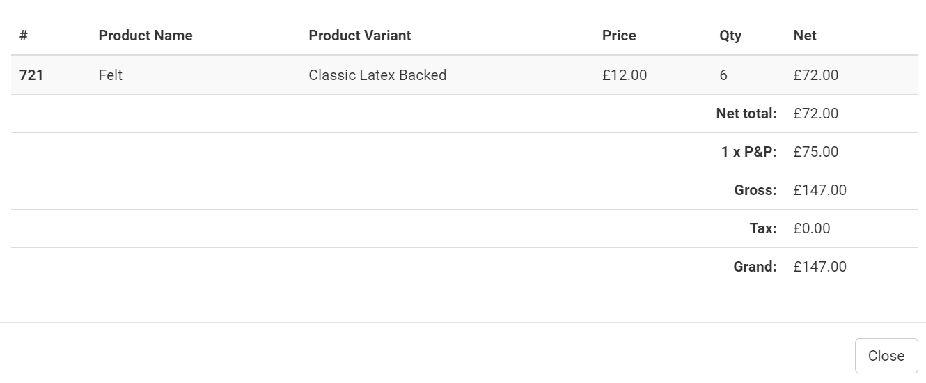

However, I was able to get it from martrim.co.uk.  Here is my order info:
That is about $186 given current exchange rates, and given how heavy and large it is, I would have figured just shipping would be that much!

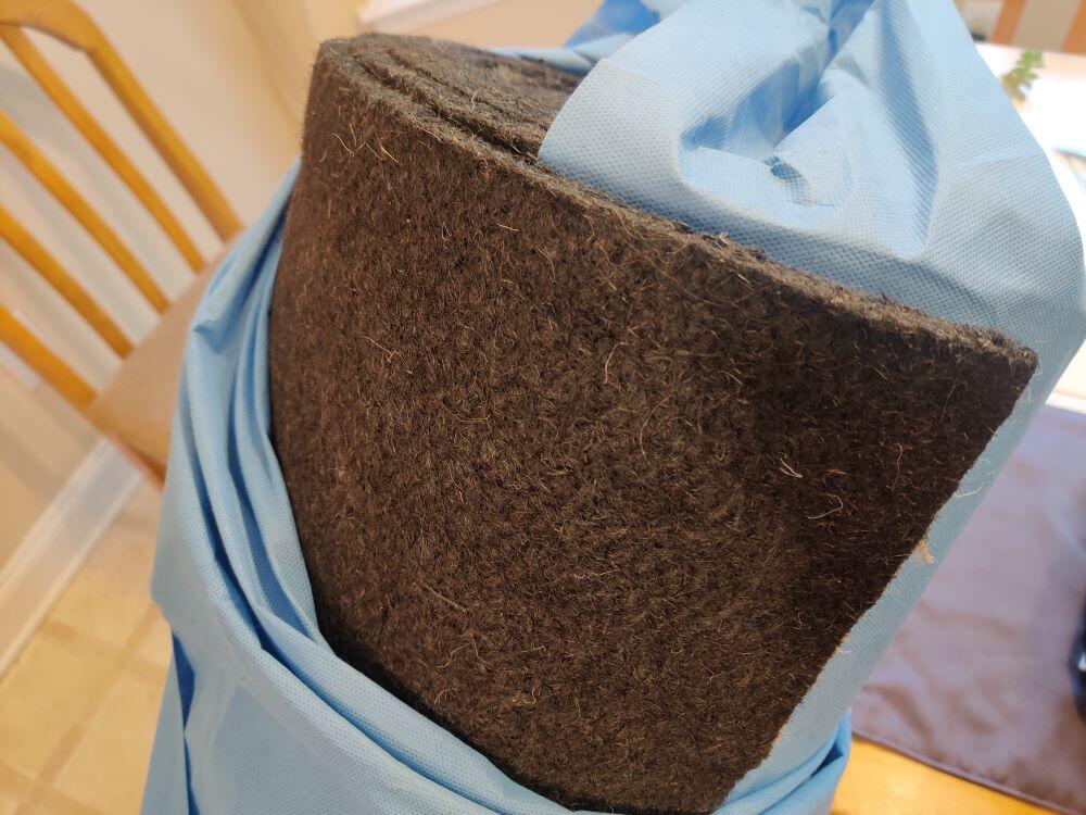

From the picture, it looks like it is dark colored throughout, however, it is only colored on one side and on the edges.  On the opposite side, it is tan.  But, it is the closest thing that I can find to the original jute after looking A LOT over the last few years.
Now, I need some accurate templates for cutting the jute to match the factory ones.

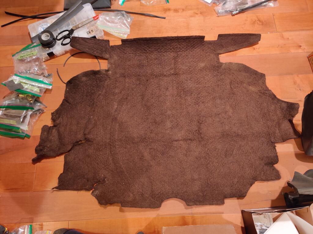

Pretty sure I still have my original just from the trans tunnel and under the seats that I used to cut mine. Trans tunnel was the only one that was really unique. I did buy one precut from zeddsaver, but I wasnt happy with it and ended up making one. I used the rear deck carpet as the guide to cut the jute. Let me know if you want any of it.
On 1/23/2024 at 9:49 PM, emccallum said:
Pretty sure I still have my original just from the trans tunnel and under the seats that I used to cut mine. Trans tunnel was the only one that was really unique. I did buy one precut from zeddsaver, but I wasn't happy with it and ended up making one. I used the rear deck carpet as the guide to cut the jute. Let me know if you want any of it.
I have a good trans tunnel jute to use as a pattern.  I do not have any front floor or under seat jute to use as a pattern.  I definitely have some interest in those.  I scored a nice piece of jute, along with what I believe to be an original rear hatch area carpet from eBay recently.  It is not perfect, but good enough to use as a pattern, I think.

That is in good shape, I'll bet there are a few restoration guys who would like to get their hands on that, don't throw it away.
I will take a look for these.  Thanks!
If you don't find templates let me know and I could make tracings of mine and snail mail them to you. The ones I have are OE from my 7/70 and are in surprisingly good shape. The only one that is not OE is for the right side front floor, so the one I have is traced from what was let of the original about 35+ years ago.
