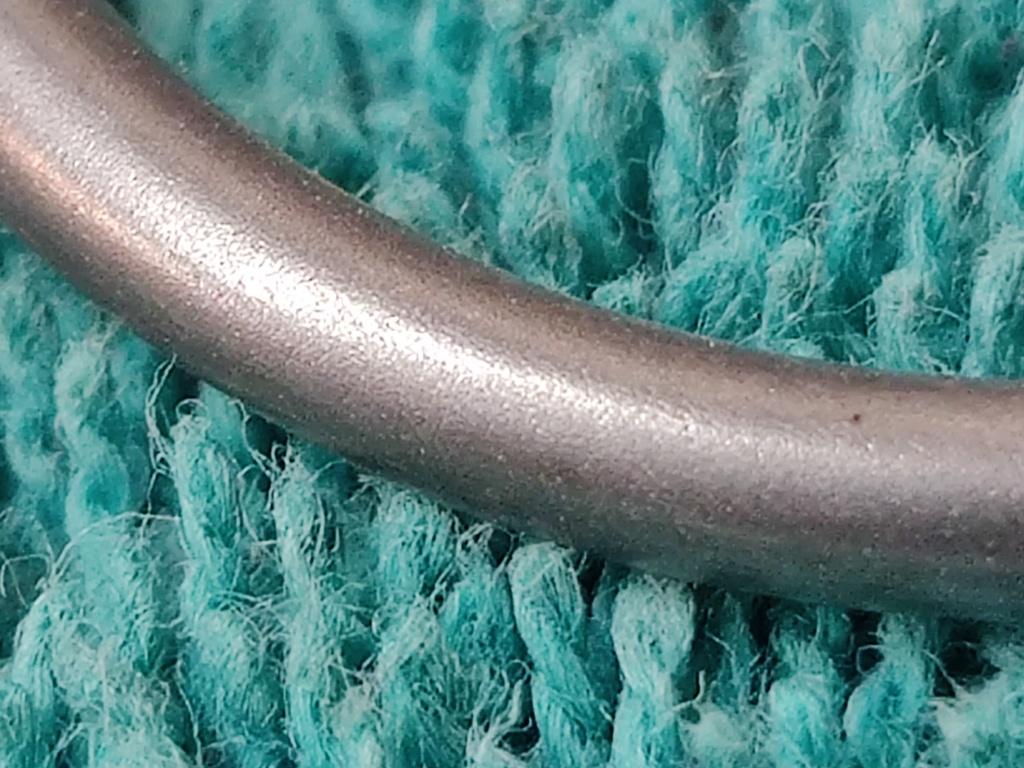

February 9, 20214 yr comment_615834 9 hours ago, inline6 said: Well, I have a couple of questions then. How do these look?  Depends on whether you want a finish that accurately depicts the finish of an original car or if you want show car bling. Other guys here could tell you more authoritatively than me but from what I have seen the way you have your parts now is pretty close to the way Nissan would have sent them to the platers. Some parts were shinier than others but I think that has more to do with the manufacturing process on a batch by batch basis. Personally I'm not going for that kind of originality, when I lift the hood I want to blind the person who is looking with SHINY so I guess I over finish them. 9 hours ago, inline6 said: Additionally, when using the dremel with stainless wire brush I am getting some of this (uneven polishing): That is another good thing about using a bench mounted wire wheel, the consistency of the finish is very uniform without that kind of patchiness. Link to comment https://www.classiczcars.com/forums/topic/63087-restoration-of-bringatrailer-240z-hls30-35883/?&page=18#findComment-615834 Share on other sites More sharing options...

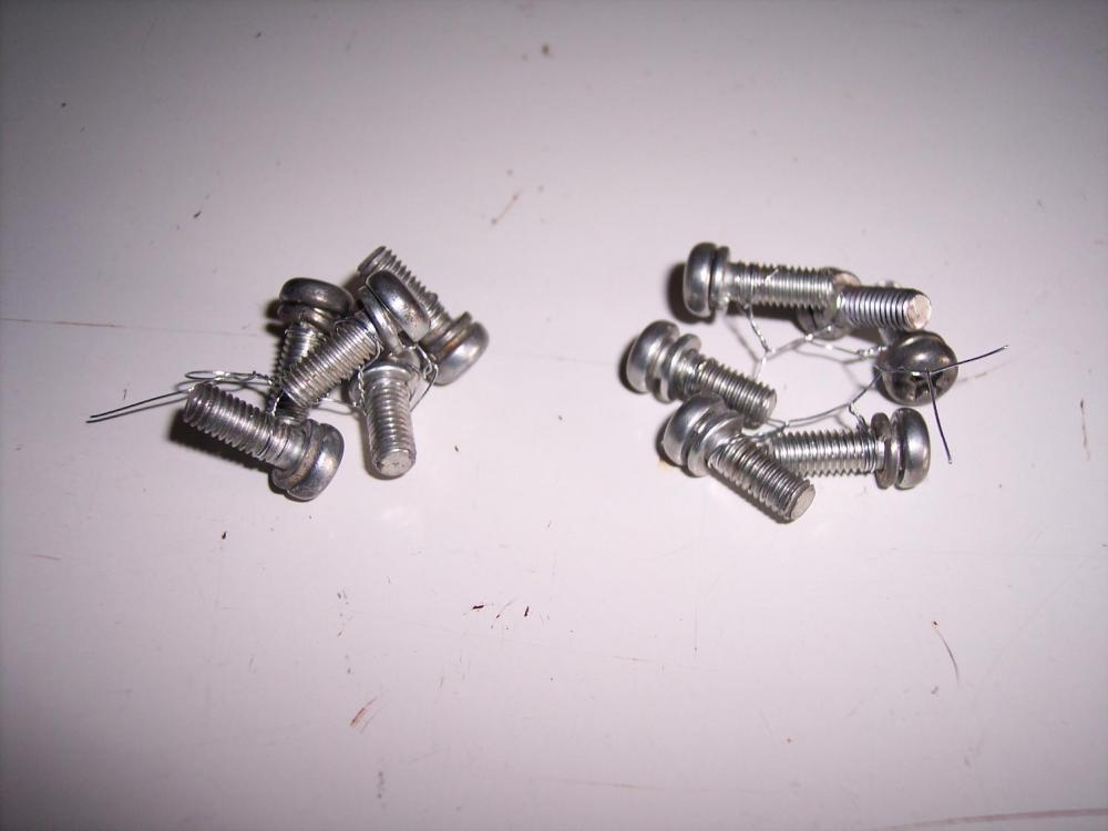

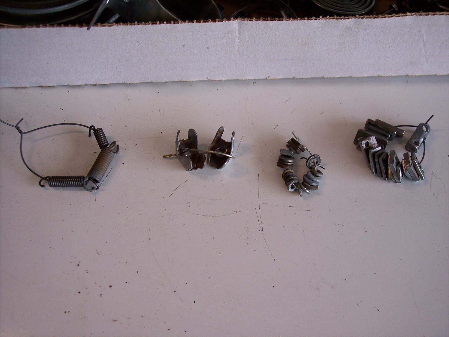

February 9, 20214 yr comment_615842 If you have not used a commercial plating service previously, be advised that tiny bits can/will get lost - it's just the nature of the process. You can help to avoid much (but not all) of that by tying small items together. I use soft wire for stringing springs, nuts, washers into a loop to cut down losses. For small screws I use a thin SS wire and wrap it a few times around the threads, then give it a few twists to lock it, then daisy-chain the next one and so on. This approach is not perfect but far better than leaving everything loose. Link to comment https://www.classiczcars.com/forums/topic/63087-restoration-of-bringatrailer-240z-hls30-35883/?&page=18#findComment-615842 Share on other sites More sharing options...

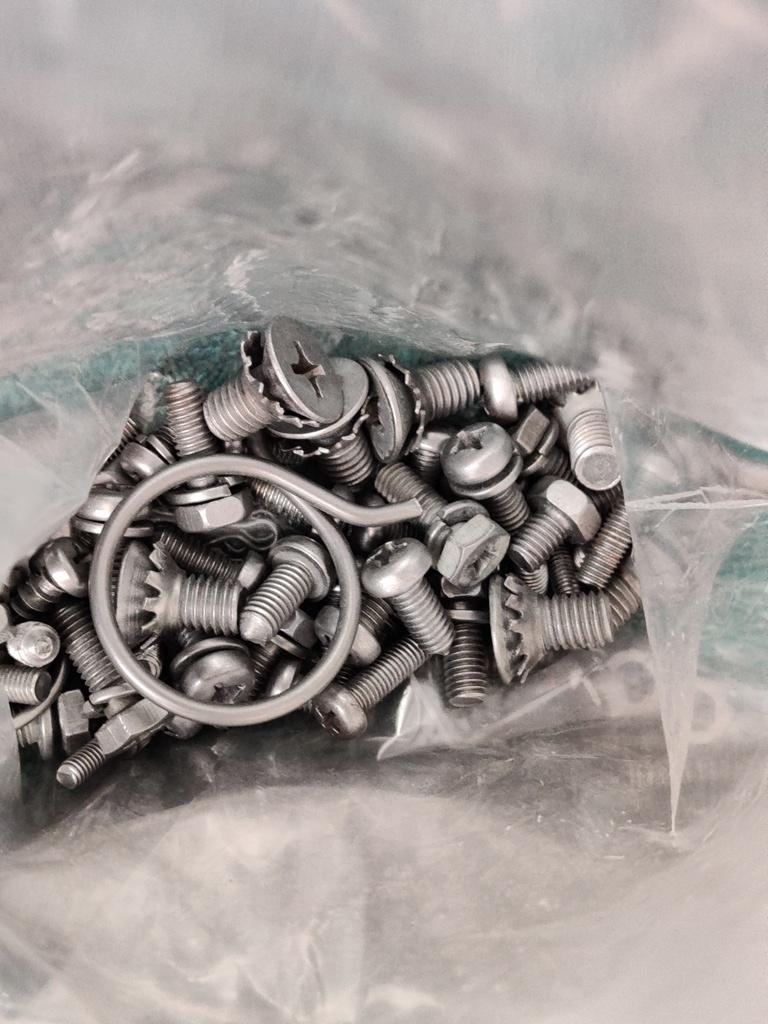

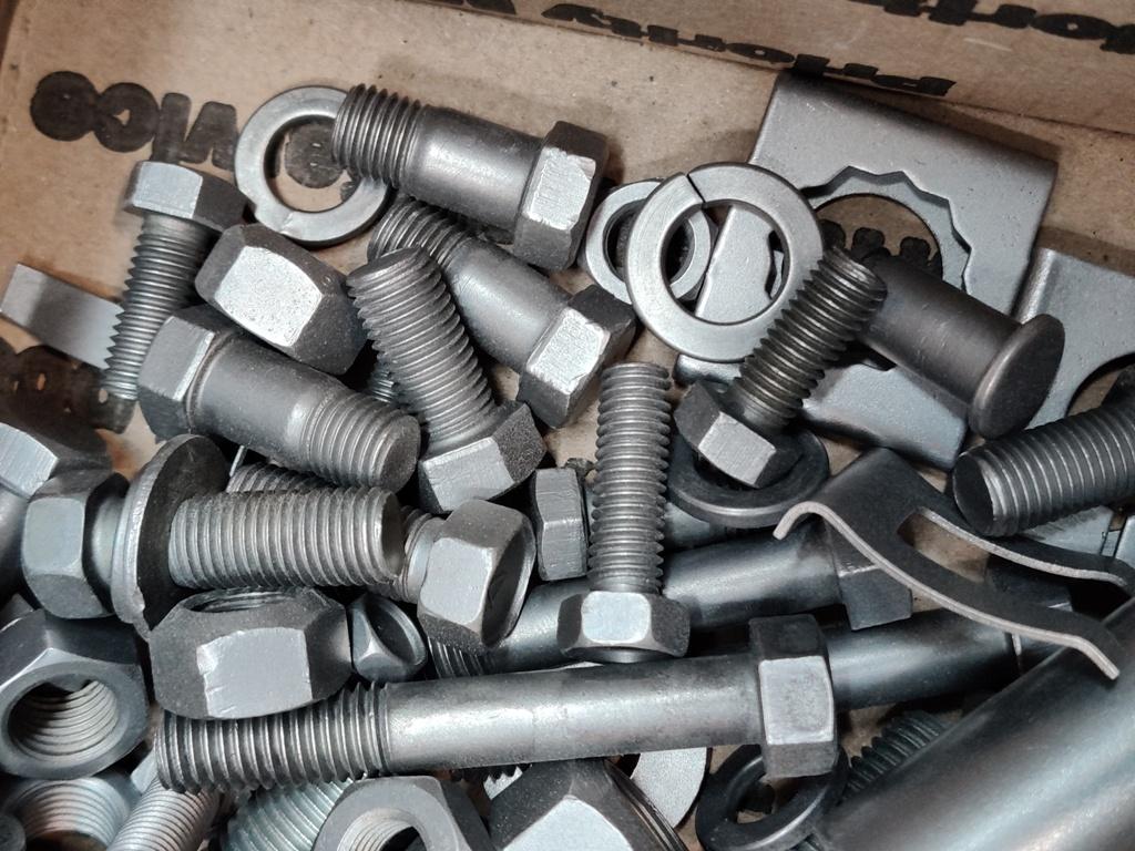

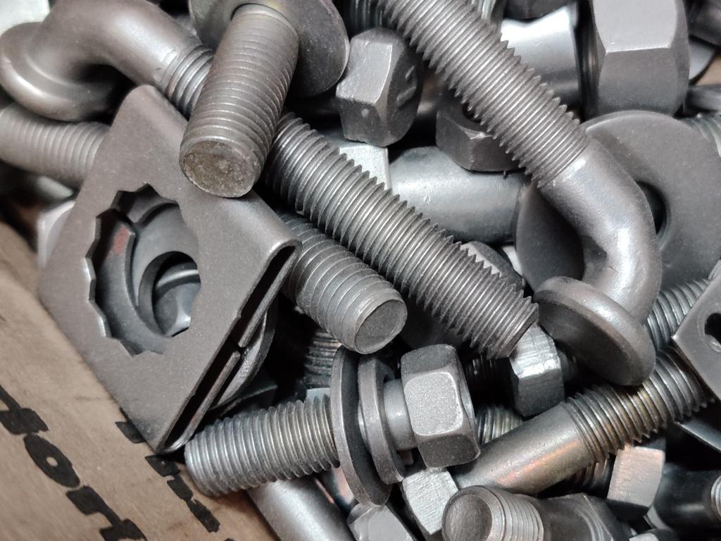

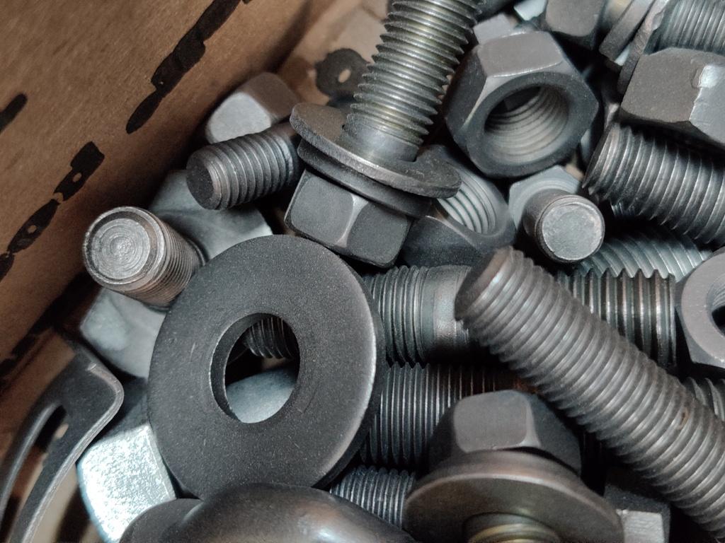

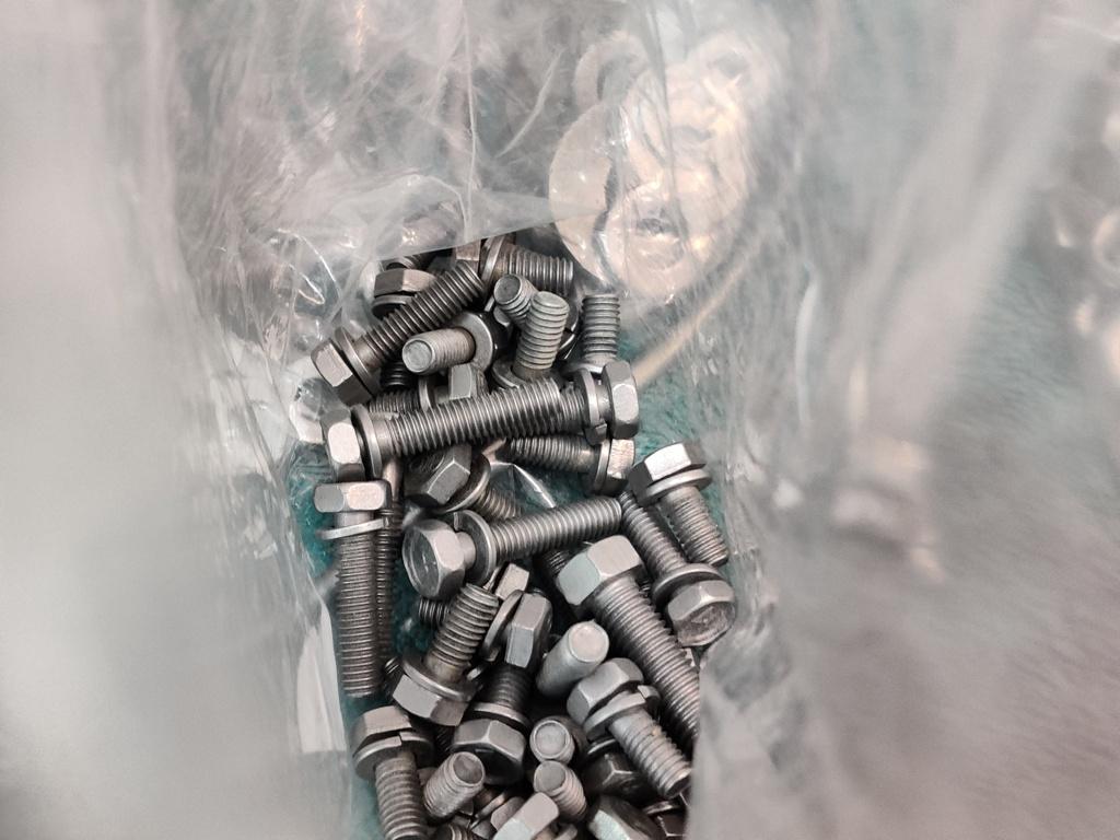

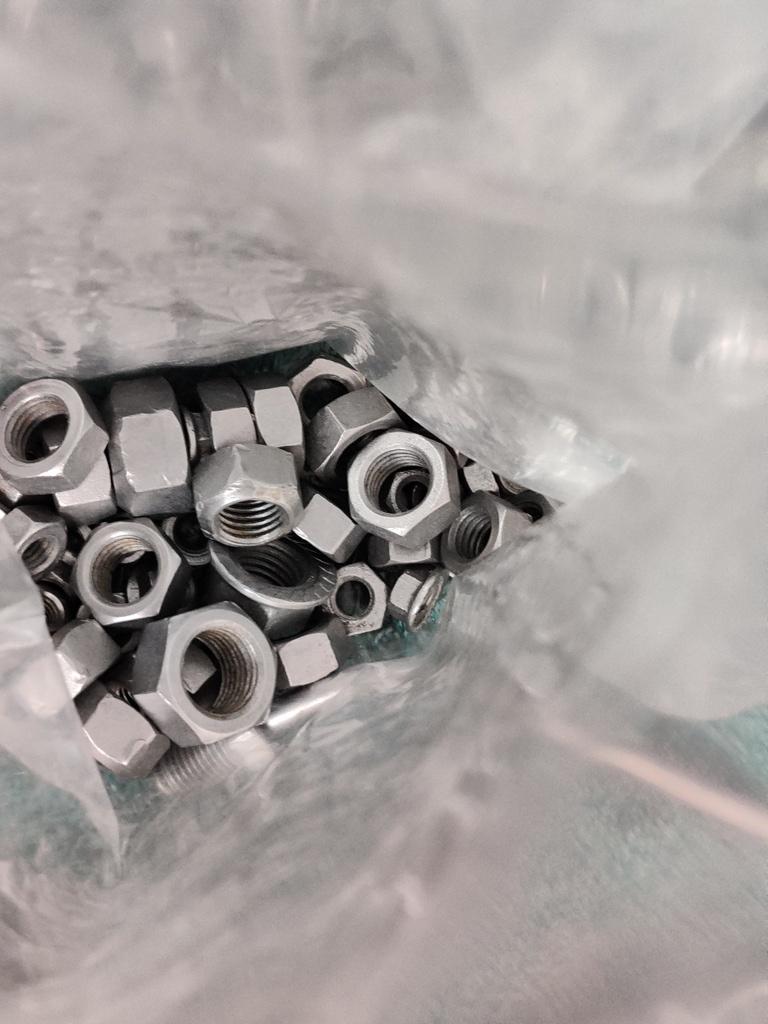

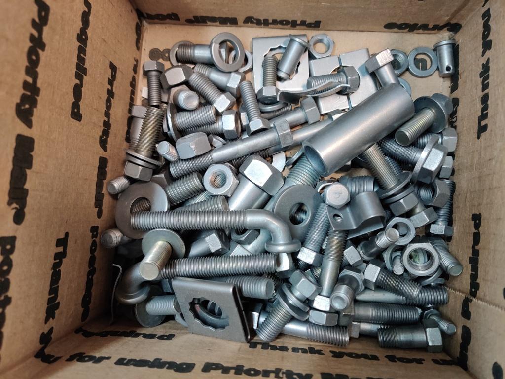

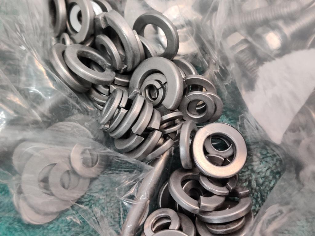

February 10, 20214 yr Author comment_615870 22 hours ago, Patcon said: Most platers will acid dip/pickle before plating and some like the plater motorman7 uses also have a blasting process they use ( I believe). You don't really need to get all the zinc off but it can accumulate on threads and things and make tolerances tight. If it's not all gone, new zinc lays right down over the old zinc if it's properly degreased  I see. So, full removal is not necessary. Interesting. I took some pics of the hardware that has only been glass bead blasted and run through the tumbler for 2 hours:           This is maybe half of the fasteners. Doing them with a wire wheel by hand would be a lot more time. And holding them would be crazy difficult as so many of them are small. I am hopeful I don't have to resort to wire brushing all of these.  I have one more treatment in mind to try out in the tumbler. I bought some corn cobb media and have some "semi chrome" metal polish. When I get all of the fasteners through the beading and stainless bit tumbling, I will try a batch in the corn cobb and metal polish. Theory is that the corn cobb will pick up the polish and act like little polishing rags. Will just have to try it out. However, I may not need to prep the fasteners further to get close to the factory finish? It is hard to say without some first hand experience, I guess. Another NOS item I had laying around (pics of original relay first):   New Old Stock Relay:        Edited February 11, 20214 yr by inline6 Link to comment https://www.classiczcars.com/forums/topic/63087-restoration-of-bringatrailer-240z-hls30-35883/?&page=18#findComment-615870 Share on other sites More sharing options...

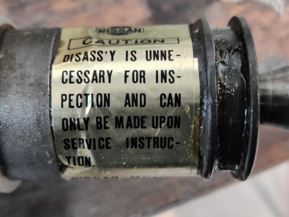

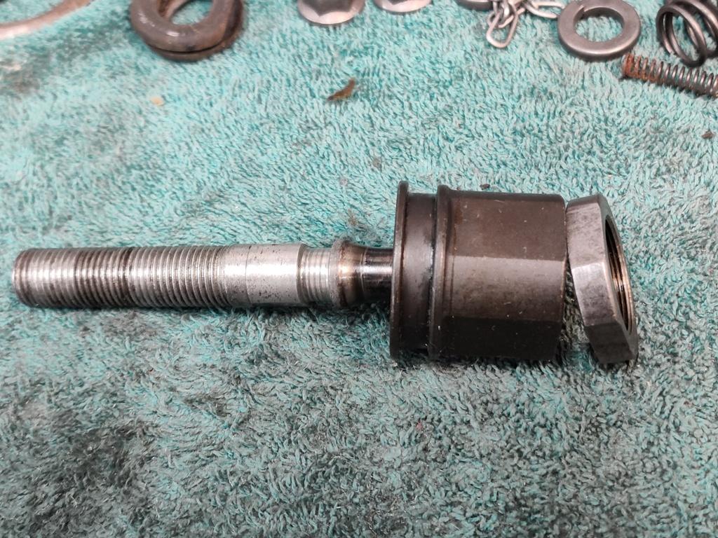

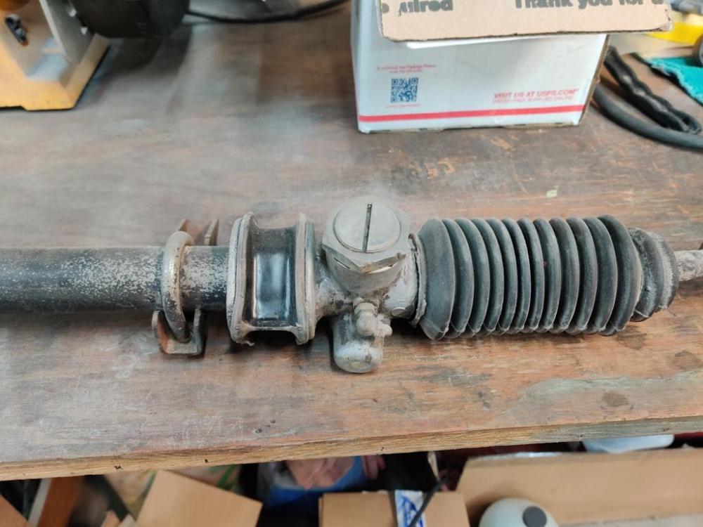

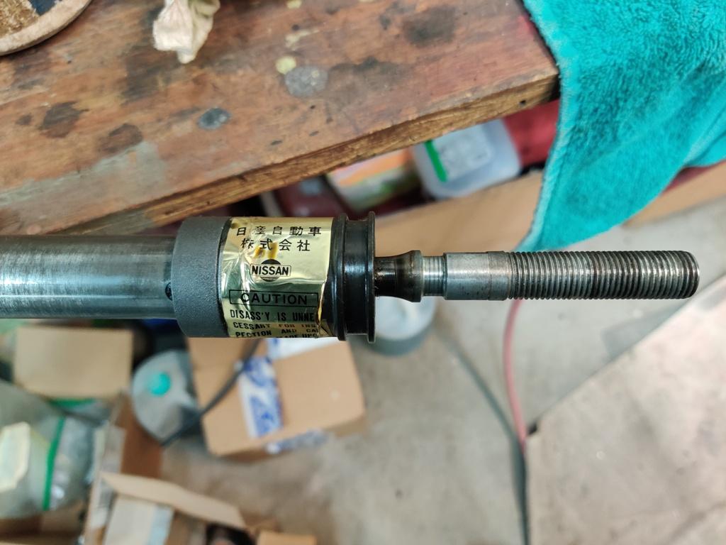

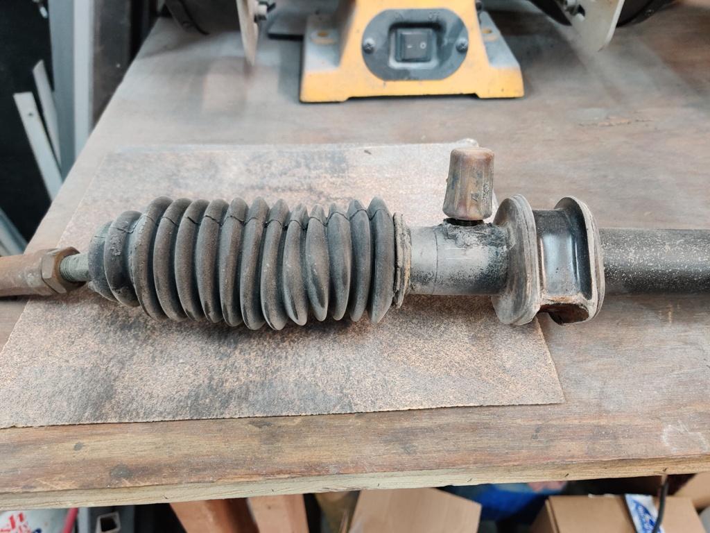

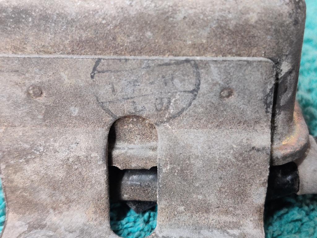

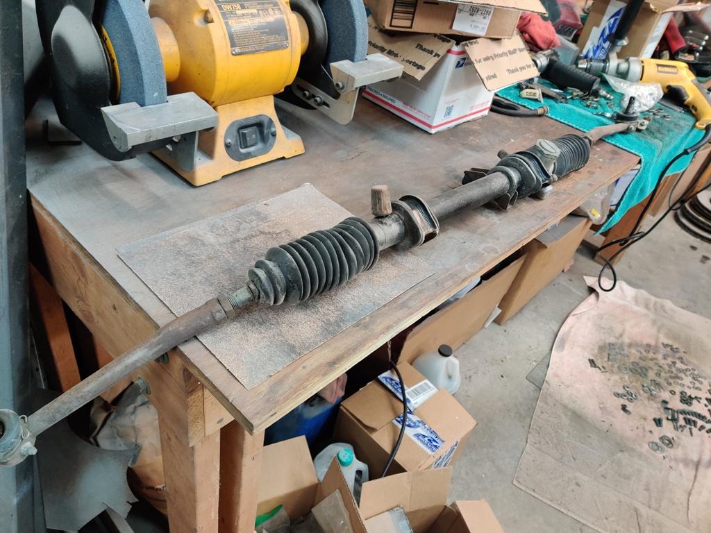

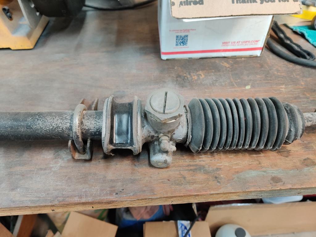

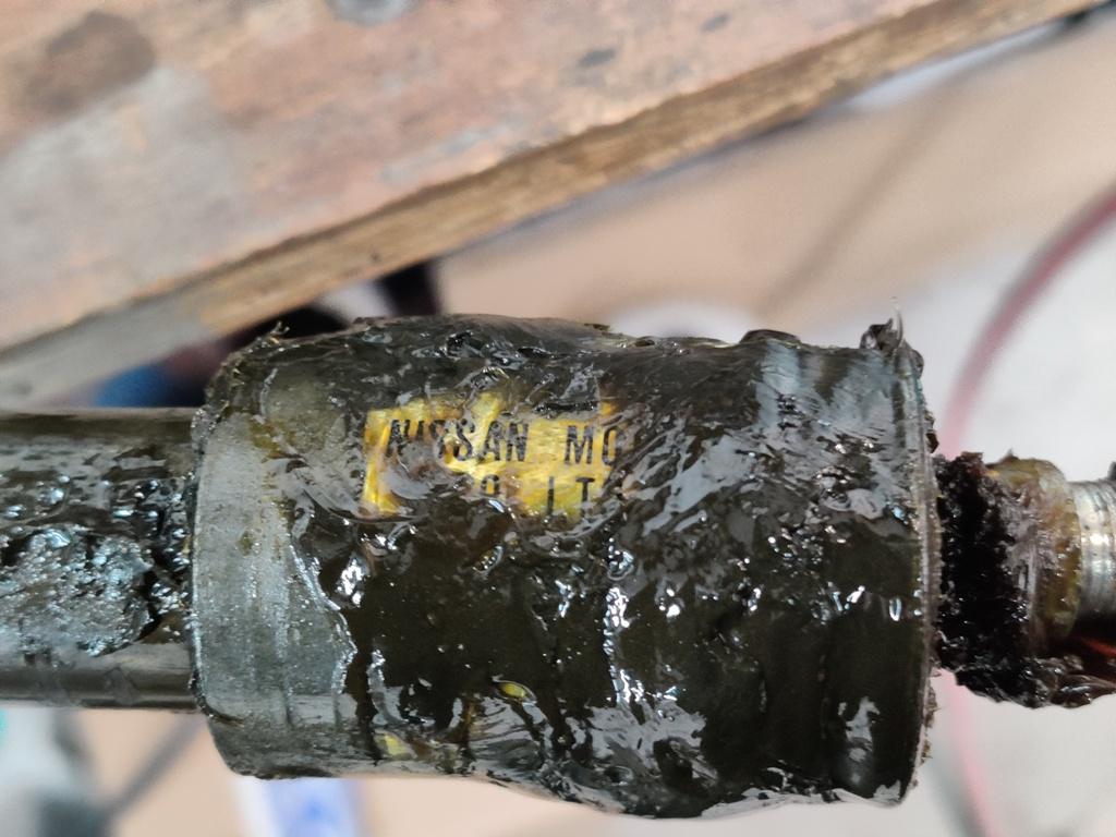

February 15, 20214 yr Author comment_616156 The steering rack was the target of attention today. New, aftermarket outer tie rods will be replaced with NOS original ones that I have. Boots were available new from Nissan, so these are getting replaced:     When I removed the boots, I was surprised to see this: I have never seen these labels before...   The inner tie rods are in great shape. I was able to lift the rack off the work bench by apply lifting force to the end of the threaded ends (both sides). I thought, maybe these were replaced by the prior owner, but I don't know. After taking them apart and examining the wear surfaces, I'd say they are not new. That is another thing that is very odd - I've never seen inner tie rod ends on a 240z where the socket and nut were not welded together. These are not, so I was able to remove them, clean everything meticulously, an examine the surfaces of the ball and socket. So much for the gold stickers... And, what were they trying to say anyway?!  Garrett Edited February 15, 20214 yr by inline6 Link to comment https://www.classiczcars.com/forums/topic/63087-restoration-of-bringatrailer-240z-hls30-35883/?&page=18#findComment-616156 Share on other sites More sharing options...
