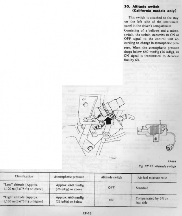

Air pressure at 14,000 Ft. would be closer to 8.26 psi.   Still an L28E ruling at factory spec.'s shouldn't have any problem going up Mt Evans even at 60% power.  I've driven a stock 72 240Z up there.  Just thinking out loud - I know nothing about the F.I. on the 280Z.... but for some reason I'm thinking the ECU on the 280Z is an analog computer.
I'm wondering if that  Gold Canister that @chasincats pictured, with the Blue&Black wires - is a sort of altimeter - that outputs an analog signal of varying strength. So it is not a matter of sending  ON/OFF signal to the ECU - so much as sending an analog signal of the correct strength to the ECU - to adjust the air/fuel mixture for different altitudes. Like a fuel level sender in the tank, or a temperature gauge. Jumping the wires together - might send the opposite signal needed to the ECU and make things worse at higher altitudes.
Does the Factory Service Manual tell you how to test that Gold Canister, or give a signal strength that it should output at Sea Level ?

This excerpt from the FSM should explain it a little bit:

This except from the FSM should explain it a little bit:
Thanks- @chaseincats
I guess that confirms what I wrote;  “I know nothing about  the F.I. on the 280Z”.   LOL
Have to say - even in 1978, I’m surprised they sent the level at 3675ft. - given California is 282ft below sea level in one place and 14,000ft above in others. Perhaps its more an Emission Control thing for Calif.
