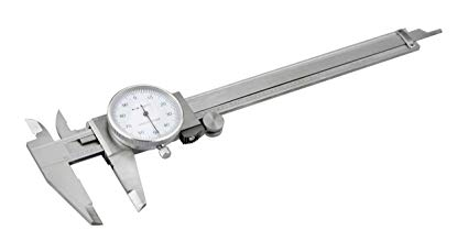

You need a decent set of these
Then measure one of the valve lobes across the bottom width. Not from the peak to the round end but from one side to the other. That should be the base circle measurement
Got it. Know I have those, just need to figure out where it put them in my garage... Thanks. Appreciate the help.
