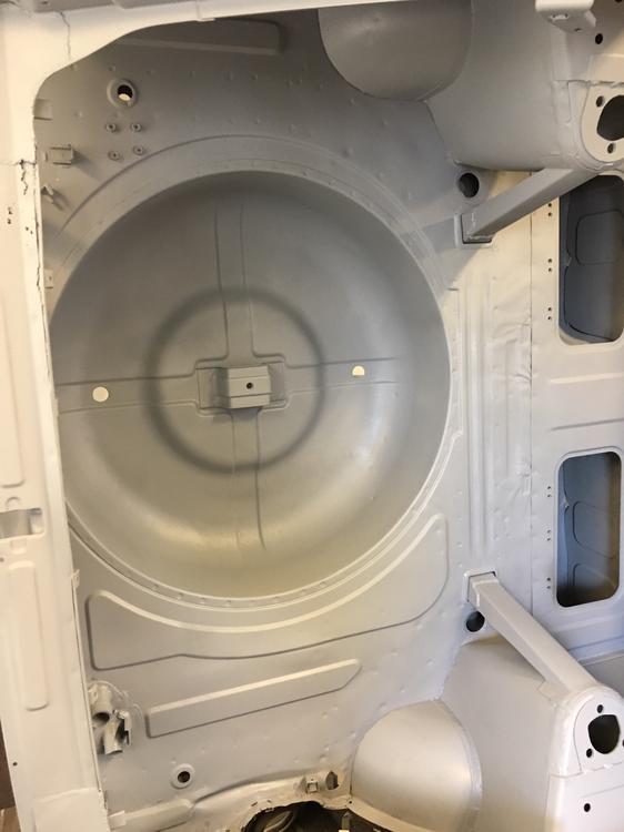

The story I heard (read it on the internet) is that they increased the fuel capacity in 77 and they stole the extra volume from the spare tire well. And since the spare well is shallower, they had to use that false wooden floor.
If you compare the floor sheet metal to earlier years, you'll also see the 77-78's have extra metal reinforcing "frame" members on the top side of the rear metal deck that didn't exist in earlier years.

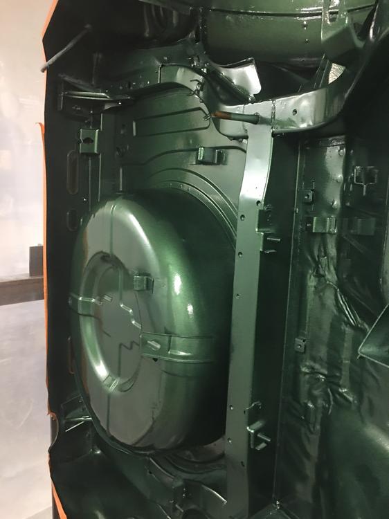

The "fuel capacity" thing is correct (a real surprise for web info). The parts manual clearly shows the difference in the spare tire indentation in the top of the two tanks.
I'm not sure about the "extra reinforcing" part, but the change prompted a vertical rise behind the seats and some bolt-on vertical risers (at the front of the spare well and a couple-four bent metal posts that also anchor the luggage straps) to support the new false floor.
Oh yeah, and the change occasioned the loss of 5 or 6 cu. ft. of usable storage in the back. I've been trolling around for a "skinny" emergency spare that would allow me to reclaim much of the lost volume above the carpet, not to mention the use of the now-buried cubbies behind the front bulkhead.

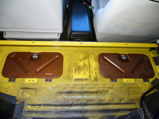

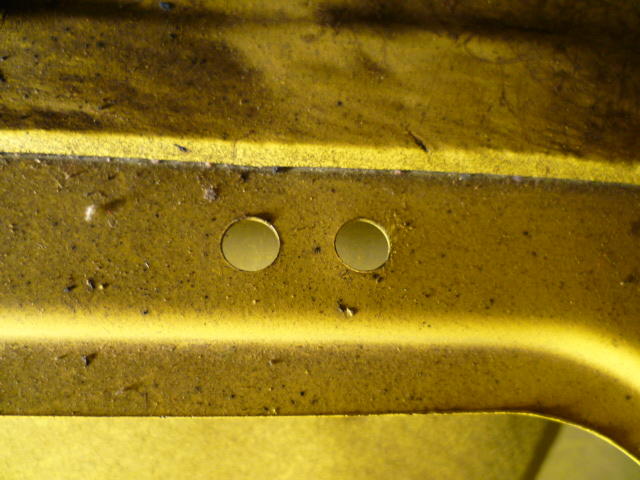

I don't know if I ever documented my storage bin mod. The basic story is that the bins are there on your car but there's no lids and there are no threaded inserts spot welded into place on the mounting holes. The holes are there, but no threads.

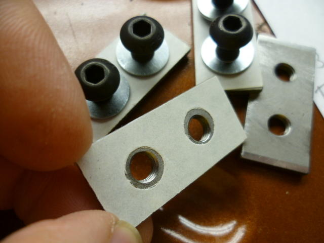

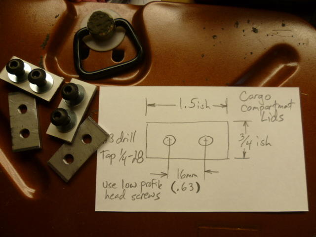

I took some steel plate, cut small rectangles, and drilled and tapped holes:
Some double back sticky tape to hold them in place until the screws are installed:
And I stuck them to the underside of the sheet metal where the cargo bin lids attach. This is without the threaded plates:
And this is with the threads in place. Double back sticky tape holding them in place:
Then get yourself a pair of lids from an earlier car and screw the lids in place:
