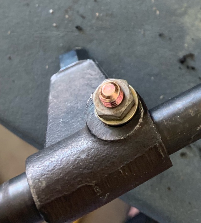

Everything looks good the rod is a little bent from all my hammering but nothing I can’t straighten. The little arm where the bolt goes through does have a little damage from the drill but it’s not on the rod side so I don’t think it will affect use. I have another bolt arriving Tuesday so I will know then. The slot on the rod where the bolt locks into is also fine
New pin arrived today in the mail it’s copper color unlike the one I took out that was silver but it fits perfect no play at all between the arm and the rod. I also was able to straighten out the rod pretty easily. Now I am just waiting on my o rings from courtesynissan to ship before I can put it together again.
