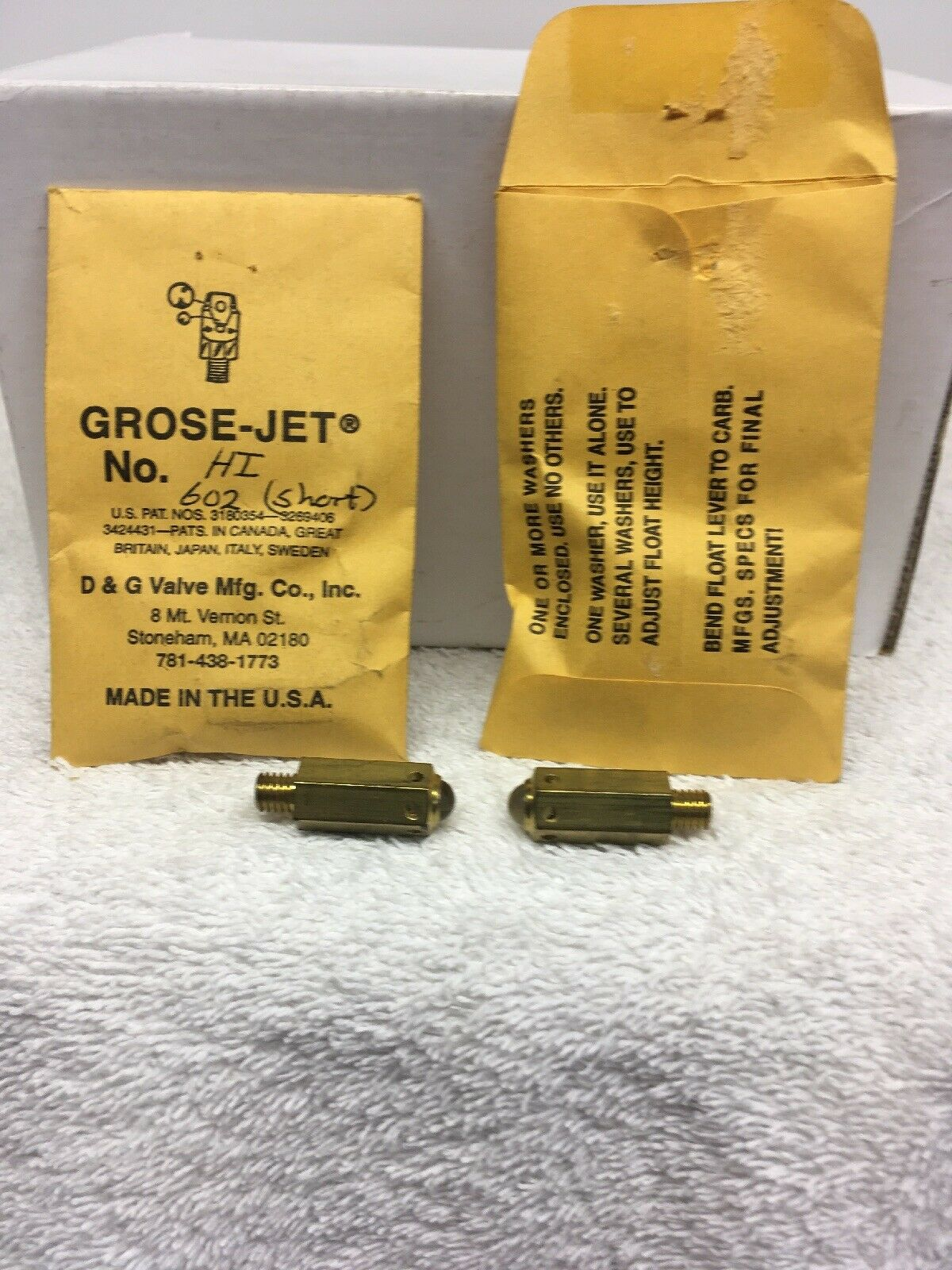

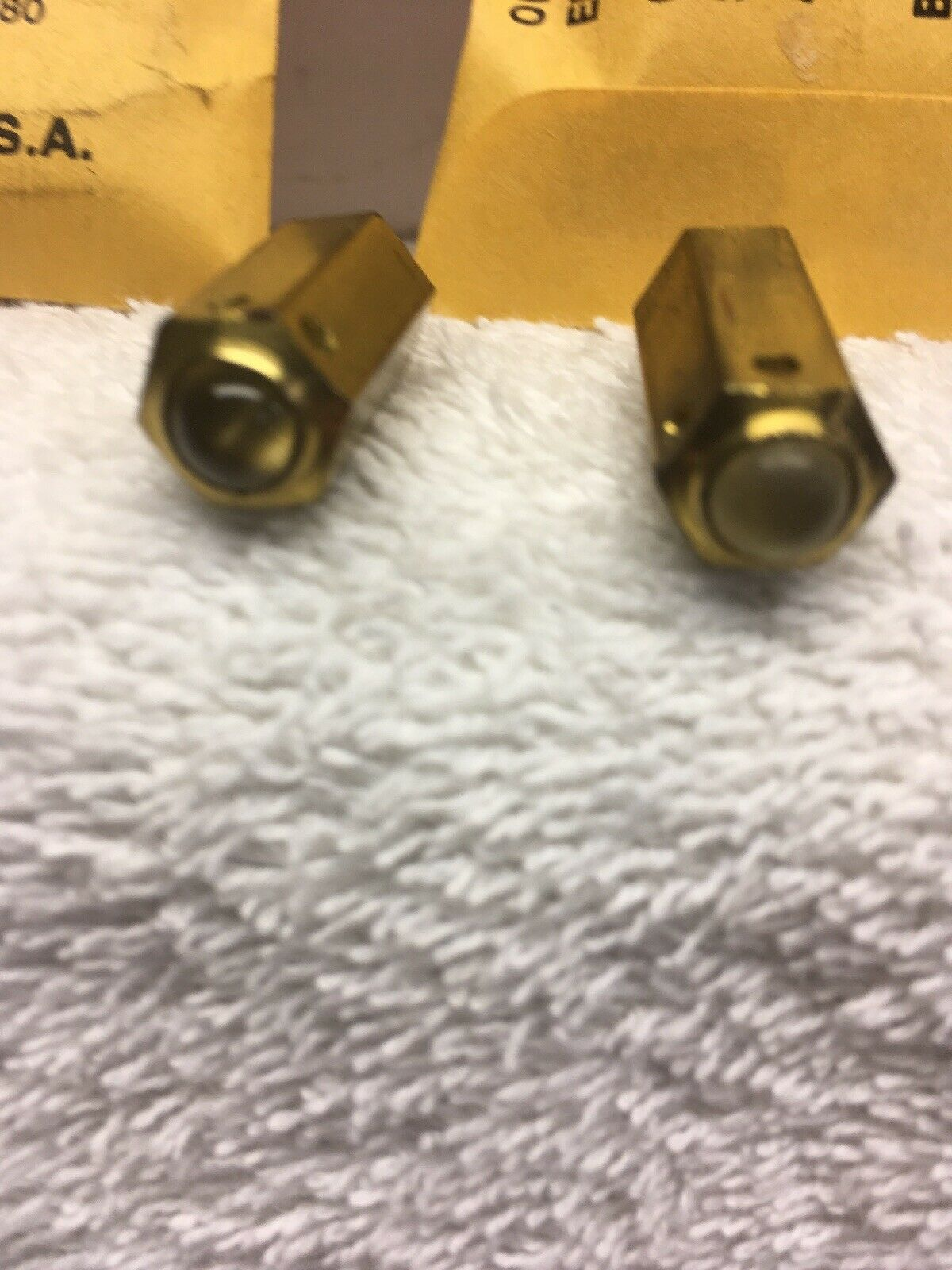

Reviewing an old Grose -Jet products list confirms Hi 602 is for the round tops but I don't see a short or long description. Any guess why your pack says short?

Are those for reference, or are they available new?
He found those on ebay, NOS.
They're no longer on ebay either 'cause...
I mentioned wanting a set in a post above, he found those and, drum roll please, they'll be here next week! ?
I love that man. :love:
I don't know if I'm happy for you or not! ?
