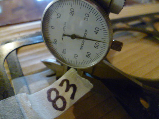

With that in mind, I did this... I measured the thickness of the head gasket I took off the motor. It came out to be about .047:

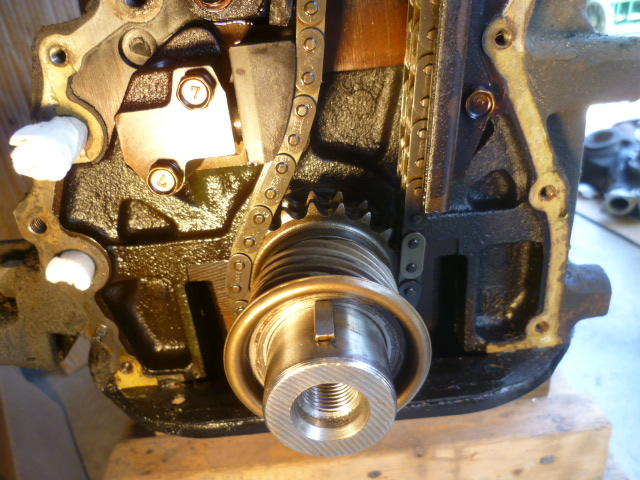

So with the head gasket installed, the chain system looks like this:
Here's a close-up of the tensioner with a normal head gasket installed:

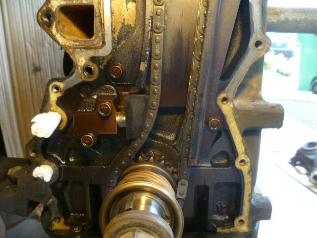

And here's what the chain system looks like when there is no head gasket installed:
And here's a close-up of the tensioner with a .047 shave off the head (simulated by putting the head on with no head gasket):
How does that tensioner look to the collective? I'm not thrilled. I think maybe a .040 cut would be safer.

Yeah, that .047 difference really changed the position of the tensioner.
However, forgot to mention... The chain guides and tensioner shoe are worn in that pic. If they were new unworn, it wouldn't be quite so bad. I can also slot the slack side guide holes a little to bring it in closer to the chain.
I'm thinking that my sweet spot of "low hanging fruit" could be about .040 off the head, get new chain guides and tensioner shoe and slot the bottom hole of the slack side guide a little bit.

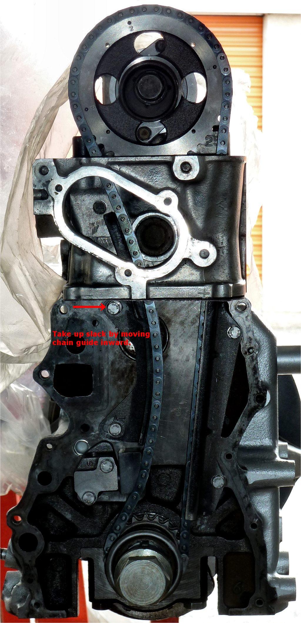

You can adjust the slack side guide inward at the top to take up all the chain slack so that the tensioner goes back.
My Blue 280z was shaved 2mm with no slack adjustment correction. I moved the chain 1 tooth to get the timing back so that the mark on the cam tower aligned with the sprocket triangle.
