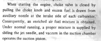

That's a good clue then.  Here's another clarifier - were you driving it when it "stopped working" or do you mean it just wouldn't start one day?  Any chance you got some bad gas?
Did you follow the proper starting procedure?  Maybe your choke cable came disconnected and you've lost choke.

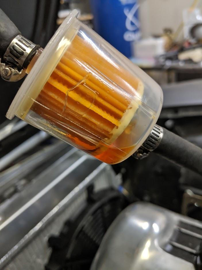

It just wouldnt start one day. It's pretty hot here in austin so I normally just choke it 1/4 of the way, but choking at 25% 50%, 75% and 100% did nothing.
what should I be looking for for bad gas? I recently pulled the tank and flushed it / did a small acetone rinse, but the gas does have a light reddish hue.

Bad gas is hard to diagnose.  It just doesn't light up like good gas.  You could drain your float bowls and refill them with known fresh gas as a test.
Did you check that when you pull the choke knob/lever that it's actually moving at the carburetor?  You might be pulling the knob but nothing really happens.

@Captain Obvious Can confirm I did not let the magic out. Sorry for the late reply, got tied up at work. Turns out @Zed Head was right on the money, I drained the tank + carbs and flushed the lines then  added new gas. Started right up! Carb rebuild definitely helped make it start quick!
