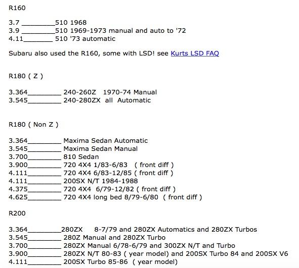

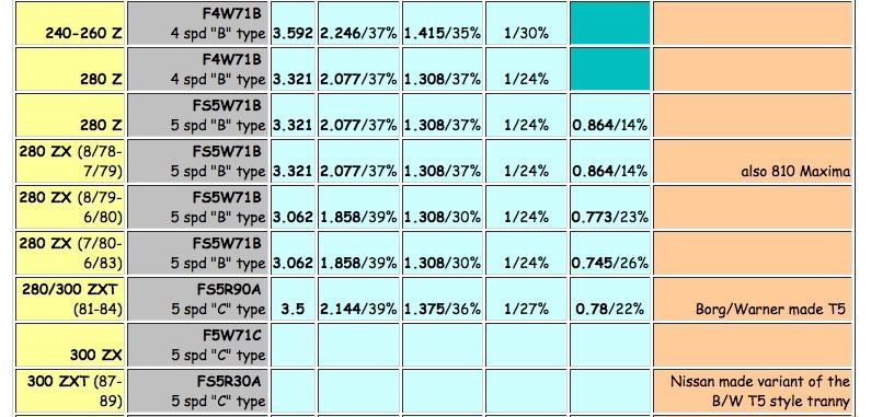

Garm, make sure you know the diff in the various ones, the 280z has final OD of like .83 iirc vs a .75 on a 280zx, it will matter as far as the diff you want. the key is a wide ratio vs a close ratio transmission.
You should check your diff for sure.  If it has an L28 it might also have an R200.
I never know for sure what's going on with the 240Z diffs.  The FSM seems to show certain things and people find different on their cars.  The 1973 FSM shows a 3.364 ratio diff in your car combined with a 3.592 first gear.  But that still leaves a 3.364 final ratio in 4th gear, which is "tall" and should not leave you grabbing for 5th on the freeway.  A 280Z with a 5 speed would have a .864 x 3.54 final ratio >>> 3.06.  But the 280Z's came with 4 speeds for three years, a 3.54 final ratio in top gear.  So your stock 73 240Z should have a nice cruising RPM in top gear.
Anyway, in short, know what you have before you buy replacement parts.  You can determine your diff ratio by turning the wheels and counting propeller shaft revolutions.  Take a picture and post it and we'll tell you if its been replaced in the past.

5th gear in the early 5-speeds is definitely an overdrive gear - for lowering RPM and getting better fuel economy at cruise. Spirited driving (and probably top speed) will be done in the lower 4 gears. Sounds like your differential will be stock which would be a 3.36 R180. My 260Z came equipped with the same differential and I used it for years behind my L28ET and ZX close ratio 5-speed before swapping to a 3.54 R200. The L-series engines used in the 240Z, 260Z, 280Z, and 280ZX (1970-1983) had a similar block config and any transmission mounted to one can be mounted to any other.

then there is the diff. can you live with the one you have? My thinking is A 3.70 or 3.90 is needed. hard to find in R180 form. a close ratio could go to a 4:11.
Put your car on a jack or stands. Put piece of tape a wheel and one on your driveline. Rotate the wheel and note if both wheels turn in the same direction and count the number full turn you make and how Many turns the drive shaft turns. The more turns you make the better and in multiples of 10. shoot photos of your current diff from side and back .

The other end is 1st gear.  Taking off from a stop.  If you live in the hills, a 13:1 overall ratio in first might be appropriate.   3.9 X 3.321 (Z or KA/71C), for example.  If you're on the flat lands, maybe a 3.54 and a 3.062 (1980+ ZX), 10.8.

That's an odd number for a 73 240Z.  Is it still the R180?
It's still a good ratio for any of the 5 speeds.  The 71C front case swap is a nice option if you get a later model 240SX transmission.  Synchros in reverse and some have double synchros on second gear.  Plus wider gears, physically, than the early 5 speeds.

R180 to R180 with different ratios is easy, as is R200 to R200. R180 to R200 needs a few more parts.
