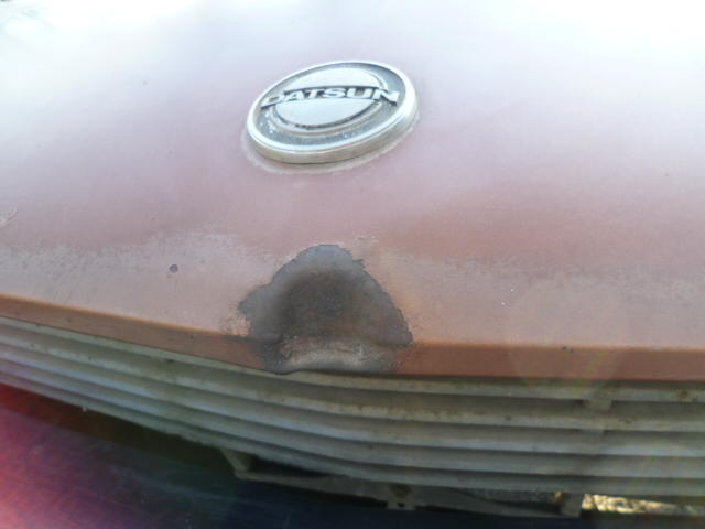

I believe my buddy @GGRIII (you met him at my place at the wheel bearing party) has the original hood from his 260. It has the traditional parking lot dent on the front point, but other than that, I believe it's straight. He was going to fix it but found a near perfect replacement instead that saved him some time when he did his car.

For the collective, here's a pic of the dent on the nose of the hood I mentioned above.
For those of you with body experience... How hard of a repair is this? I know everything is repairable with enough time and effort, but where on the scale does this fall?
Those kind of dents are very difficult for me. There is basically no access from the backside. So I would resort to stud welds or maybe even a plate and pull it. But you can't really hammer and dolly it to fine tune it. The 2 crease lines also make it harder to reverse the dent. If you were super adventurous you could de-skin the hood and fix it properly but a daunting task! You might could open the structure up on the bottom side, so you could slide a flat bar up in there from underneath. Then drive the dent out that way. I think there are 3 stampings at the front of the hood but I'm not sure and dont know the finer points on the construction.
Echo what Patcon said. My hood had a similar dent, but not as bad. Stud welder got it into decent-enough shape for body filler, but the vertical face on mine is now slightly diamond shaped instead of a consistent height all across. I was fine with that choice, but I know others might not be. Stud welder and relief cuts might work, too.
Yup, worst place to have damage on a hood.  I've banged a few of them out from behind but never in that location or that bad of a crease...
Yeah, my painter says no go. Thanks for the attempt, though!
