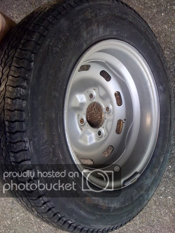

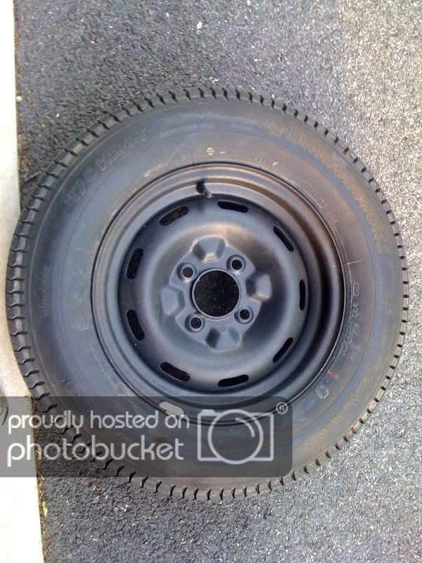

Thanks Blue, I see the pic of the original wheel. Looks like a satin black (not gloss).....would that be a correct assessment?
Edited by Diseazd
That’s wild! .......wonder why they used two colors?  Thanks for your help.
Guy
Don't want to beat a dead horse, I can't find the thread.  And I just got back to this computer.  I've posted this picture before when I was talking with Kats about original wheels and tires.  This is from 26th.
Edited by 26th-Z
But it's fully painted, correct?
Well, yes.  Wow, does that picture look crappy on this monitor!  What happened?
The paint finishes are mat texture and although the silver may look like primer, primer is porous and not a sealing film.  The paint coating seals the steel.
