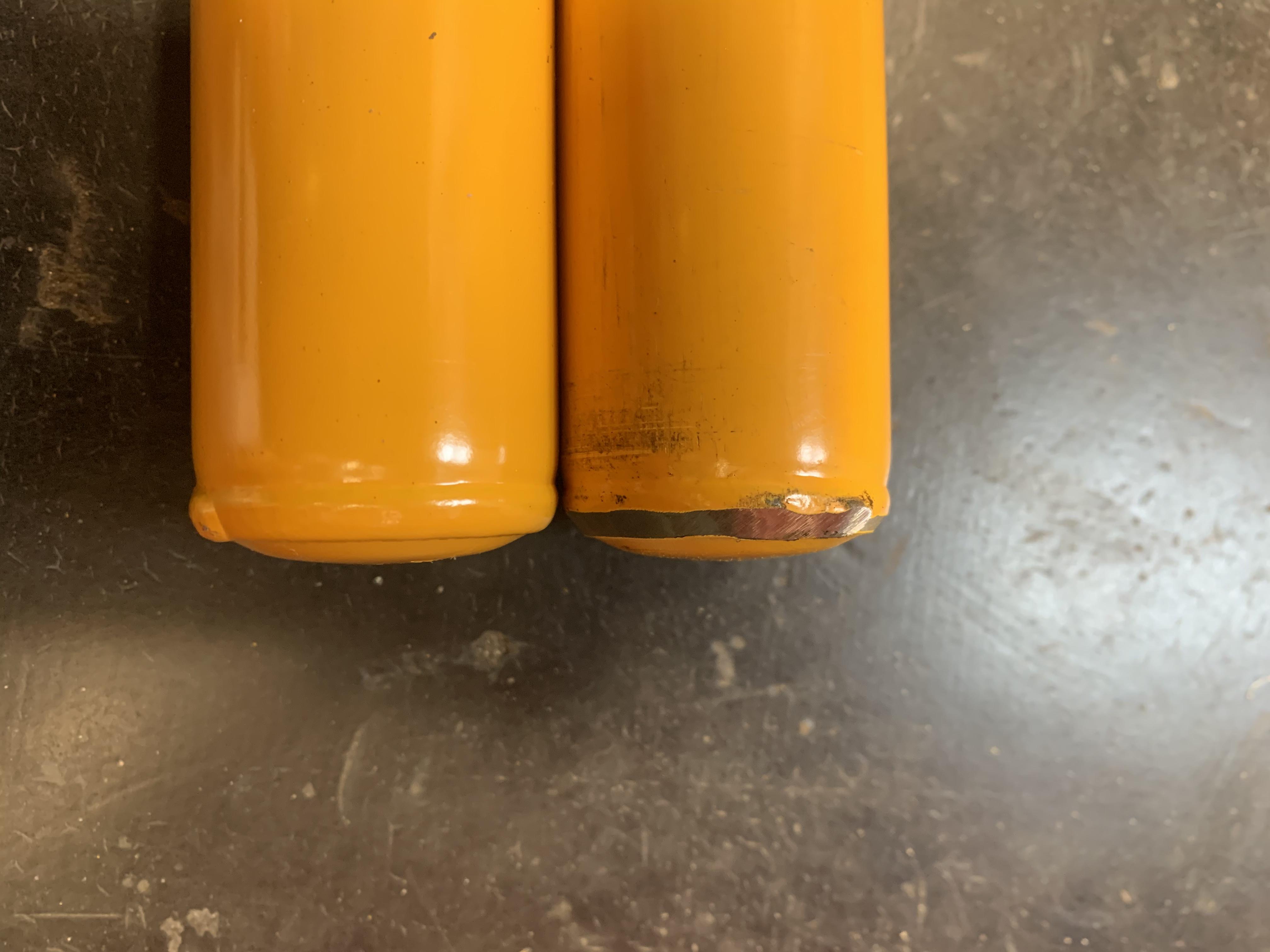

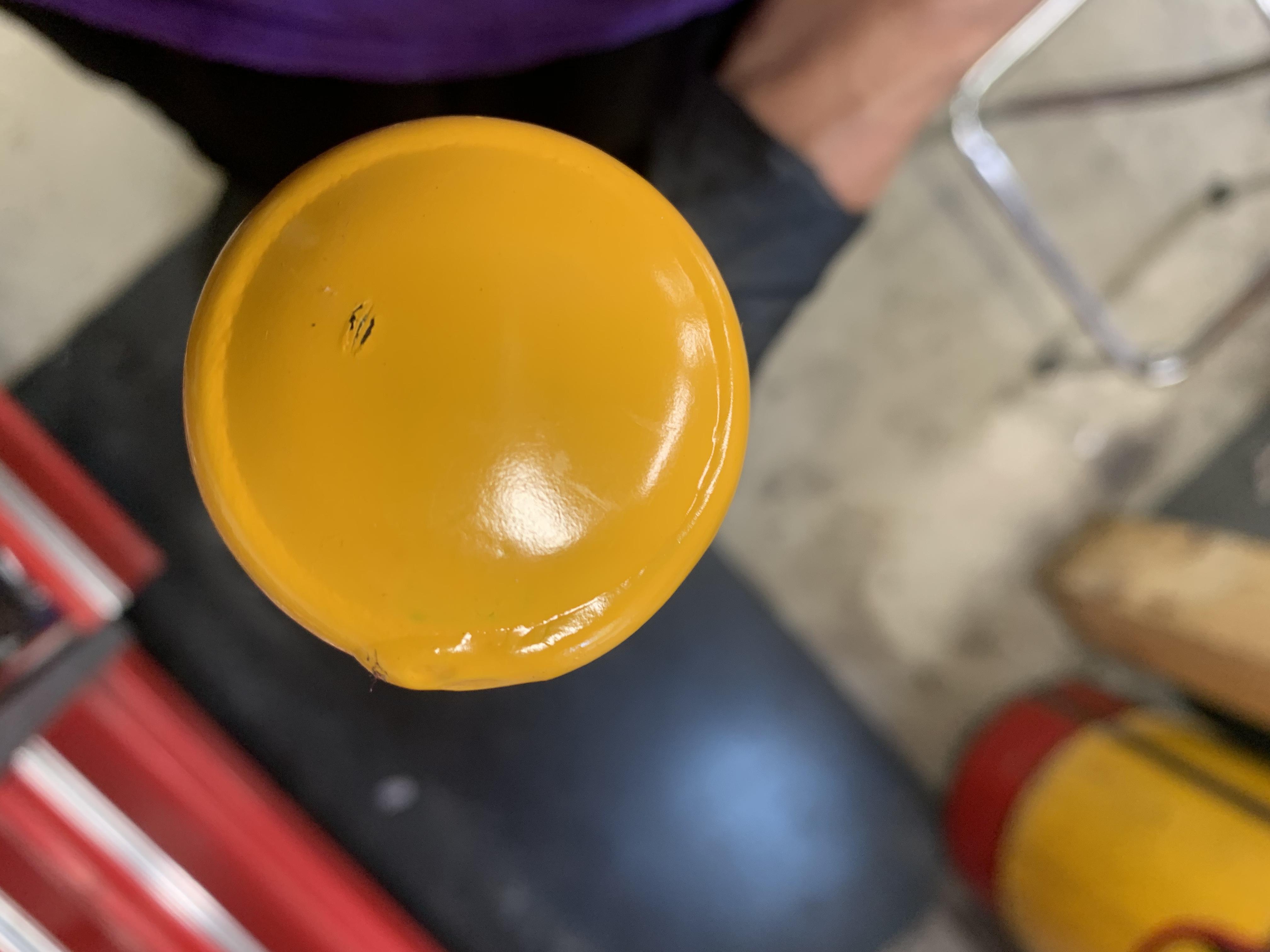

On 10/17/2020 at 5:01 PM, madkaw said:
Here’s my remedy - I don’t recommend this to anyone as a disclaimer .
You will notice the one pic showing the distinct bulge from the weld bead . The fit is so tight that it makes a difference . I’ve grinded enough welds to feel confident for myself - but won’t tell anyone this is the fix . Even with this “fix” the cartridge still stands tall in the housing .
Koni always had this issue from the start with 240Z's. I have a set of Koni 'reds" from 35+ years ago and we did the exact same thing to fit them.
They are that tight. If I were Koni I would make them a wee bit shorter to make up for the welds on the bottom.

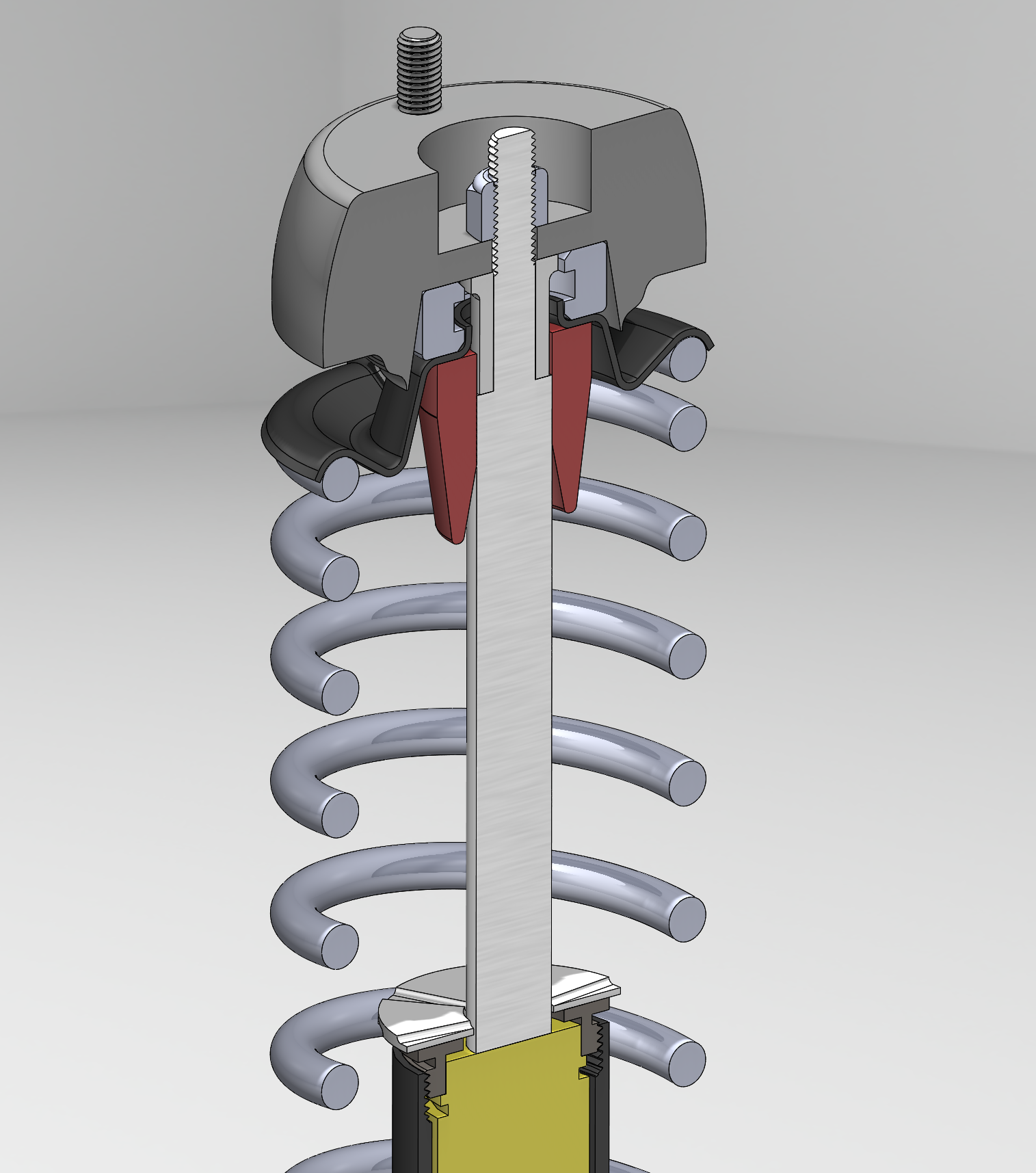

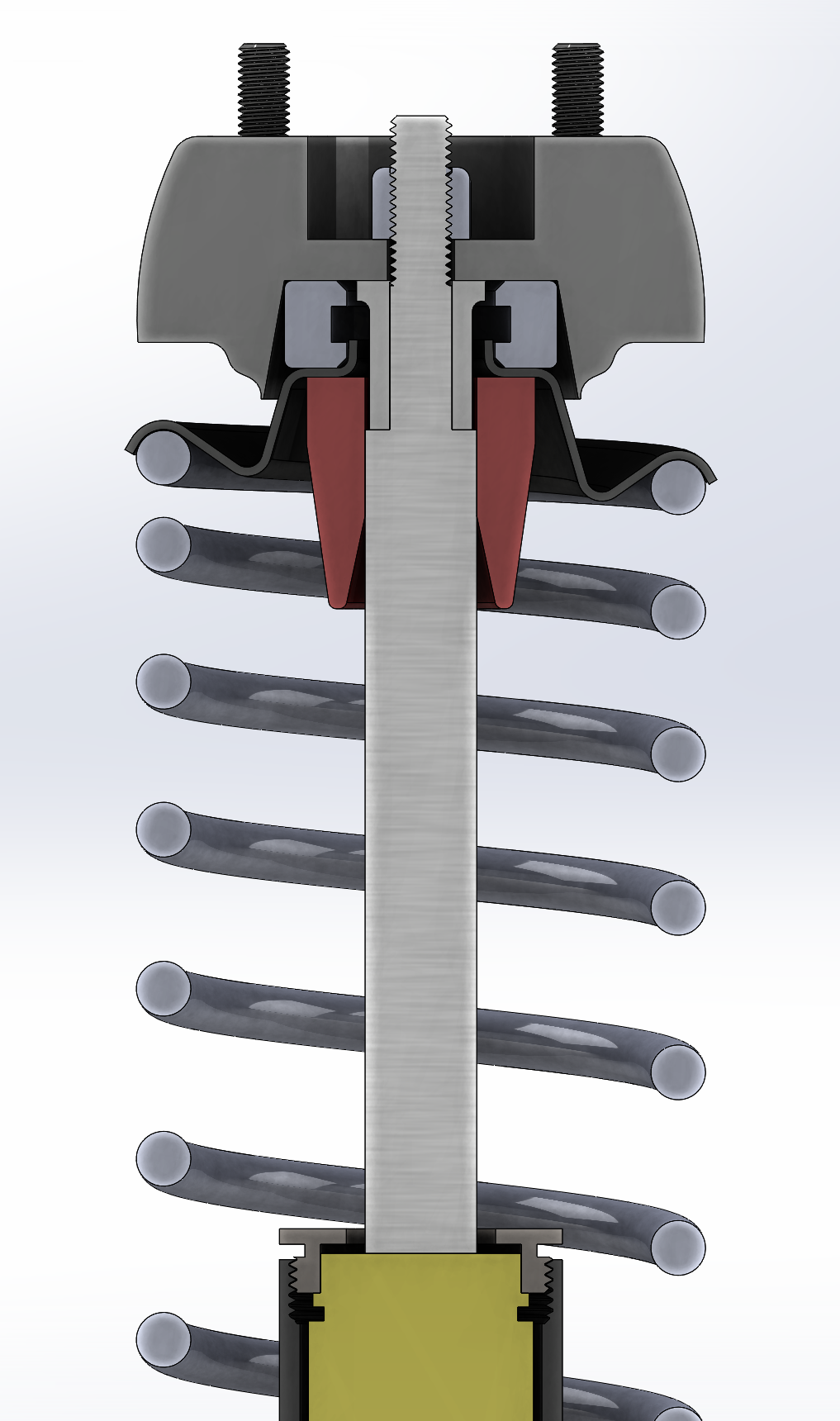

Hey guys,
I was thinking about drawing up some Datsun Specific instructions for these. Is that something anyone would be interested in? I started modeling some reference 3D files for my own sake. Can anyone confirm this is the stack up for the fronts?

Yes it is but don’t forget the white washer that goes at the bottom to stop air locking if bottomed out.
Updated with another screenshot. Thank you!
Where did you get that idea? That is not what the washer is for.
