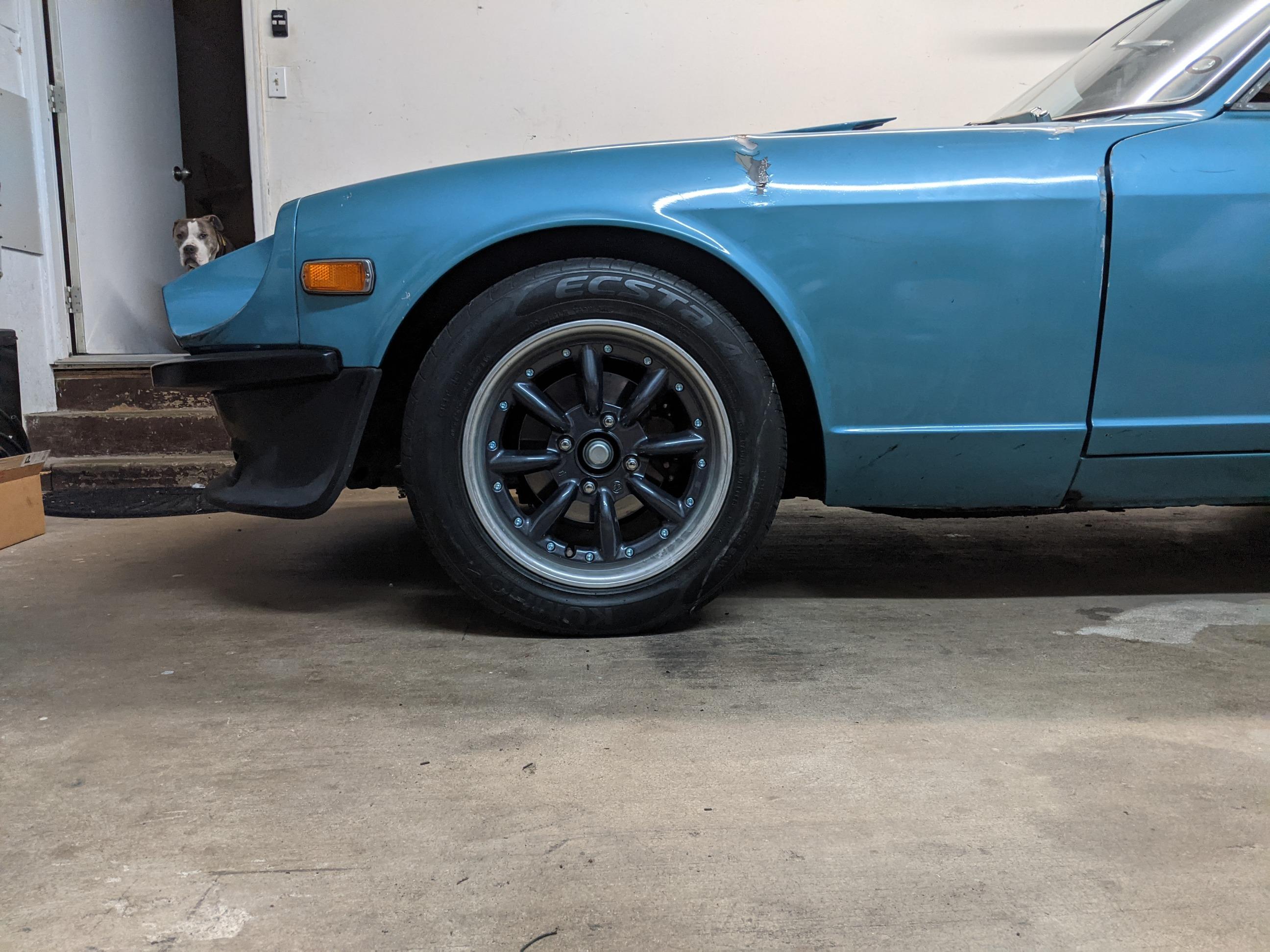

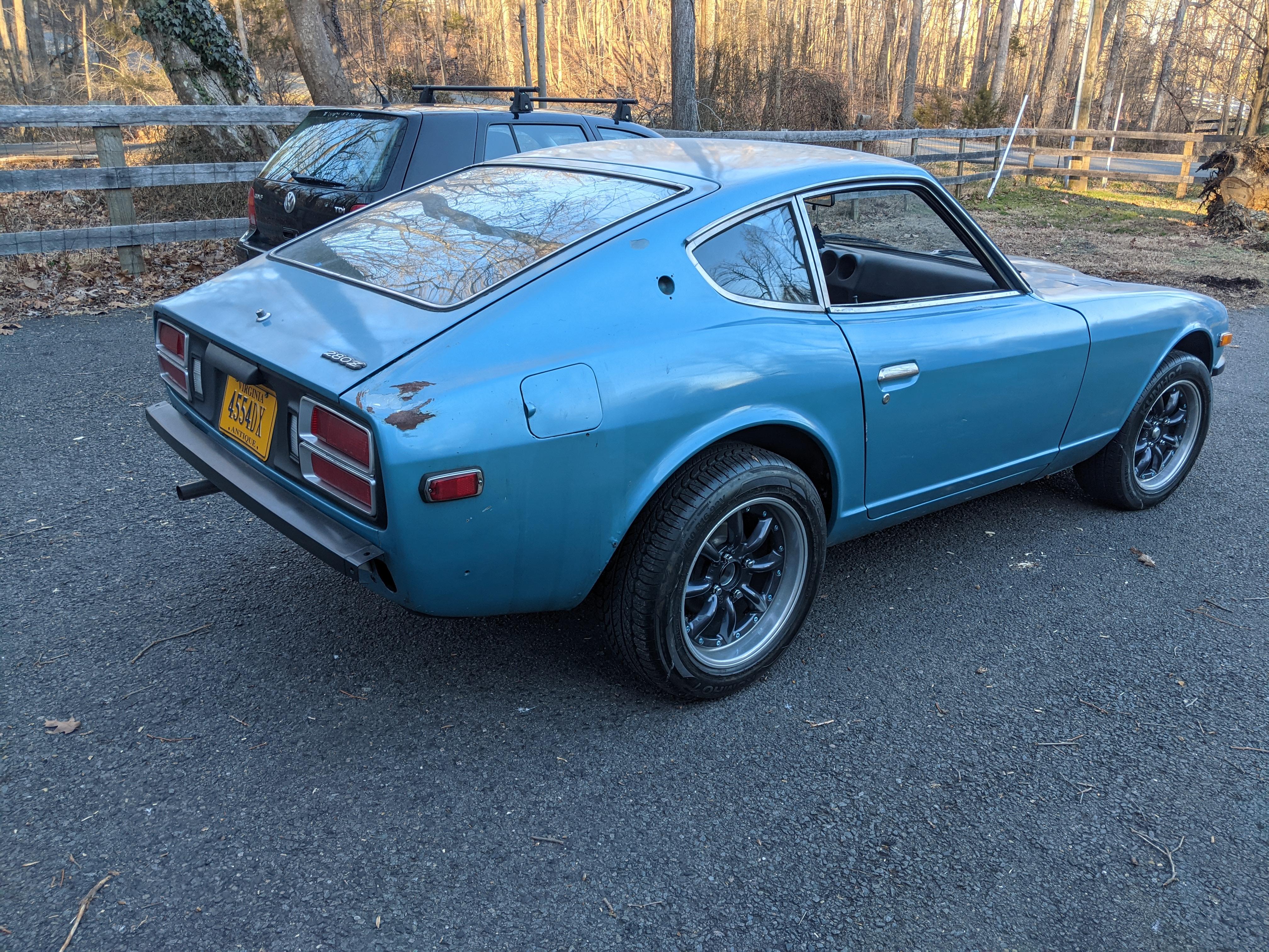

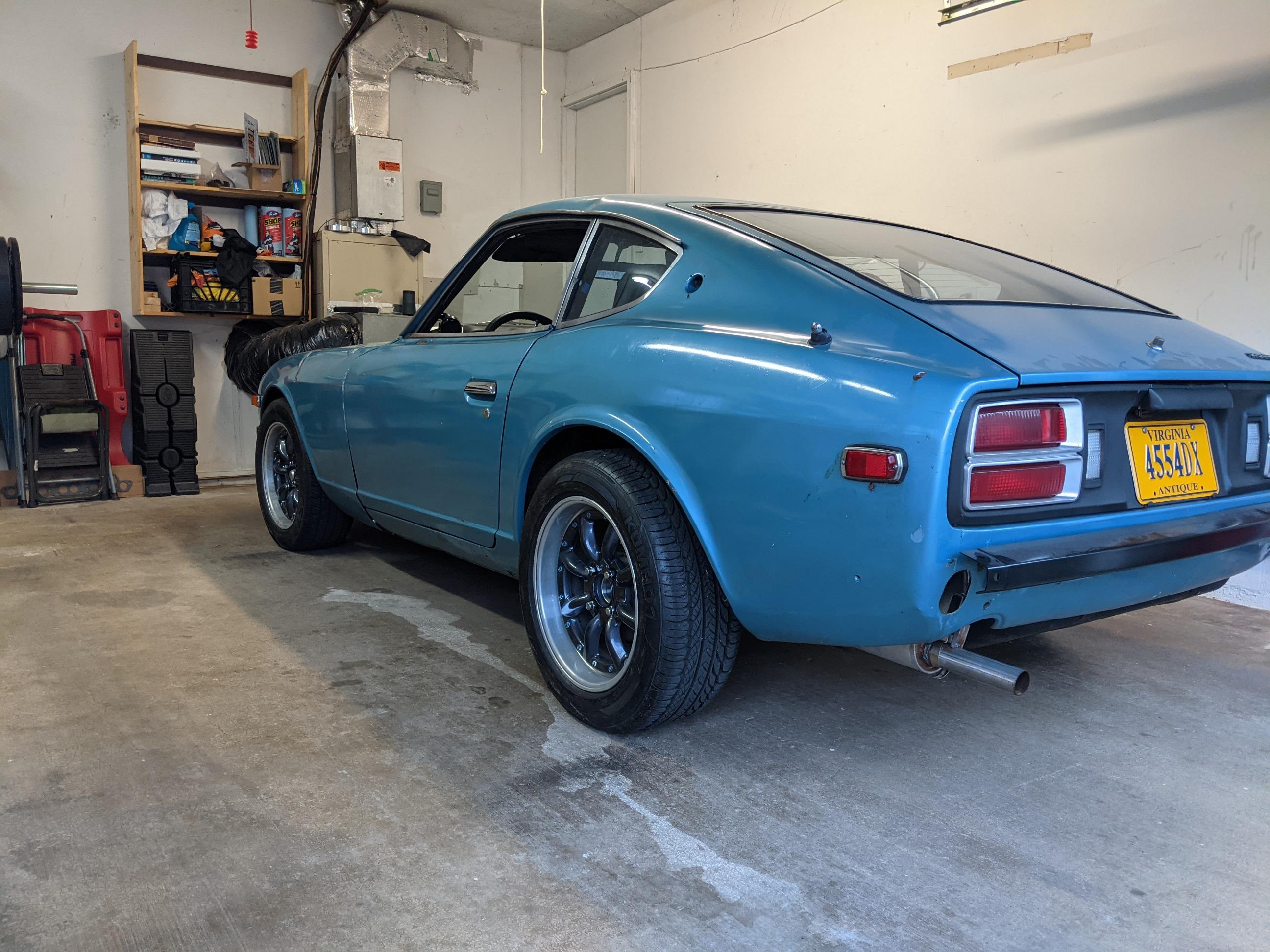

Once installed, the drop in ride height was definitely noticeable.  I didn't measure, but I'll include a picture or two of the before/after.  I set the shocks to 1/2 rotation from full soft for starters, and haven't felt the need to adjust them further yet.
I've been out on 2 short twisty drives so far.  The car feels firm, but in a sporty confident way.  Bumps are felt but not harsh.  Far less dive and roll.  I'm sure the sways are helping there as well.  The shocks and springs seem very well paired.  A definitely improvement over the floaty feeling of the stock springs/sways + KYBs.  Looking forward to pushing it a little harder this summer!spacer.pngspacer.pngspacer.pngspacer.pngPXL_20210110_210655098.jpgspacer.pngspacer.pngspacer.png

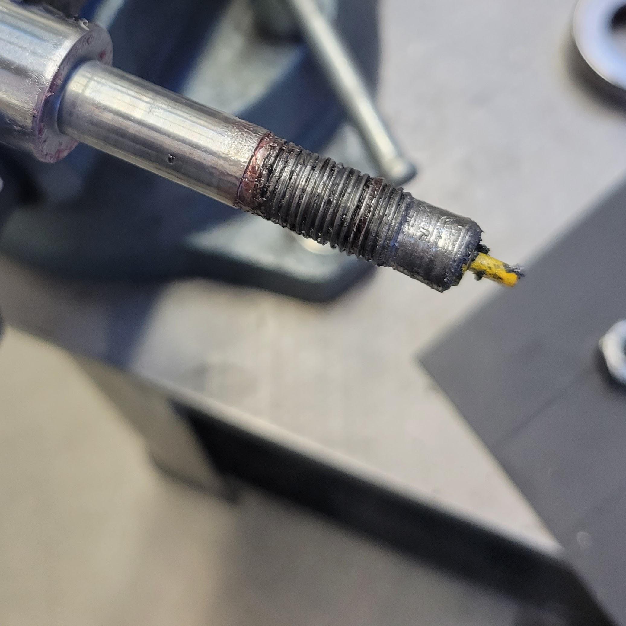

Hey guys,
I'm wondering if anyone has had any issues with the top nut stripping out or crossthreading?
I installed the strut with no issue which involved hand threading the supplied nylock nut until it hit the plastic locking section, then tightening by hand with a socket wrench. I realized I forgot to put the bump stop into the assembly and began unthreading the top not and it eventually froze up and would not move. After some creative clamping and a lot of force I was able to remove the top hat assembly but the threads and adjustment knob on the strut are destroyed. The adjustment knob does not move and the strut seems to have lost its dampening resistance.
I am a little baffled about how this could have happened so aggressively. I don't use nylock nuts usually and this one seemed very aggressive. Is this a common issue with nylocks?
