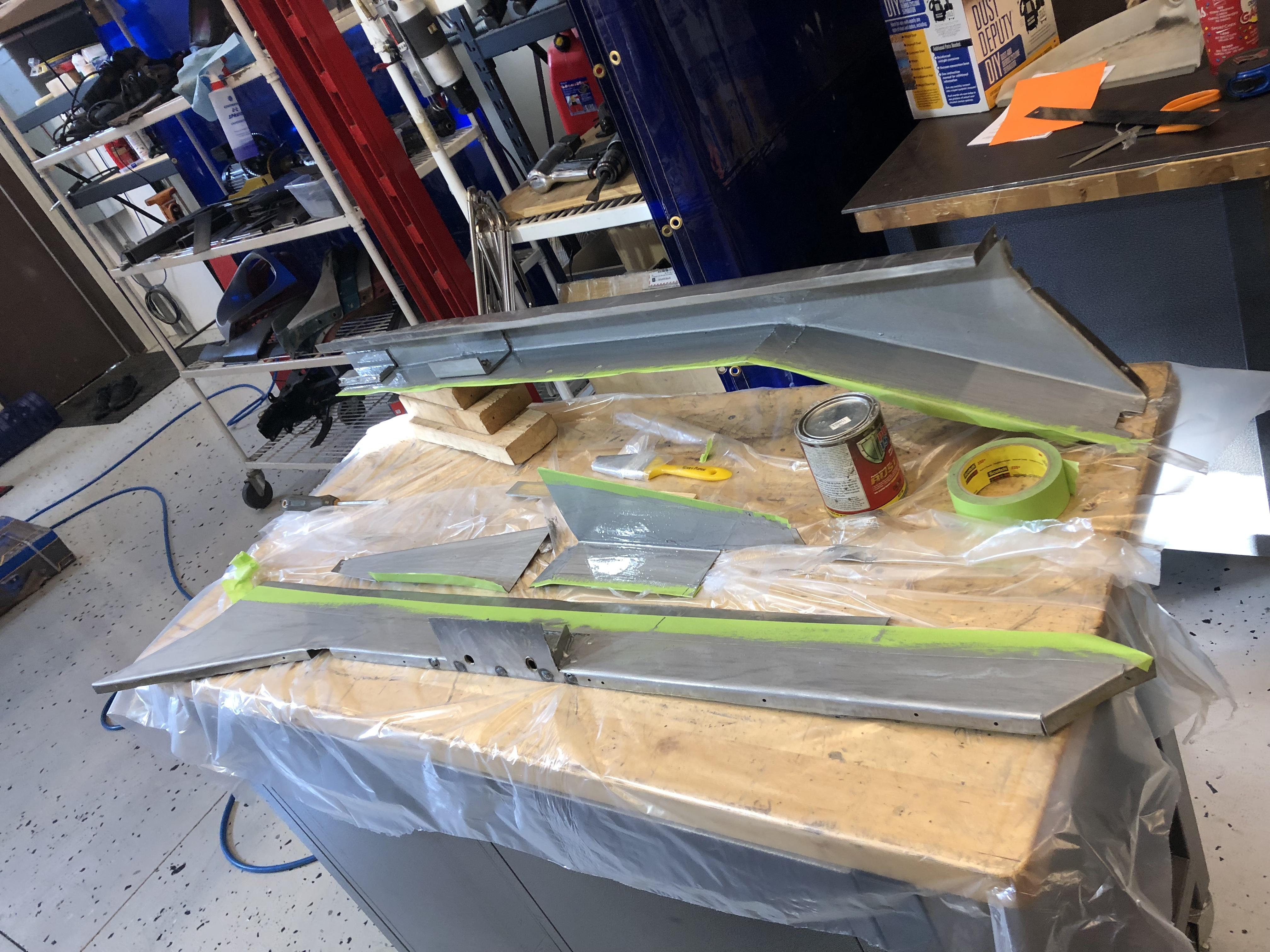

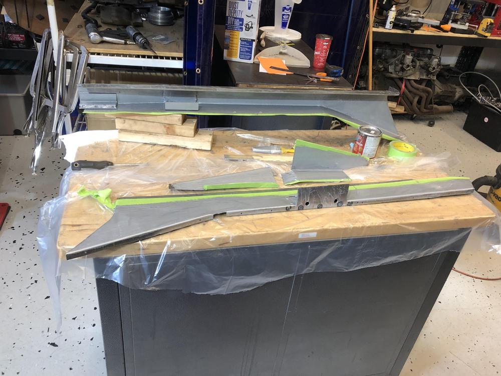

14 hours ago, Namerow said:
Paint stripper for undercoating.  That's a worthwhile discovery.  Certainly a lot safer than using a torch and probably more effective than a heat gun. Undercoating removal is a miserable-but-unavoidable job, so anything that eases the pain and improves the result is worth knowing about.
I wonder whether the stripper approach will work with the applied-with-a-brush-from-a-can parts store-type undercoating that was inflicted on so many cars from this era by their owners.  That stuff is just diluted asphalt.
I'm impressed by how well you managed to contain all of the paint and undercoating gunk/debris.  Almost makes the job look easy (although I'm pretty sure it wasn't).
Thanks!
12 hours ago, grannyknot said:
I agree it certainly is the fastest but it also comes with the danger of the stripping chemicals hiding in the seams and crevises  then seeping out after the new paint is on causing breaks in the paint, then the rust starts all over again (ask me how I know).  A small fine wire brush and an air gun along the seams helps a lot removing the last of the stripper.
Looking good,  I really like your plastic sheet trough under the work area, I'm going to try that next time.
Agree 1000 percent!  There is a little bit trapped along the shock tower seam.  Going to have to work that out.
Suggest you lay a paper towel soaked with Ospho (or some other watery phosphor-type rust neutralizer) along the seam overnight, then dry things out with a heat gun. The wire brush treatment will only remove the rust from the surfaces you can see.  The rust neutralizer will creep into the seam, where it can do its thing on the broader surfaces that you'll never reach with the wire brush (or primer, or paint).
Very good idea!  Will try that!
16 hours ago, ConVerTT said:
I forgot how slowly Por15 dries
POR-15 is a moisture cure polyurethane coating. It doesn't "dry" in the common sense, It "cures" with combination from humidity moisture in the air.
If it's cold and very low humidity (like it may be in Canada at this time), it would certainly slow the cure. It'll be ready by spring. LOL
Good point Captain.  It is minus 30 outside this week.  Of course it is temperature and humidity controlled inside - balmy 67 degrees in the shop ????

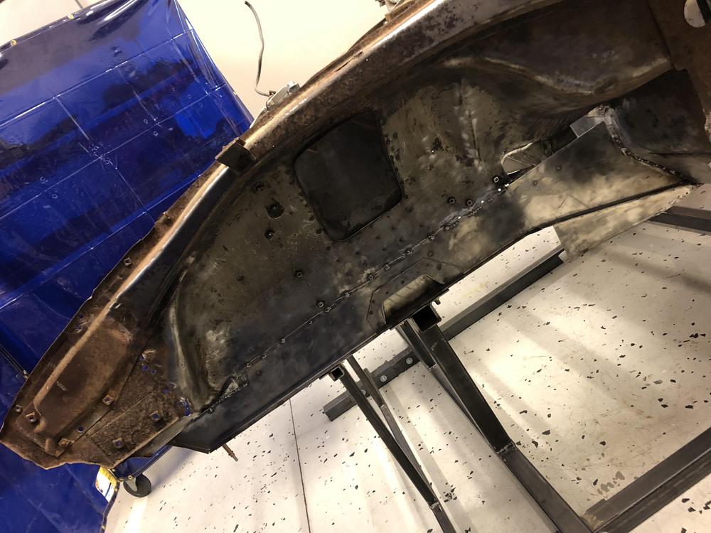

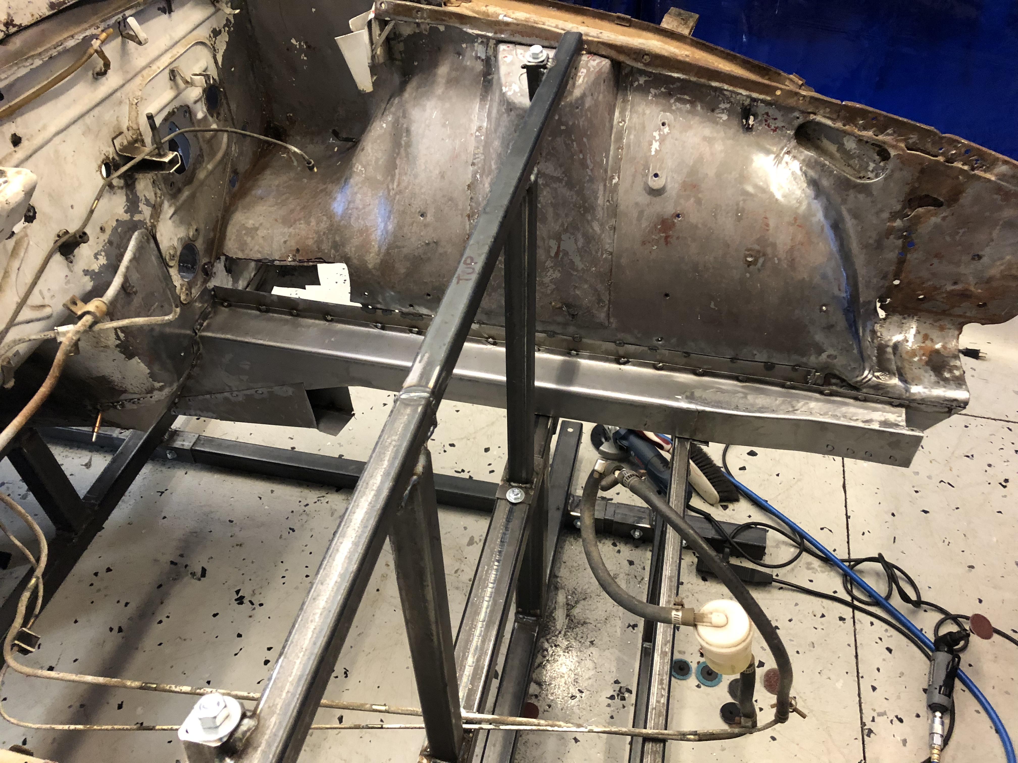

Woohoo!  Driver side welded in.  Straight and true....9544DF76-6C26-4C8E-A5D5-E39051190D6C.jpeg
So it is spot welded in for now.  I will finish the seam welding and cleanup on the rotisserie once it is off the jig.  Welding out of position SUCKS!!!

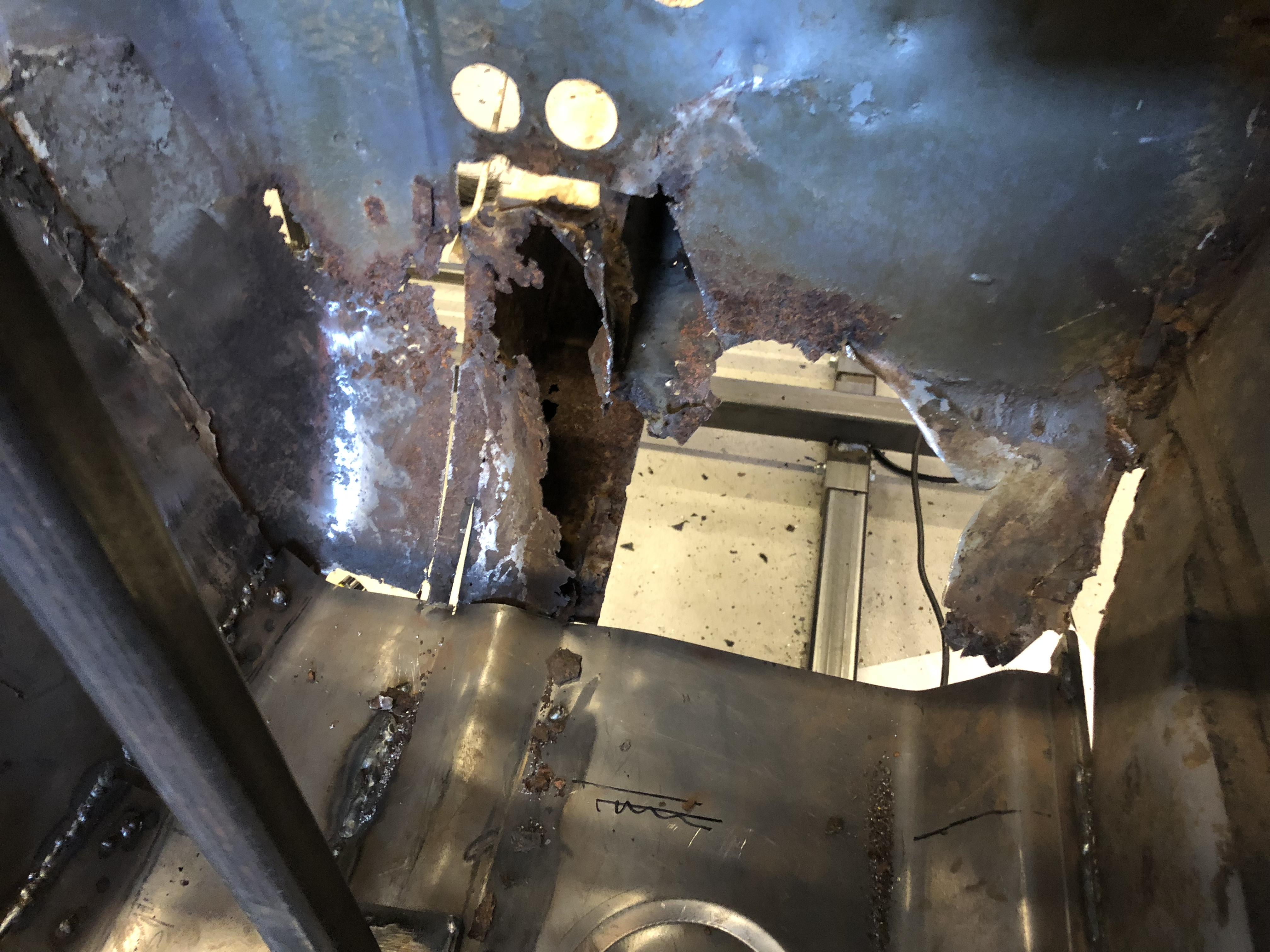

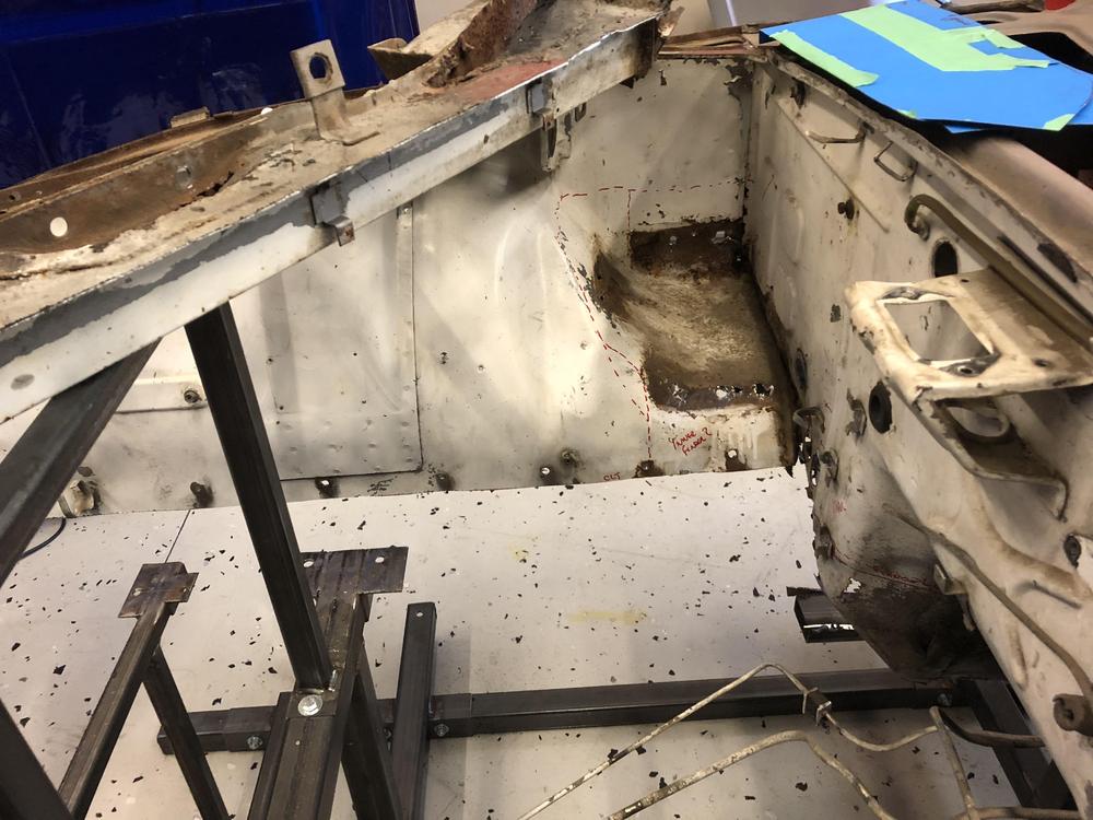

Nice firewall LOL

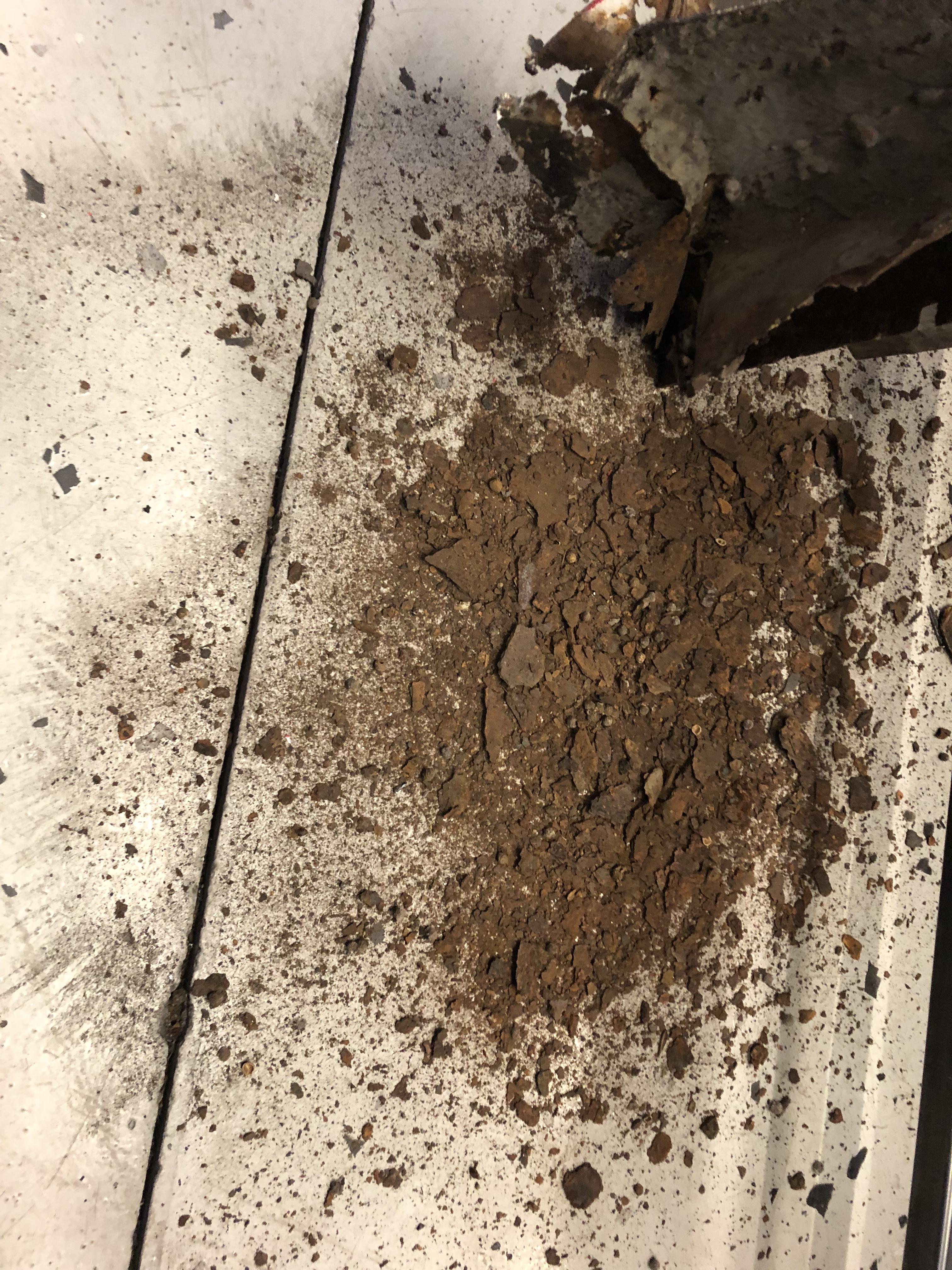

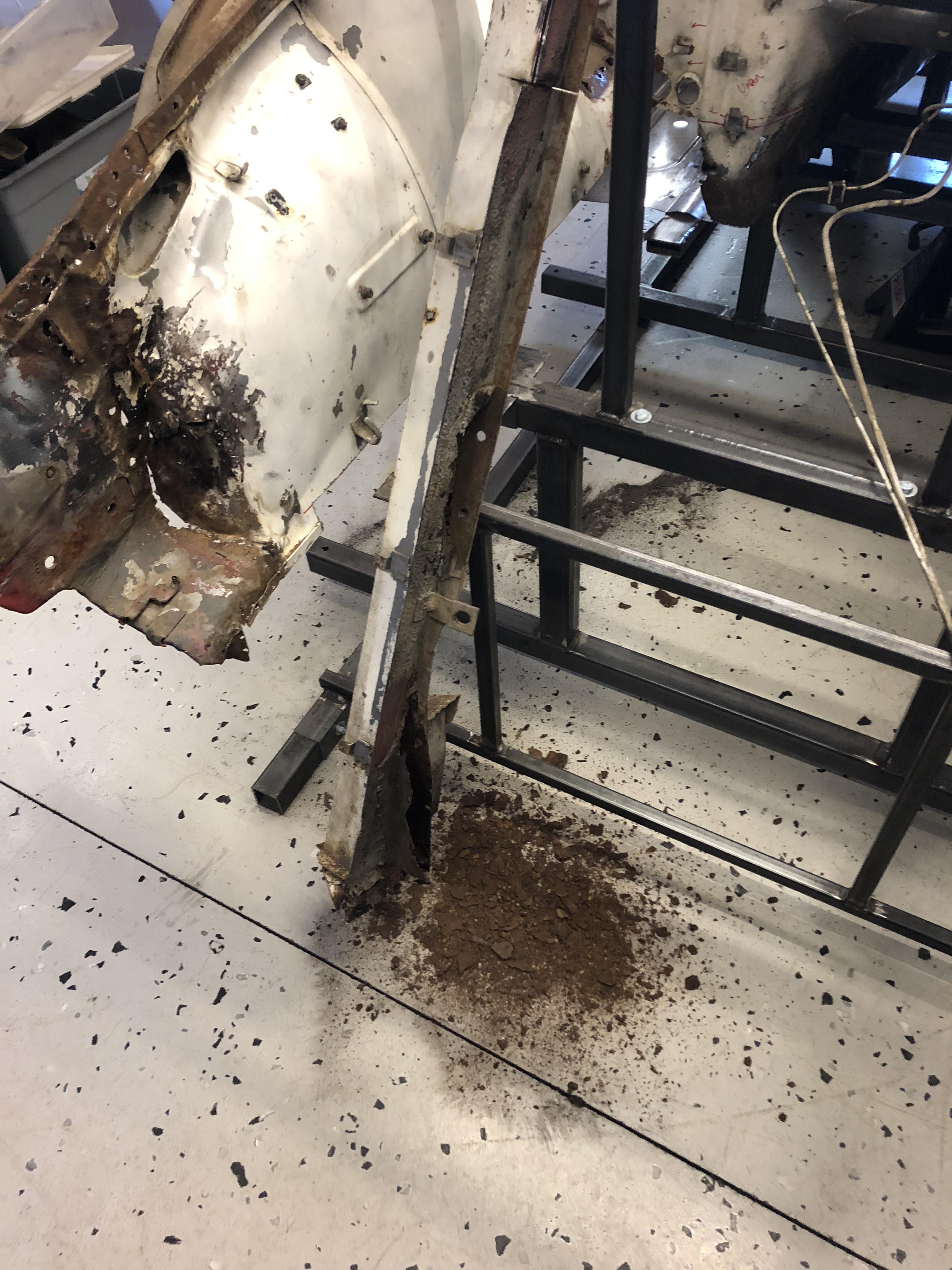

Rail cut out easily enough though ....
Check out all the rust that came out of this rail ....
+1 for the jig.  Glad I didn’t try to put that directly on to the rotisserie ....
