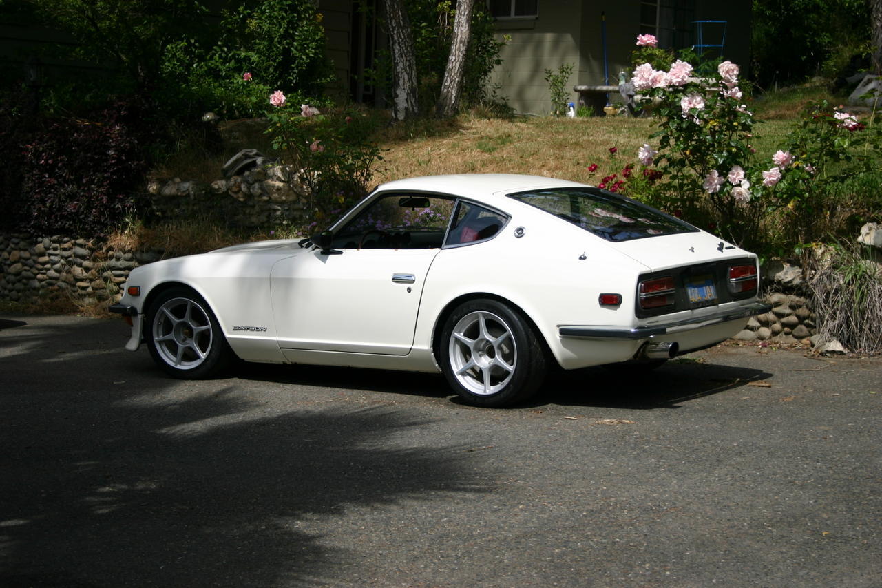

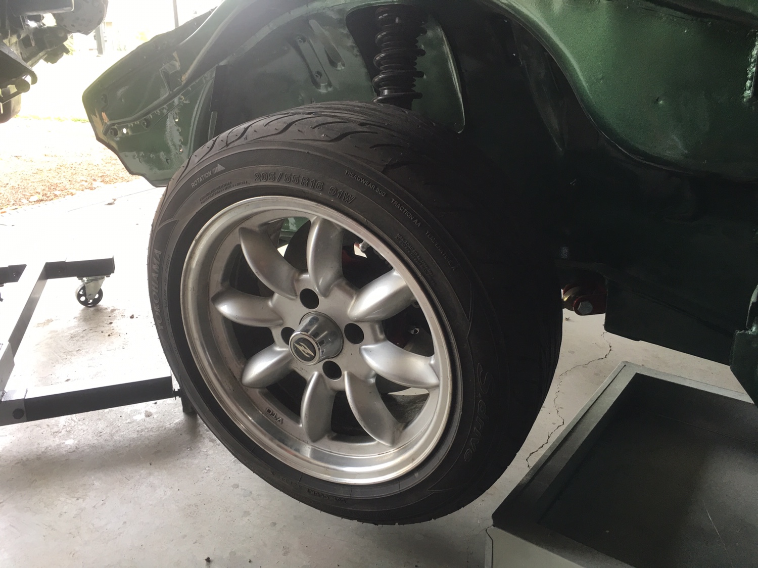

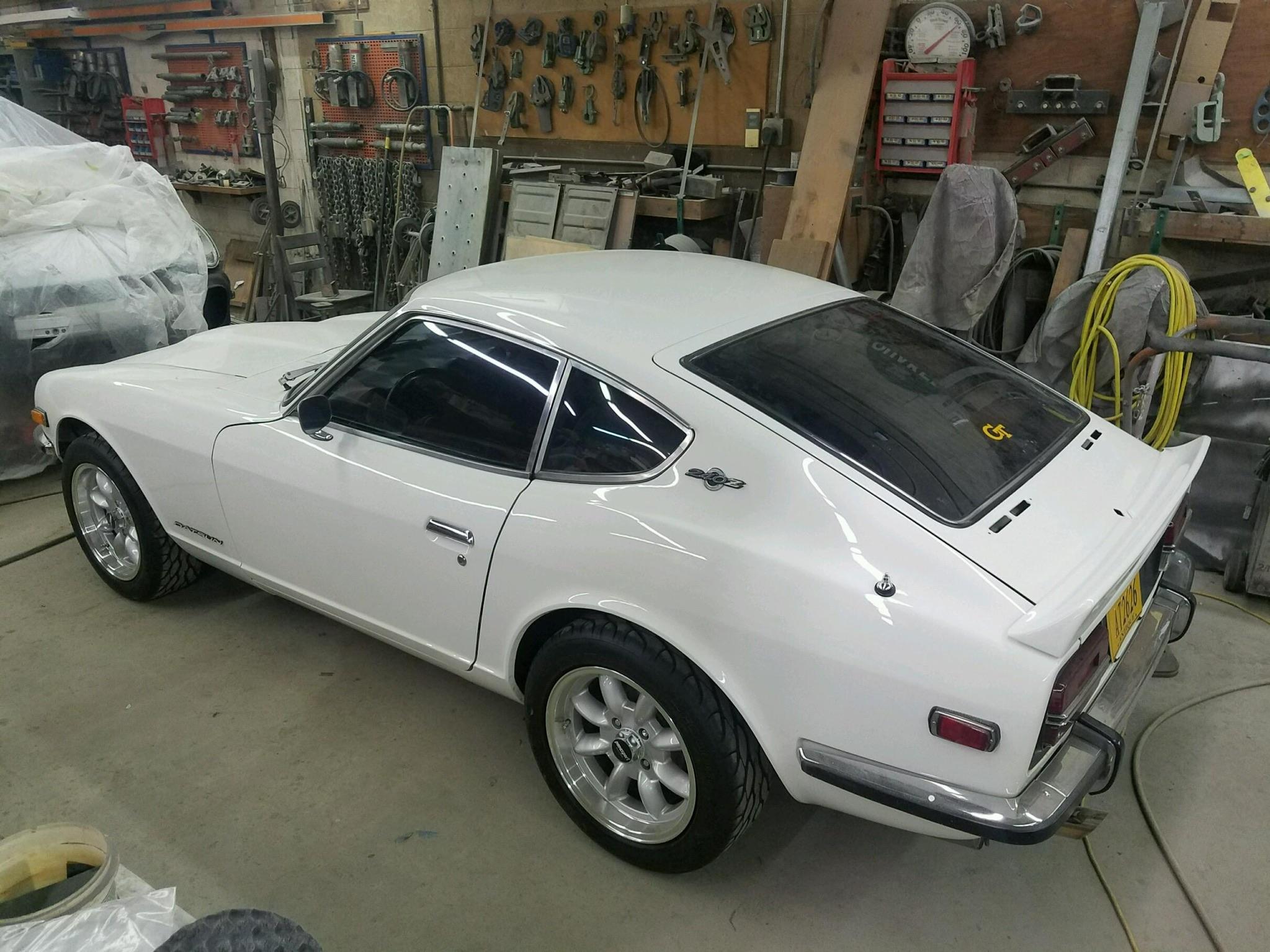

Here are pics of the car with a set of Kosei K1’s, (I didn’t like them, too modern) and the current Panasport.

CD.....I run 16x7 Panasports with 205 55 16 rubber. No problems with clearance.
Yes....I’ve tried 225 50 16’s....they rub. 205 50 16’s are too short. The 205 55 16’s are perfect IMO.....they fill the well and don’t have clearance issues. I love the Panasports (as you can see).

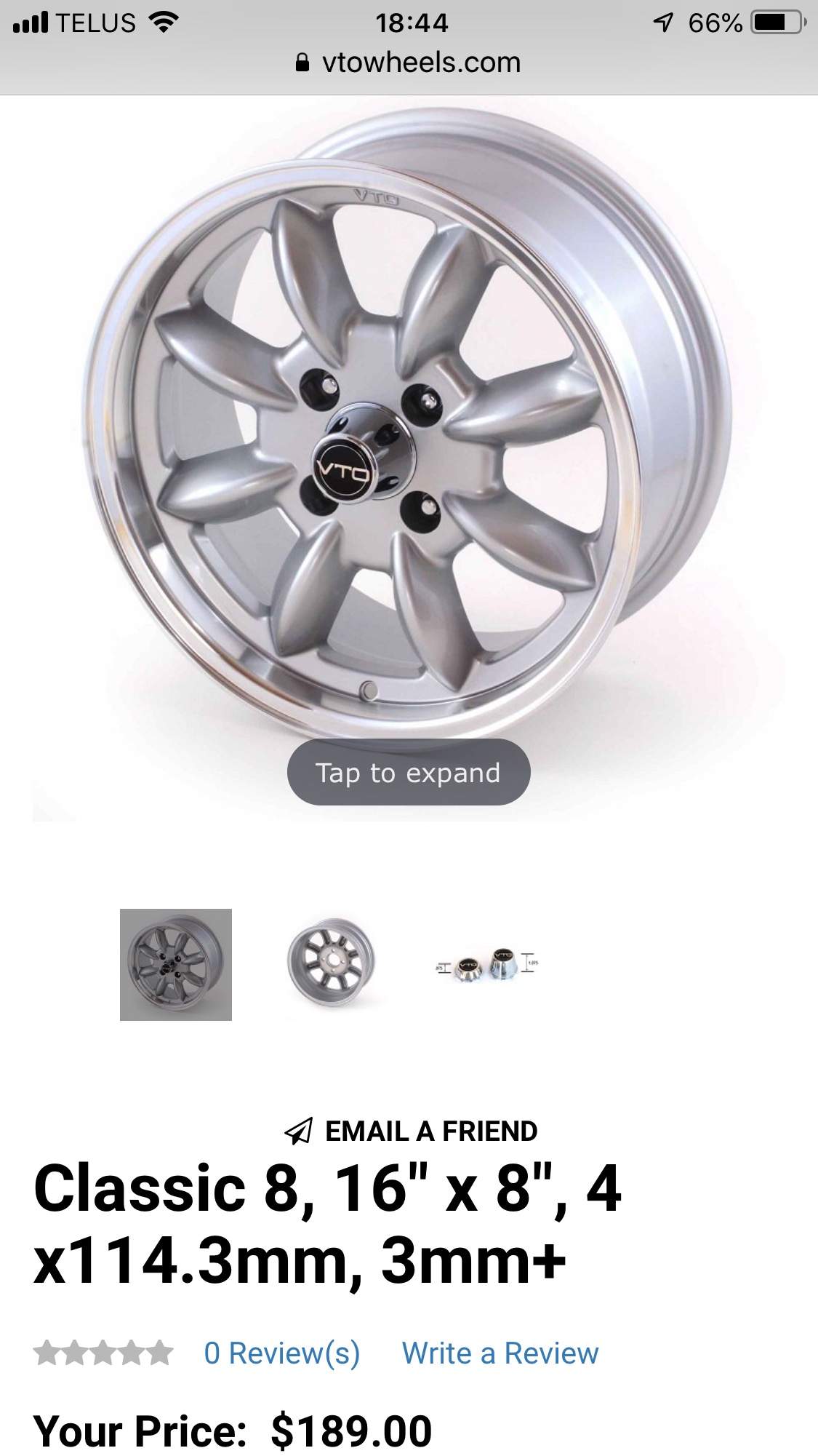

What about the 16x8 VTO classic 8’s? They are +3 offset and clear with coilovers... not sure about stock suspension.
They have them in 16x7 +0 as well. Good prices.

My concern is true offset size. I've heard some wheels can be all over the map. I know the Panasports are 0 offset. This will be my 5th set in 30+ years of Z ownership. I'll look though. If they are the ones made in the Philippines, I can walk right up to the factory and pick them up. I have a house and condo there.

(That bottom photo is over-exposed, they're silver and not white, as seen in the first shot)
