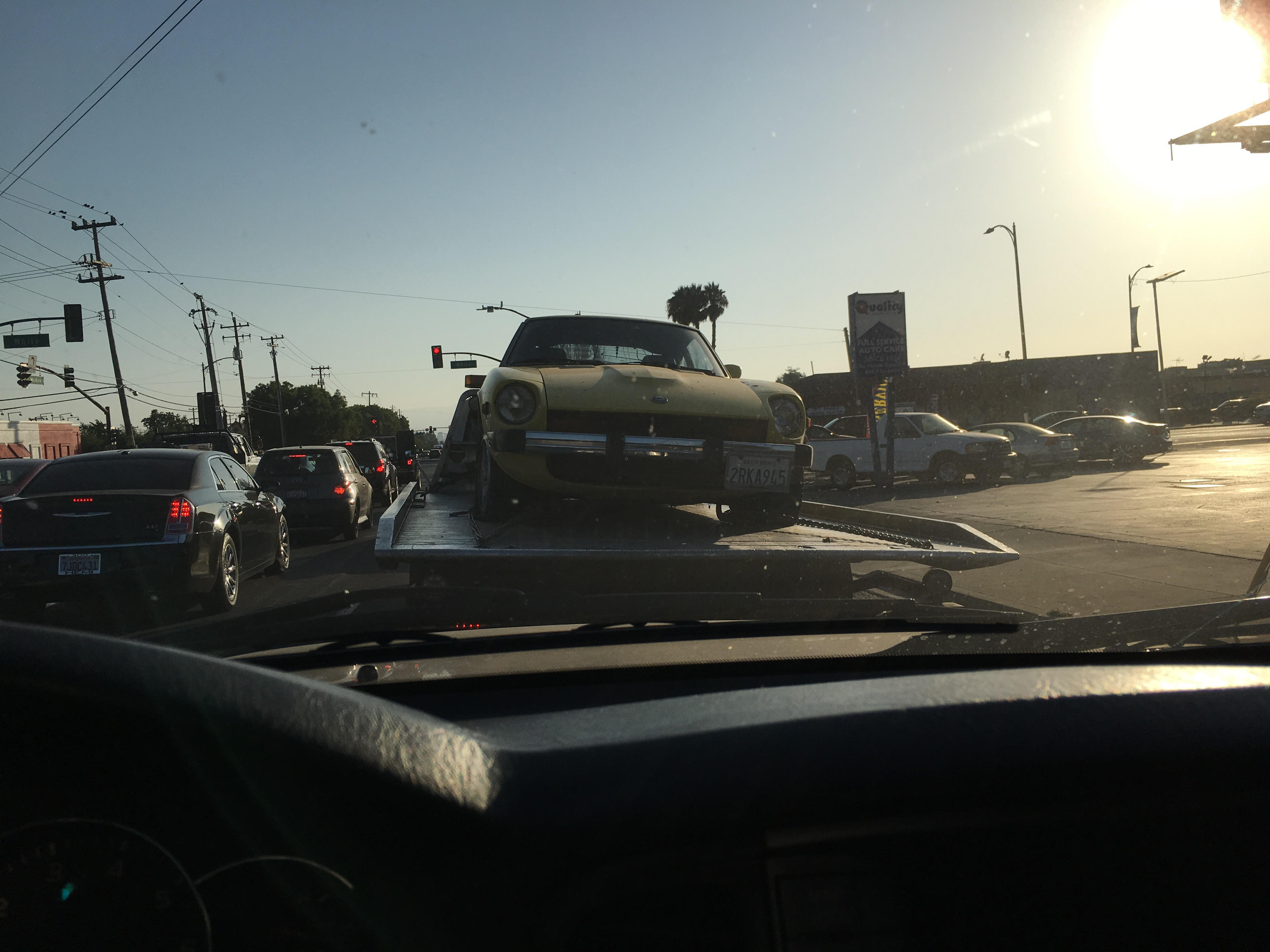

Hey Buddy - coming over weekend. I actually unloaded the car at my mechanic and the tires were so gone it is right now on 4 crutches. I am getting the wheels today powder coated, will share some pics once
she is on 4 wheels :)
This is one I have at the moment...
