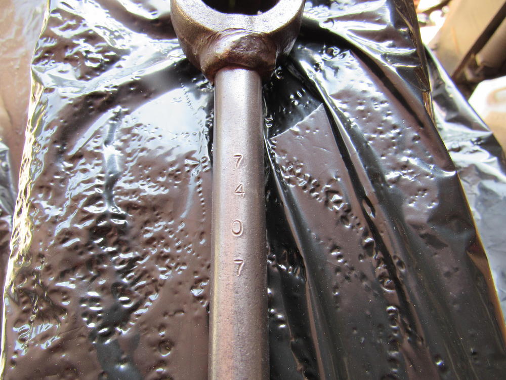

Not a burning mystery, just wondering if anyone has noticed these stamped numbers on the steering shaft and what they might signify?
1st pic is off the 77 280Z, 2nd and 3rd pics are off  two different 72 240Z's,

I don't even have a theory on the numbers. Not a part number, not a test number. Code for a date, but the third picture isn't four digits???
PS:Sorry for the thread jack
It's obviously making the data fit the theory, but if forced, I could still believe they are date codes... Reversing the numbers and reading from bottom to top:
7047 could be 7/4/77
6212 could be 6/21/72
491 could be 4/9/71
Like I said, probably making the data fit a theory, but that's all I got.   :geek:
491 could be 4/9/71
By George, I think he's got it.
