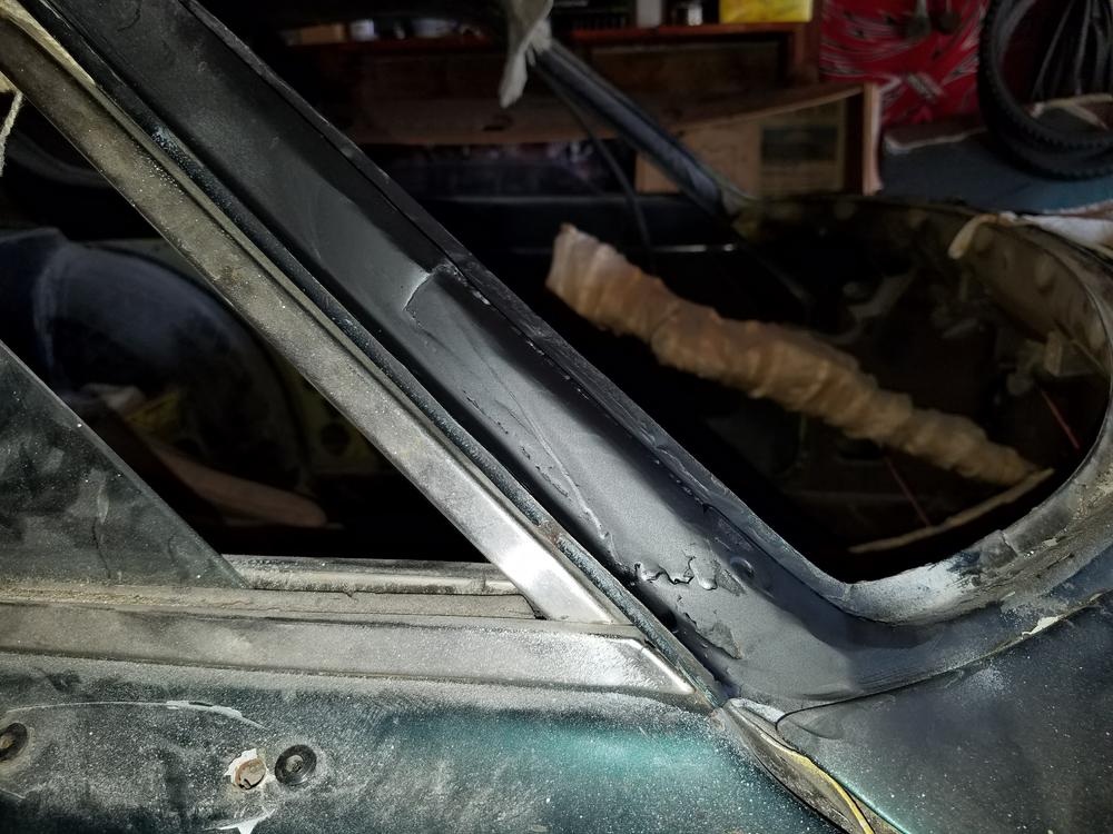

Be sure and check the lead joints at the roof really well. There can be little cracks there that show up in the paint later. Be careful that is real lead there and at the bottom of the windshield. Sanding it can be hazardous! You don't want lead poisoning!

One is on each side of the windshield near the bottom. The other two are near the upper corners of the hatch, above the quarter glass where the factory roof seams are
Right here. You can see the texture difference where the "A" pillar meets the base of the windshield.
