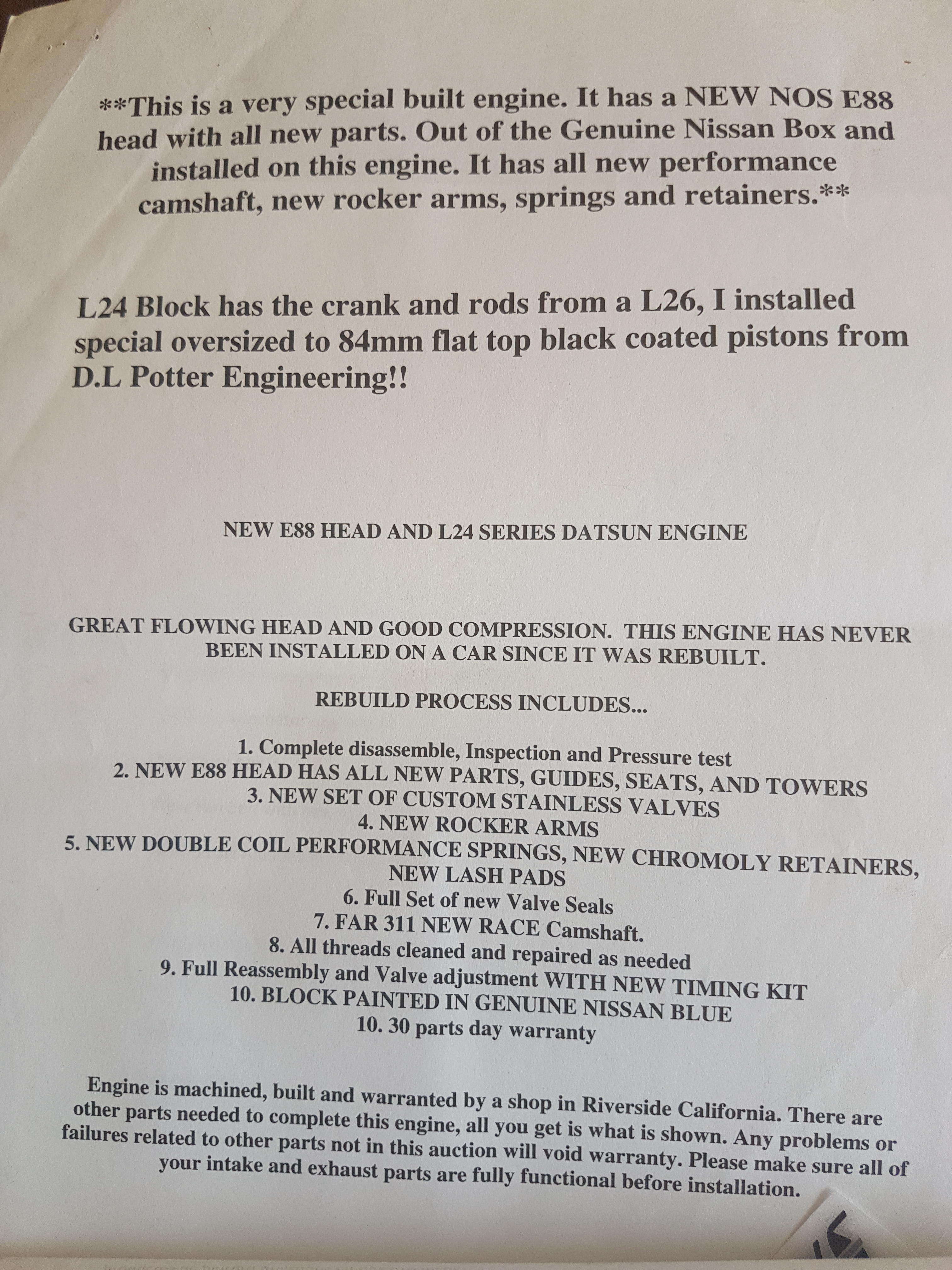

Posted January 30, 20187 yr comment_541170 In 2014 i bought a 1972 240z that carried an upgraded L24 engine as shown in the picture. However i have been struggling with the car in order to get it stable under stop and accelerate idle traffic conditions and it was not until today that my mechanic found out that the oil pressure in the car was very low and it only went up to the middle when you accelerate real fast. Once in traffic it starts dropping back. He argued that it was quite posible that the company that rebuilt the engine did not change the old oil pump during the process and that it is not pushing enough process to cover all the parts of the engine when its warm. The oil gauge has never kept the oil marker in the middle. We will try and drain the oil using 5 bottles of Castrol 20 50W engine oil and a new filter. If this does not change, ill guess ill need a High Capacity oil pump and hope that any of the engine parts were damaged http://www.thezstore.com/page/TZS/PROD/17-8021 Does the oil pressure really affects the driveability of the car? Link to comment https://www.classiczcars.com/forums/topic/59455-datsun-llc-rebuilt-engine-opinion/ Share on other sites More sharing options...
January 30, 20187 yr comment_541179 The first "Item #10" (Block painted in genuine Nissan blue) on the rebuild list you showed is probably the only thing that you can be sure was done. The fact that there's a second "Item #10" on the sheet should be a clue to the quality and thoroughness of the seller. Who, if I remember correctly, had/has a sketchy reputation. Dennis Edited January 30, 20187 yr by psdenno Link to comment https://www.classiczcars.com/forums/topic/59455-datsun-llc-rebuilt-engine-opinion/#findComment-541179 Share on other sites More sharing options...

January 31, 20187 yr comment_541208 Reading that paper makes me sick. It is filled with fluff, bs, and poor grammar/English. They are too dumb to even be successful crooks. Link to comment https://www.classiczcars.com/forums/topic/59455-datsun-llc-rebuilt-engine-opinion/#findComment-541208 Share on other sites More sharing options...
