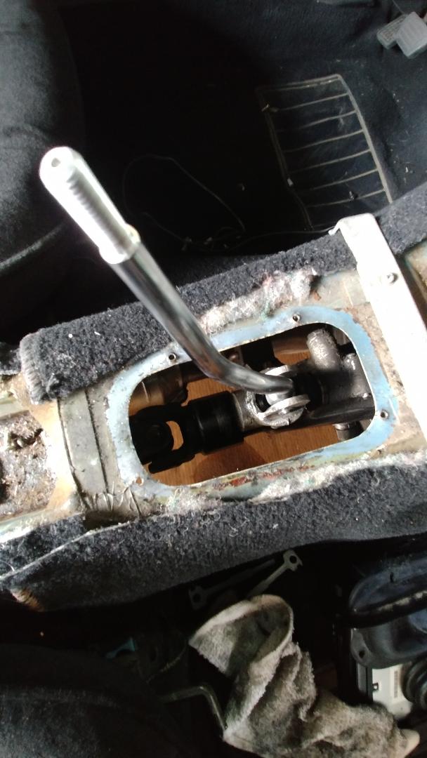

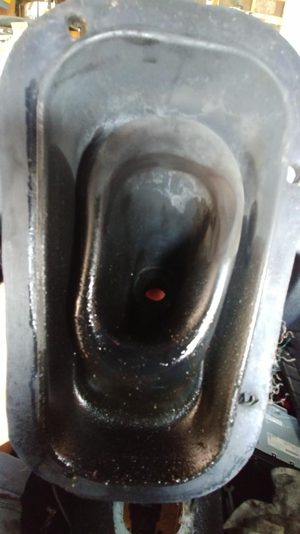

Okay so I pulled the center console and removed the shift boot and tunnel cover. Saw that I put the pin in backwards. Reversed it and looked around, saw nothing that looked out of the ordinary. Took it for a drive and no noise. Couldn't be that simple. Put it back together, took it for another drive and the noise is STILL there. I have no idea what it could be. The shifter is tight, no slop of any kind. Nothing comes in contact with the shifter, under console, that I can see. It is coming from the shifter for sure. All I have to do is apply very light pressure and it goes away. Maybe with the oil on the shift boot there is something internally going wrong? See pic. Any ideas?
If you have the ZX stick then the internal components or bottom nylon cup could be worn and causing the rattle.
Try shimming the spring as a first step.
I know you said it's not the knob, but just to make sure... Take the knob off while it's making the noise and see what happens?
I packed the cup on mine with grease also the hole it sits in, no noise but as a preempted strike.
That's an oily inner boot.  Mine are dry rotted and cracking?
