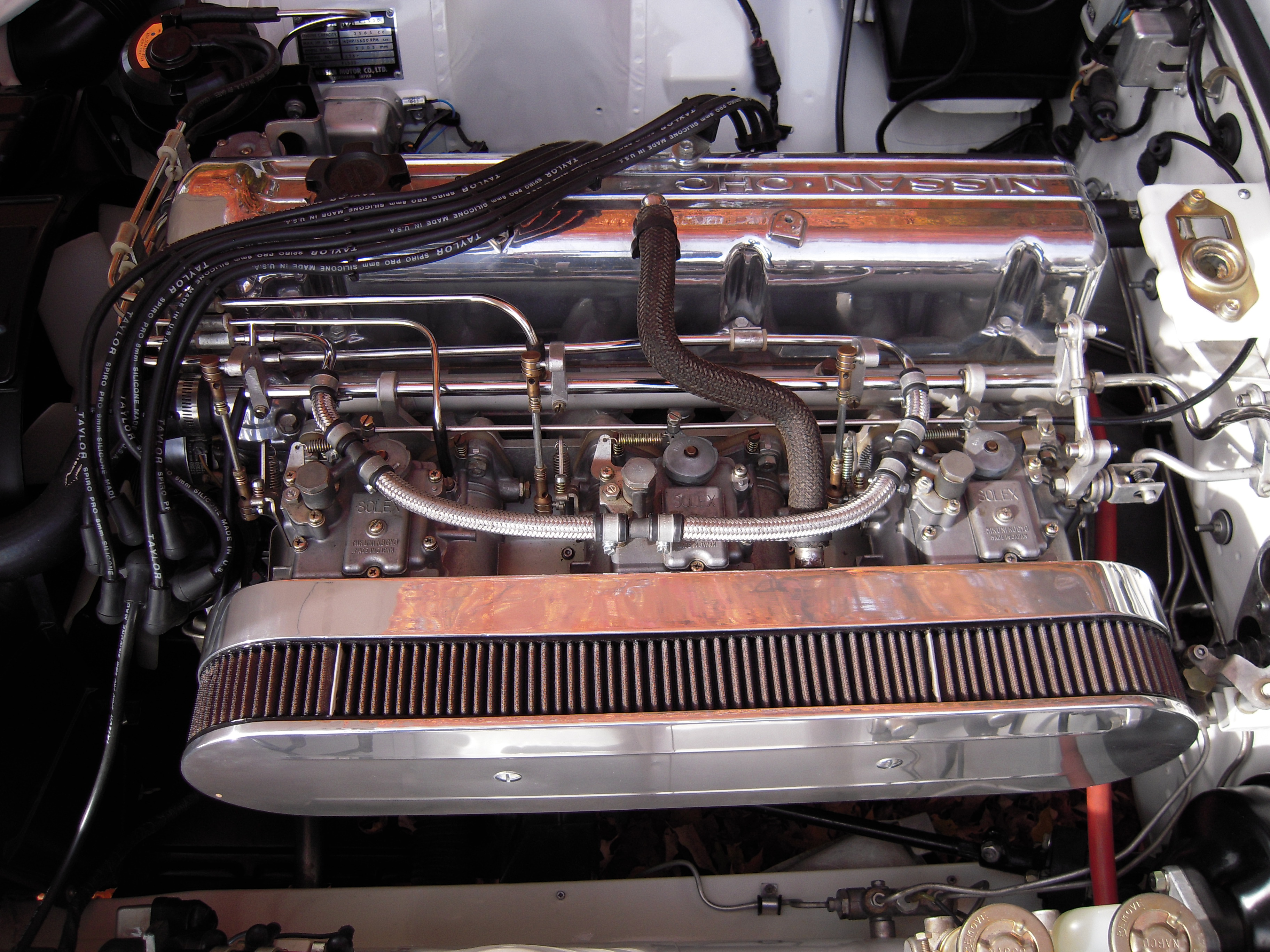

If you look at the ITG fiberglass or CF boxes they have a taper to them that speeds the flow up as it moves towards the rear carb. A non-tapered box could end up having you jet each carb differently. Depending on the box you would need to select a shorter velocity stack.

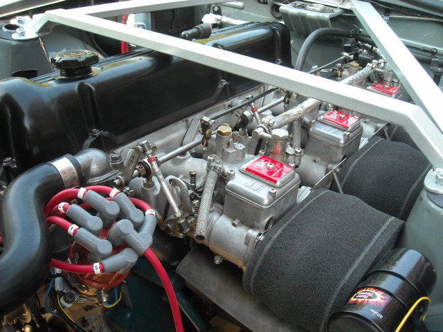

A foam full length ITG filter out performs the ITG box (based on dyno runs@Rebello's shop).

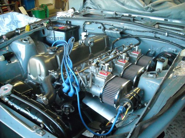

If you jet without an air filter, then add  one that  is restrictive, it  will act like an old fashion choke and move the manifold vacuum further up the throat of the carb and cause richness.
Make sure your filter flows freely and check a/f after adding.
