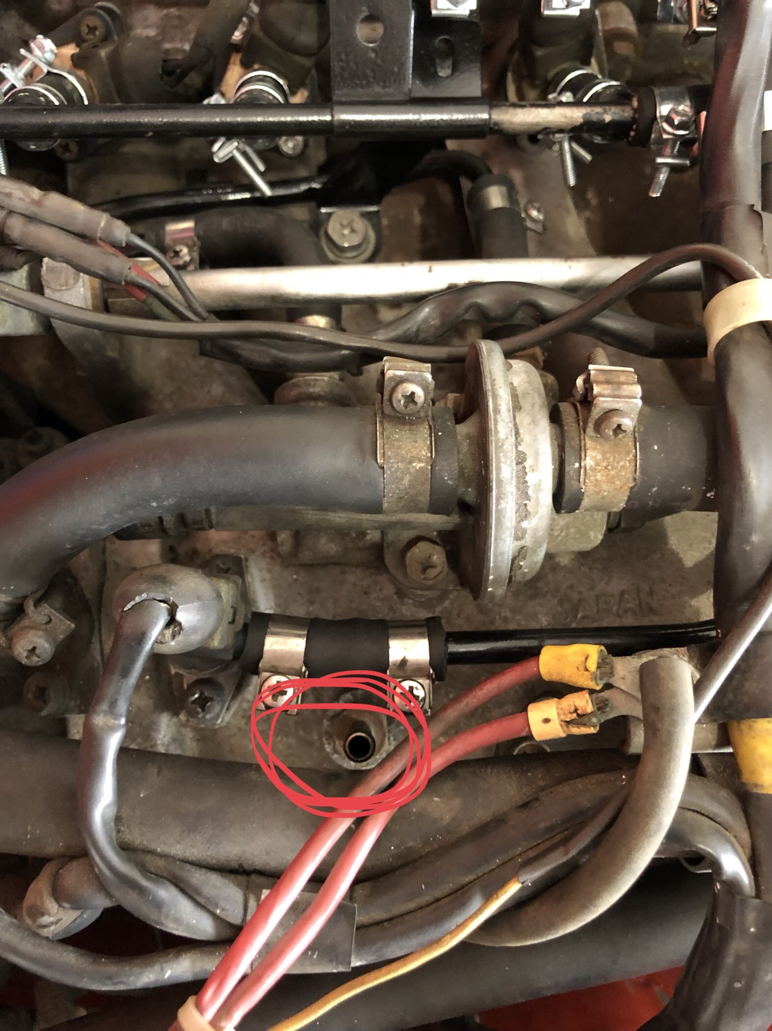

Finally, I have need help with something on the intake manifold. There is small connection that I don’t know where it is supposed to go. See photo. When I try and start the car it spits air out this hole. When I putting starting fluid in there my assistant said a blue flame shot out of this hole. Any ideas what’s supposed to be attached here?

That's a vacuum port for the charcoal canister.  It should be sealed if it's not connected to the canister.
The blue flame is from a backfire in to the intake manifold.  That would be from either running lean (big vacuum leak) or a timing problem.  Find or make a plug for it, squirt some fluid in there, seal it up, and try to start it.  It's a pretty big vacuum leak if it's open.  It might start and run.
See that vacuum hose just to the right of that intake port? It looks like the vacuum hose that's supposed to be connected there. You might want to look at that. I'm pretty sure thats the hose.
Edited by rcb280z
ZH, thanks.  I found that hose to the canister.

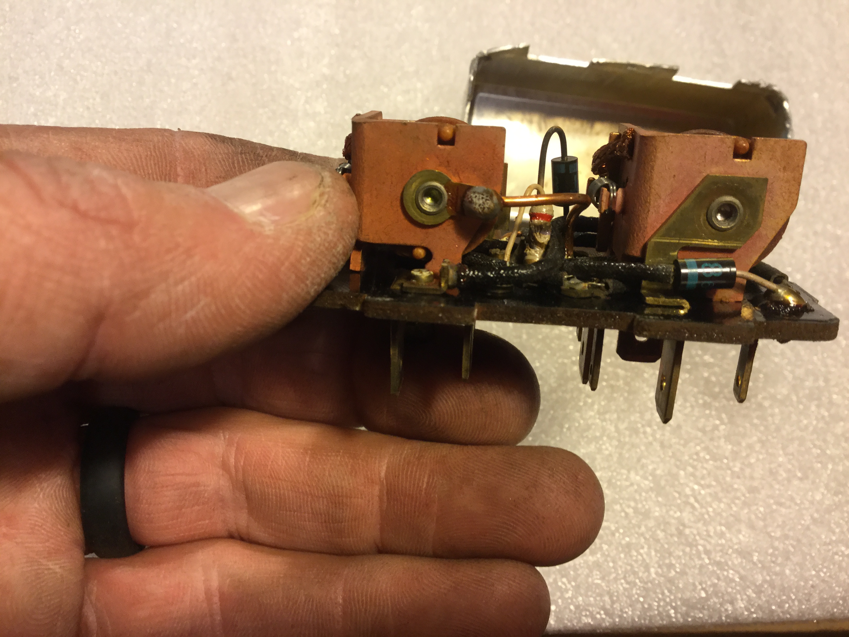

I just pulled the power relay off..  Is there a way to test this off the car?  Here some close ups of it.

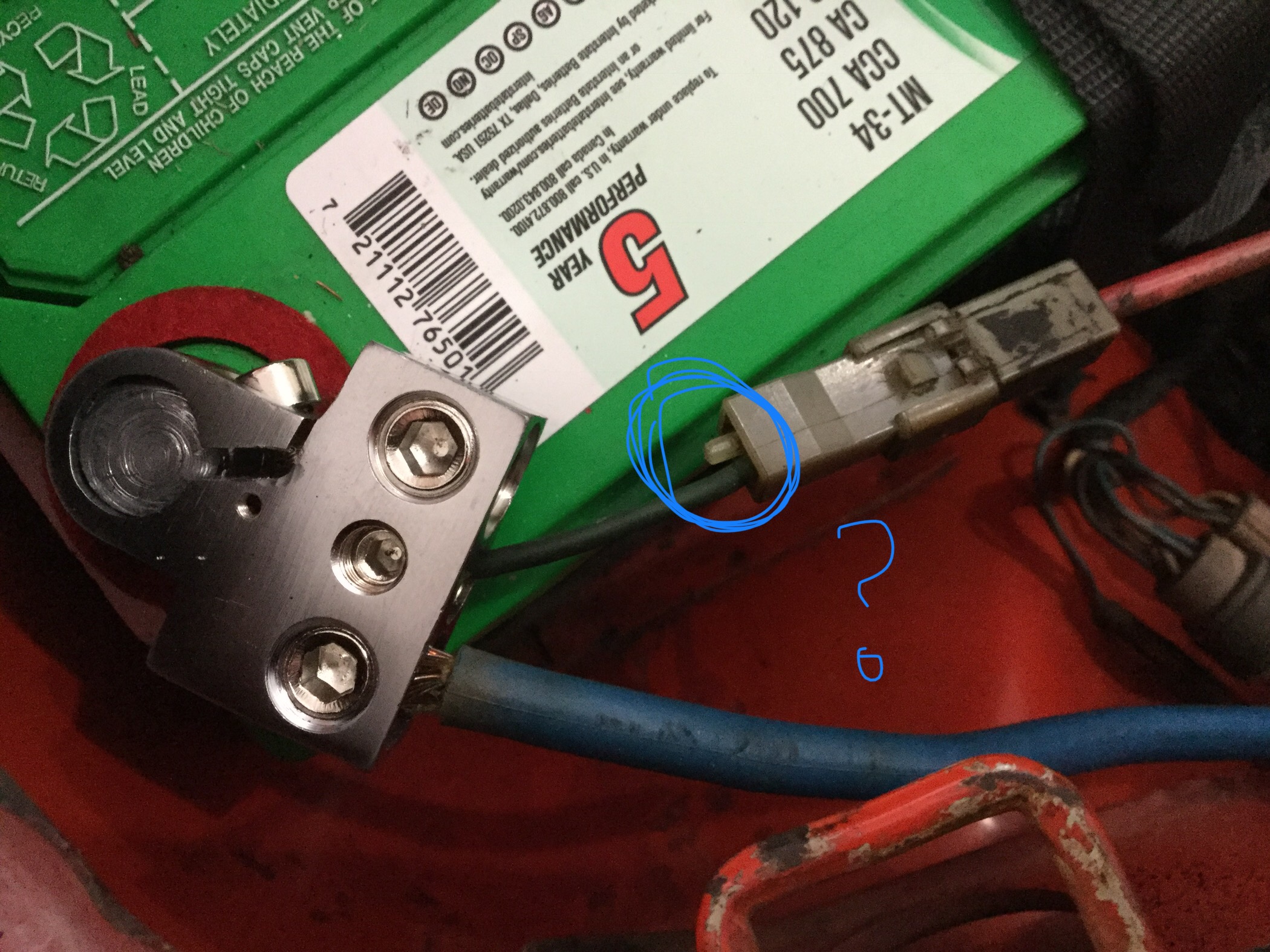

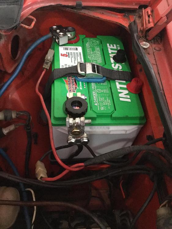

On a side note.  I discovered I had some battery connection problems.  The two red wires coming from the fire wall were both connected to the positive terminal, looking at the cars wiring diagram one is supposed to go to negative and the other the positive. My battery positive side fuse link had one of the two wires cut,  I don’t know why there are two small wires from that connection but I connected one back to the positive.  Does this look right now?
