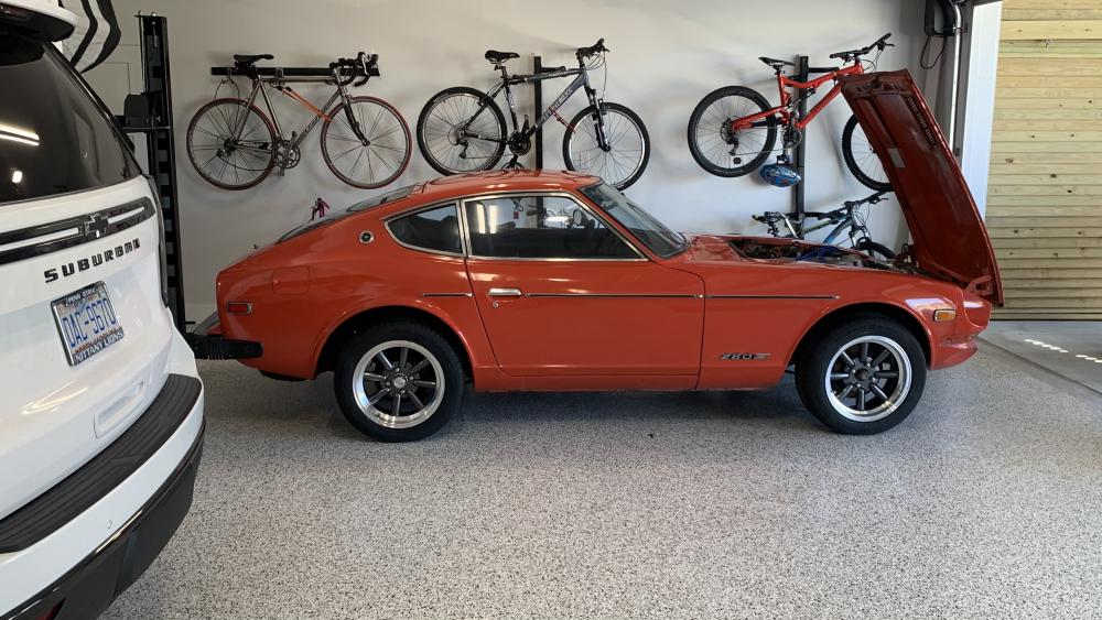

Your ride is sweet.  I’ll look at those links you sent.  I did replace one of the fusible links that was broken, forgot to mention that.

Good looking car!  Thanks on my 240 too, '77 280 runs like a new one but has old faded paint.
