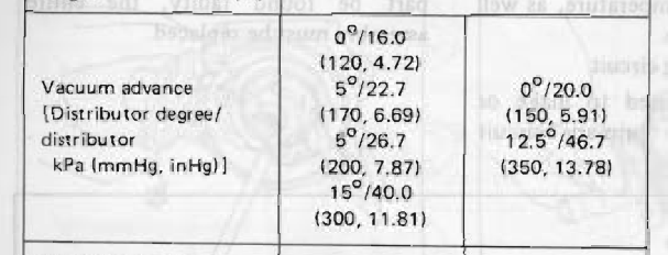

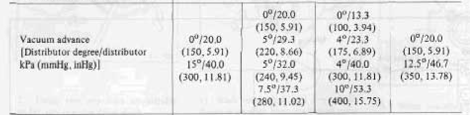

December 28, 20177 yr comment_538435 The vacuum advance goes away at any sizable throttle opening. As soon as the the blade opens and intake vacuum drops the advance won't come back until engine RPM increase. So part-throttle acceleration would see a difference but it goes away as you press the pedal farther. All I'm saying is that my math doesn't add up to the lack of timing advance itself as the problem. Maybe the mechanical advance is stuck also. I don't see any timing light info. I just went back through the whole thread and see the things I missed. But, basically, it's an engine with a hesitation at some unknown level of acceleration, and a hole in the vacuum advance canister. That's really all that we're working with. A little work with a timing light would be illuminating. I found the old ZX canister. It's from an 81 2+2 so should have up to 15 degrees. Looks like some sort of two-stage system. Could also be an 80 unit (it had 1980 transmission). Which has even more possibilities. The 80's was the emissions era. Link to comment https://www.classiczcars.com/forums/topic/59224-hesitation-during-acceleration/?&page=2#findComment-538435 Share on other sites More sharing options...
