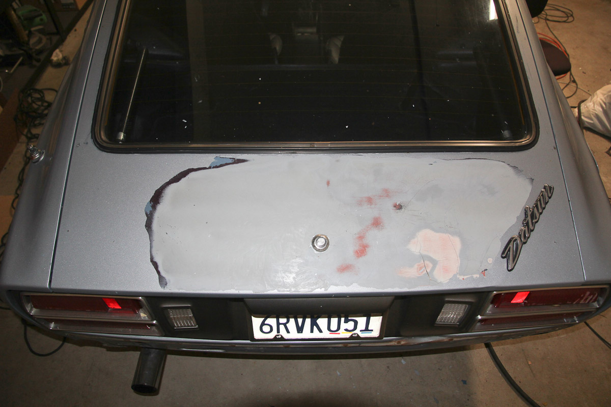

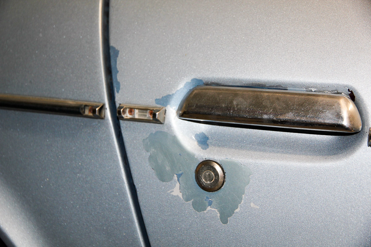

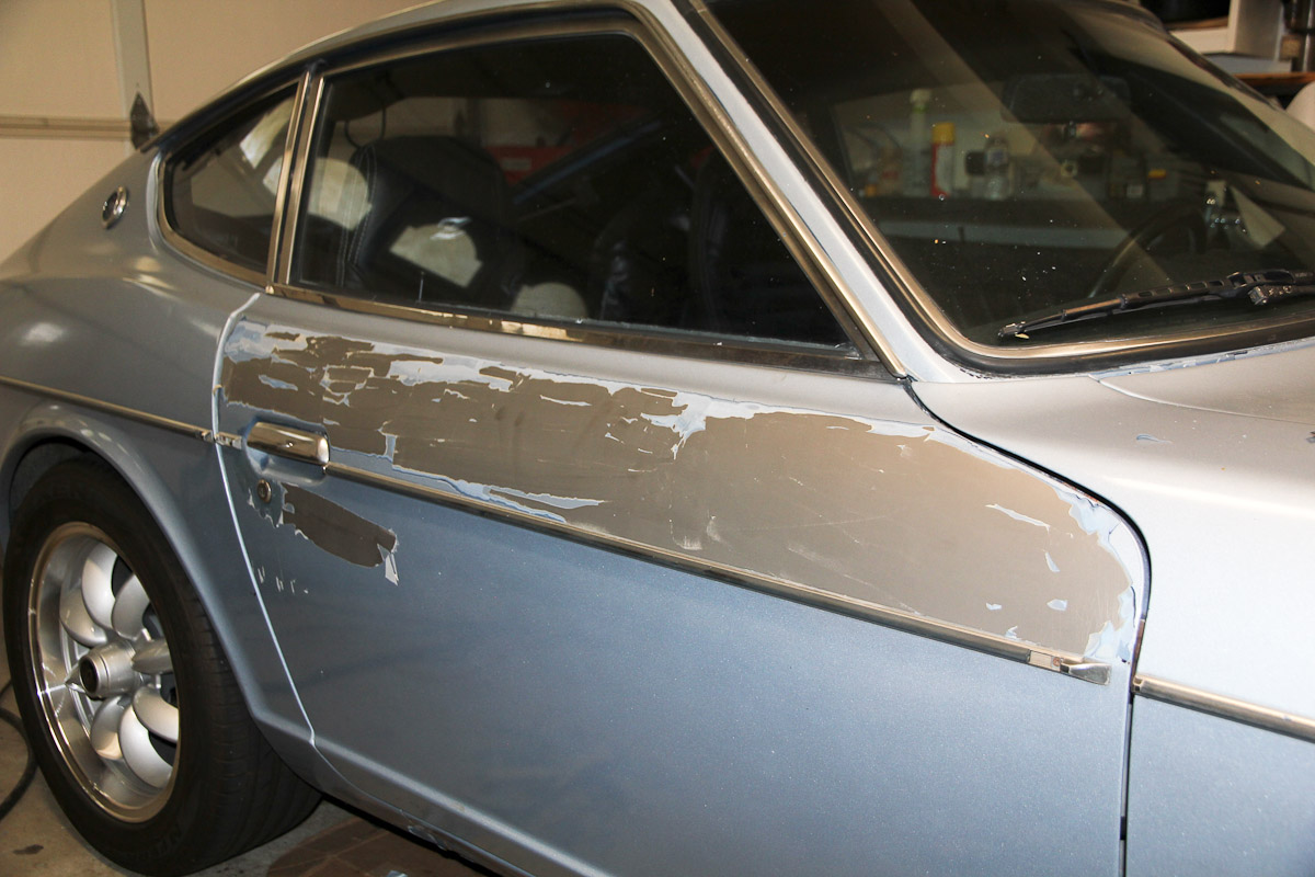

November 22, 20177 yr Author comment_535581 I saw a loose thread and pulled on it...a couple minutes with the air compressor and a razor blade and this happened. Guess I'm in it now! Link to comment https://www.classiczcars.com/forums/topic/59000-thinking-about-tackling-body-and-paint-advice/?&page=2#findComment-535581 Share on other sites More sharing options...
November 22, 20177 yr comment_535600 You have your work cut out for you now. All of that paint has to come off if it peels that easily... Link to comment https://www.classiczcars.com/forums/topic/59000-thinking-about-tackling-body-and-paint-advice/?&page=2#findComment-535600 Share on other sites More sharing options...
November 22, 20177 yr comment_535606 I had the same problem with paint on my 260. I used a HF wood chisel to scrape it off. I was amazed how well it worked. Using light pressure, the paint flew off in a cloud of fine chips. Use eye protection. Paint chips are sharp. Link to comment https://www.classiczcars.com/forums/topic/59000-thinking-about-tackling-body-and-paint-advice/?&page=2#findComment-535606 Share on other sites More sharing options...

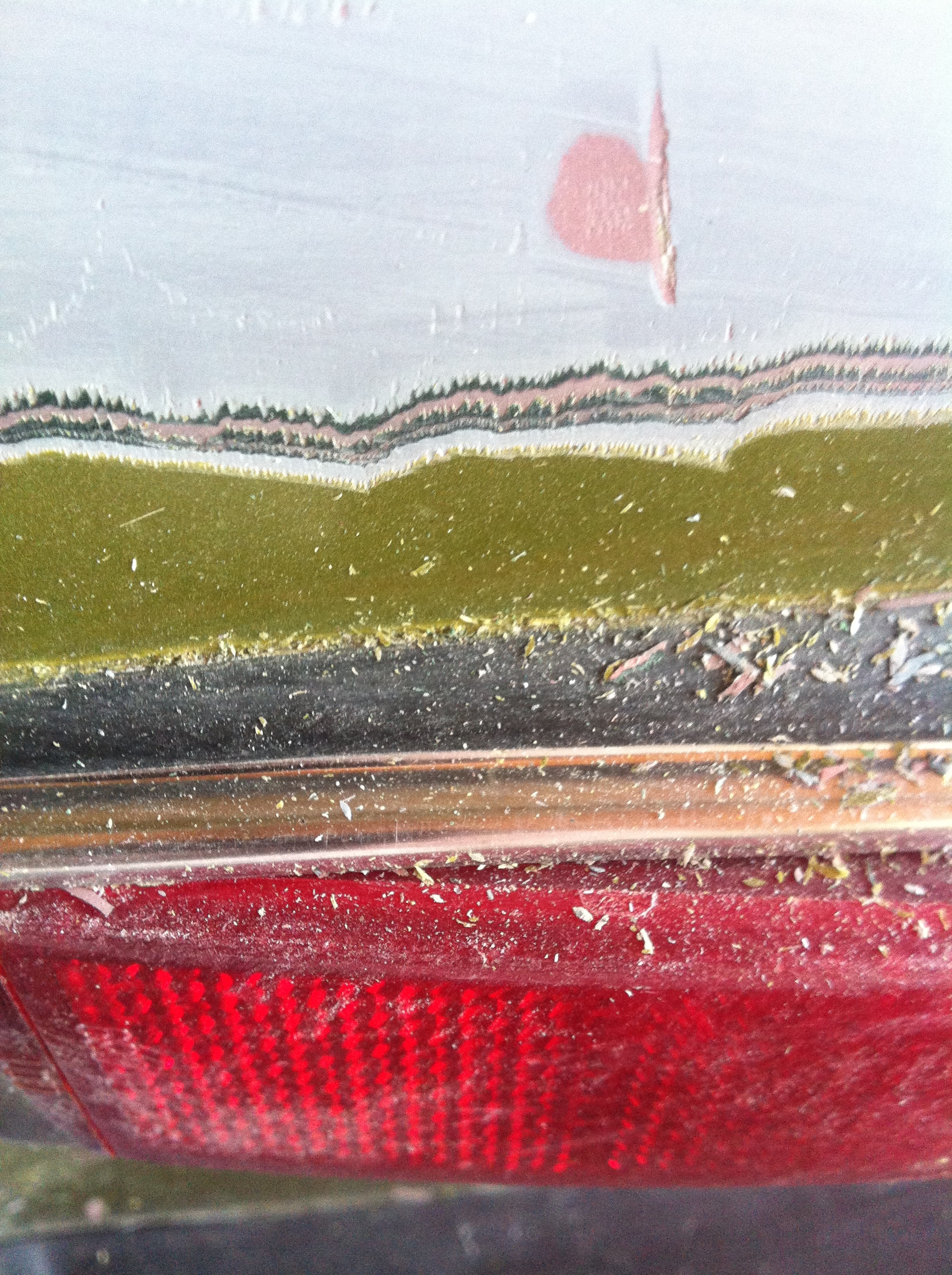

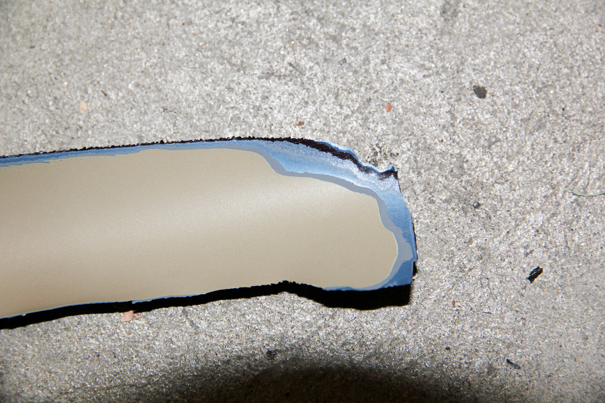

November 22, 20177 yr Author comment_535616 I tried a heat gun and razor blade last night, and it seems pretty effective so far, at least for the big flat areas. Wife came down after her shower; she thinks I'm crazy. I count three layers of blue, and assume the first is the factory paint, so two resprays. Kind of surprised it wasn't more. Link to comment https://www.classiczcars.com/forums/topic/59000-thinking-about-tackling-body-and-paint-advice/?&page=2#findComment-535616 Share on other sites More sharing options...
November 22, 20177 yr comment_535620 Mine was five coats... original, respray same colour, respray same colour, respray same colour, then respray puke gold. I went down to bare metal. I also found two donor panels from another car under all the bondo and paint. Link to comment https://www.classiczcars.com/forums/topic/59000-thinking-about-tackling-body-and-paint-advice/?&page=2#findComment-535620 Share on other sites More sharing options...

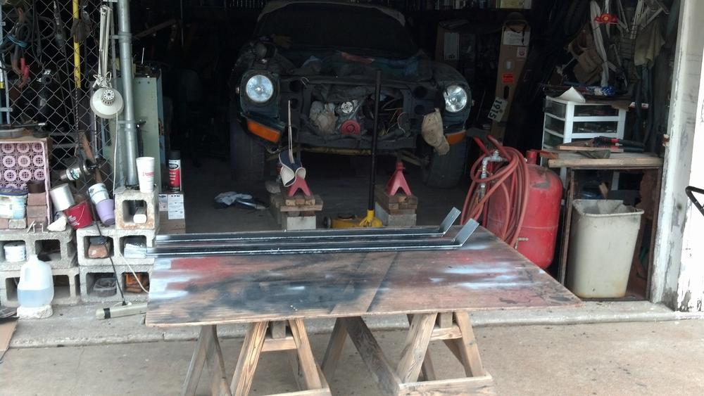

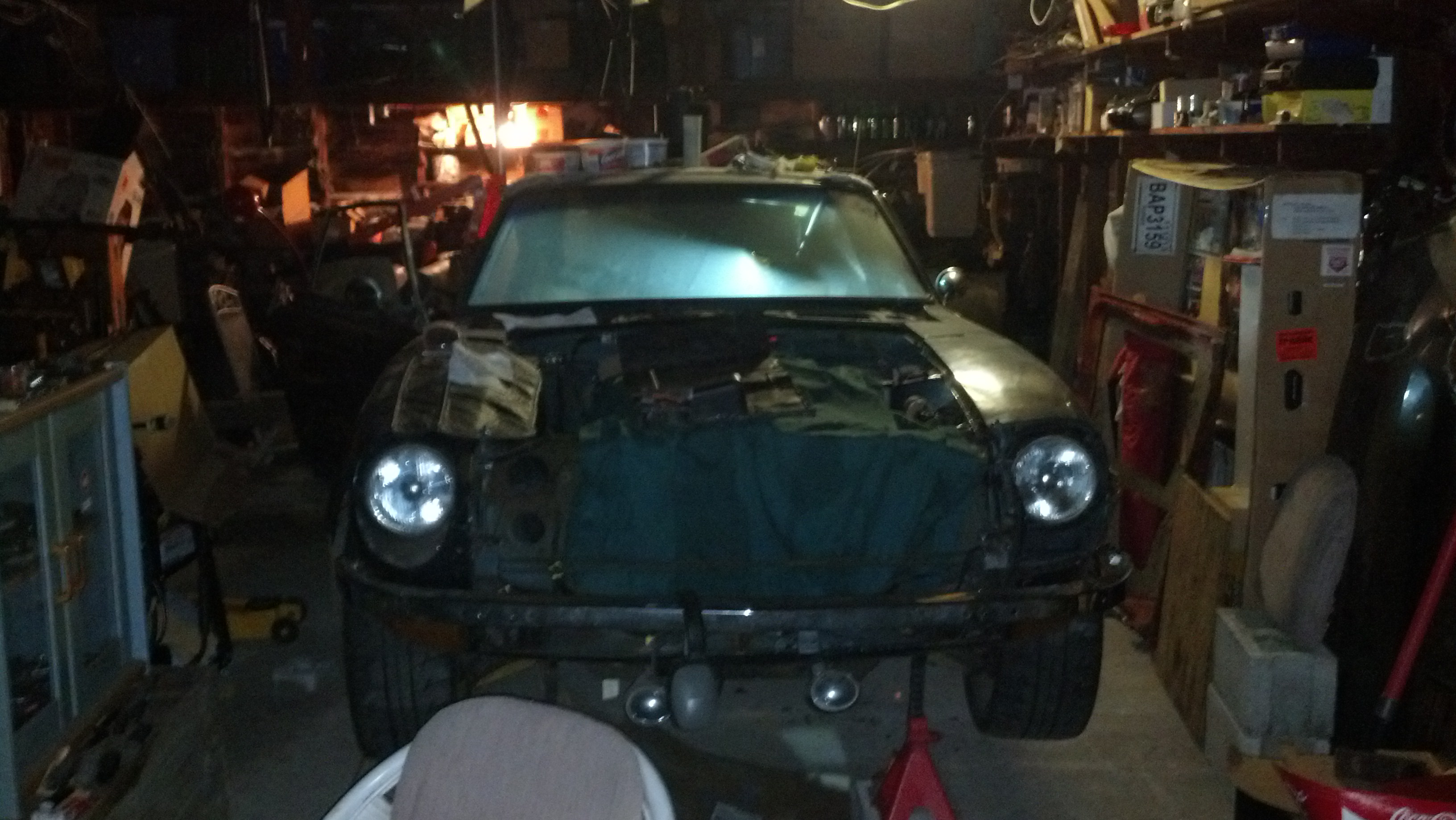

December 5, 20177 yr comment_536673 On 11/18/2017 at 11:18 PM, wheee! said: And multiply your budget by 5.... ask me how I know... Multiply your time line by a factor of 5 also, ASK ME HOW I KNOW! The car below had a main harness fire in 2005 and I am still working on it. It might take six months just to find everything that needs attention. You could spend 2K on supplies alone. If you use it everyday multiply your fix time even longer. I too have a small garage but I make the most out of my space. Fortunately I learned to weld when I was 16 now 59 so I am comfortable. For 1K I bought a Lincoln 190C. Works great and doesn't take much space. The best thing it is argon gas mix. No need for flux core. Maybe rethink your plan and figure out how much you can or want to do yourself. I held a job as a welder so I know it could take a year and lots of frustration and wasted material before you got it right. You probably have enough garage space to move the car outside to work on it. These cars can reveal a whole lot if you really look so make sure you are prepared to see. Many have walked away or sold unfinished projects. DON'T BE THAT GUY. Maybe a better plan would be to save up enough cash to have the body done by professionals. You won't be disappointed. A MAACO job is something that will look ok for about 6 months even less if the car is outside all the time. You can learn the basic steps to panel repair and prep on YOUTUBE. There is lots of step by step information out there. I you lived in Florida you could even come over and watch me complete mine just to see how involved something like this can turn out to be. In 2005 I was thinking no more than a year. Well if my math is right..........! Anyway reaccess what you want to end up with. Done right now means never having to do it again. Link to comment https://www.classiczcars.com/forums/topic/59000-thinking-about-tackling-body-and-paint-advice/?&page=2#findComment-536673 Share on other sites More sharing options...
