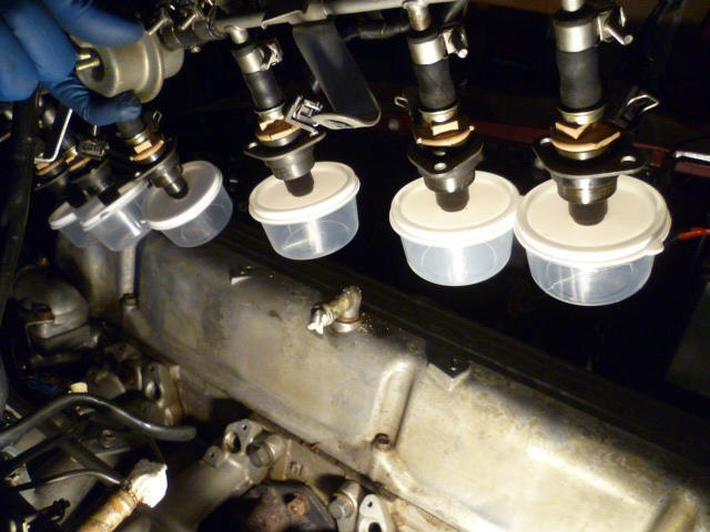

August 28, 20177 yr comment_529053 3 minutes ago, Dave WM said: I have a pressure vessel that is used for flushing AC parts, I can use it with a regulated air pressure supply to supply fuel. Also have 6 injector plugs that I can wire up to activate. will use 6 separate vessels to capture flow to evaluate. Take some pictures for us, you may have found a way to make it easier. This was the easiest way for me to set the floats on my 240. Â Â Link to comment https://www.classiczcars.com/forums/topic/58407-fi-enrichment-effects-on-idle-and-vacuum/?&page=2#findComment-529053 Share on other sites More sharing options...

August 29, 20177 yr comment_529071 I put all six of my injectors on a rail with a pump then filled 6 Coke bottles with fuel.  Battery power to the pump and the injectors, with a separate switch for both.  Scary because the fuel is partially vaporized as it squirts out, especially if you try later model injectors.  Have to be aware of the wind direction, sparks, and run-away paths.  Only good for wide open but will show clogs.  The set that came with my car were way out of balance.  But the engine still ran pretty well. The idle air adjustment screw is a good idea.  Just make sure to keep track of the turns so you don't get lost wondering where your start point was.  But it will definitely have an effect.  The EFI systems were tuned for mid-1970's fuel so today's oxygenated blends probably won't idle the same, for sure.  I didn't feel bad about changing my settings at all.  It's hard to get the screwdriver head, straight blade, in the slot, but it is back there.  Use a mirror.  Backing out lets more air past the vane, so leaner, screwing in makes it richer.  It's an air passage. My intake manifold is the non-EGR N42 type.  #1 is always lean, I've swapped several sets of injectors on to it, after flow-testing them to confirm that they're balanced. Link to comment https://www.classiczcars.com/forums/topic/58407-fi-enrichment-effects-on-idle-and-vacuum/?&page=2#findComment-529071 Share on other sites More sharing options...

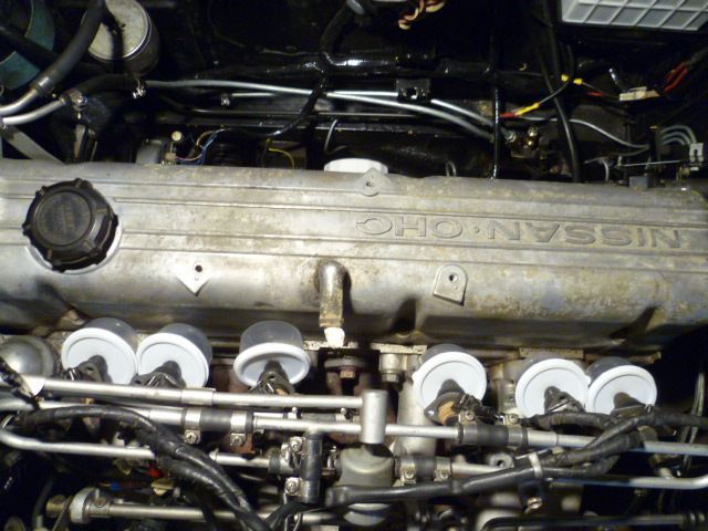

August 29, 20177 yr comment_529117 And about injector testing... I checked my injector balance a little while ago. I bought a pack of small plastic containers. I think it was an eight or twelve pack of containers from the dollar store. I used a small hole punch to cut a hole in the lid of six of them: I weighed them empty to get the tare weight. Thankfully they were all the same (at least to the resolution and accuracy of my cheapo HF digital scale) at seven grams empty: Numbered them up so I knew which was for each cylinder: Disconnected the fuel rail from the head and thankfully there was enough flexibility to get the cups onto the ends of the injectors: fired the injectors a bunch (I used a sig gen tied into the ignition system) and collected samples: Weighed them up again and verified they were the same (again to the resolution and accuracy of my cheapo HF digital scale), so I'm happy: Link to comment https://www.classiczcars.com/forums/topic/58407-fi-enrichment-effects-on-idle-and-vacuum/?&page=2#findComment-529117 Share on other sites More sharing options...

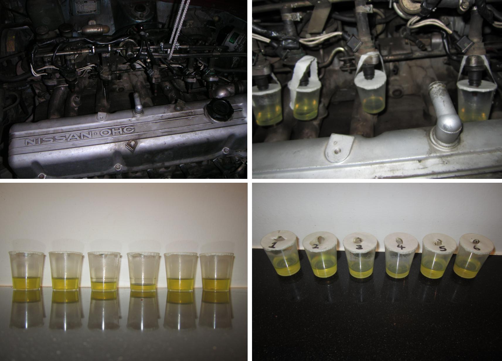

August 29, 20177 yr comment_529119 Hey Captain, That method looks firmiliar... I found number 3 and 4 injectors were cloggeed using that method by lifting the fuel rail and making a simple container with masking tape for a lid. Link to comment https://www.classiczcars.com/forums/topic/58407-fi-enrichment-effects-on-idle-and-vacuum/?&page=2#findComment-529119 Share on other sites More sharing options...
