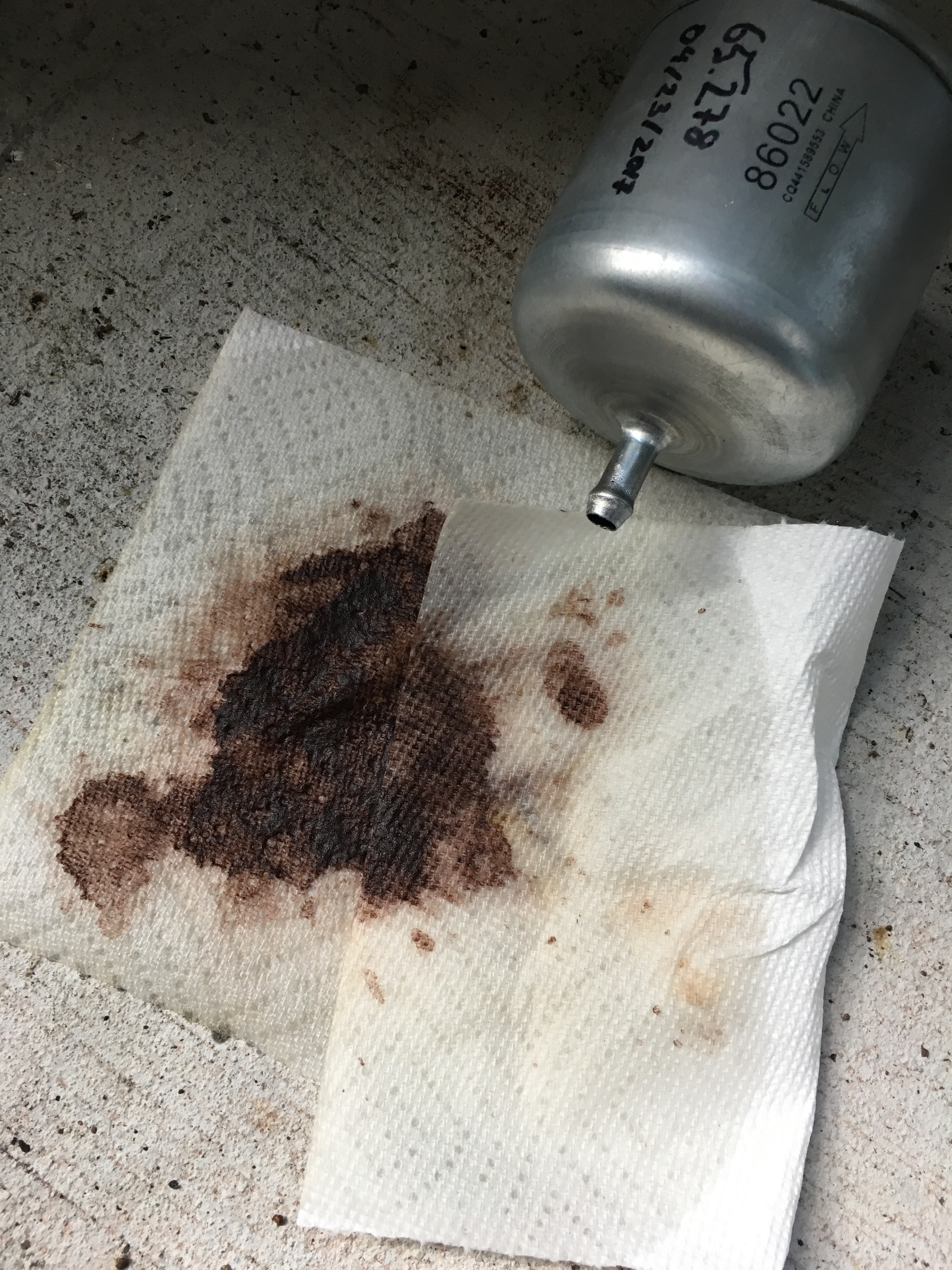

So I followed some of your instructions, although I just realized I haven't checked for leaks yet. But I did add a fuel pressure gauge and I put in a new clear filter in order to better see what's going on, so I hope this gives us a little bit more insight.

Next thing I'm gonna check for leaks with the carb cleaner spray, as I admit I completely forgot the other day, but I do suspect it will also have something to do with soot in the tank and line, mainly because of the look of the old filter.

I agree with the cruddy tank. Try a few more tank fulls but I'm thinking it needs to be cleaned. Not as hard for a 280 as a 240. Lots of us have done it so just ask and you'll get plenty of info.
i found on my tank, the tube that the fuel pump hooks to was about 95% plugged with rust. i would bet between that and your fuel line, thats your problem

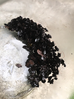

I started draining the tank through the screw at the bottom in order to blow through the line and remove any possible blocking. This is what came out with a gallon of gas.

Never seen anything like that. Looks like the bottom of a boat, barnacles. You will most likely have to drop the tank and clean and coat the inside. Cost me $50 or so on my '77. Google "Red-Kote application instructions" to familiarize your self with the procedure. It's not hard just time sensitive and will take a week to fully cure the liner. I can offer plenty of tips, I've done two so far just let me know.
Thanks siteunseen, I think I will have to do that. Right now I want to clean it enough to be able to get it out of the parking place where it is and take it somewhere where I can work on it properly. I'm guessing this might be my main problem right now. Still have to check for leaks though, haven't been able to do that yet, mostly for fear of hitting something that can catch fire without having a fire extinguisher closeby [emoji28]
