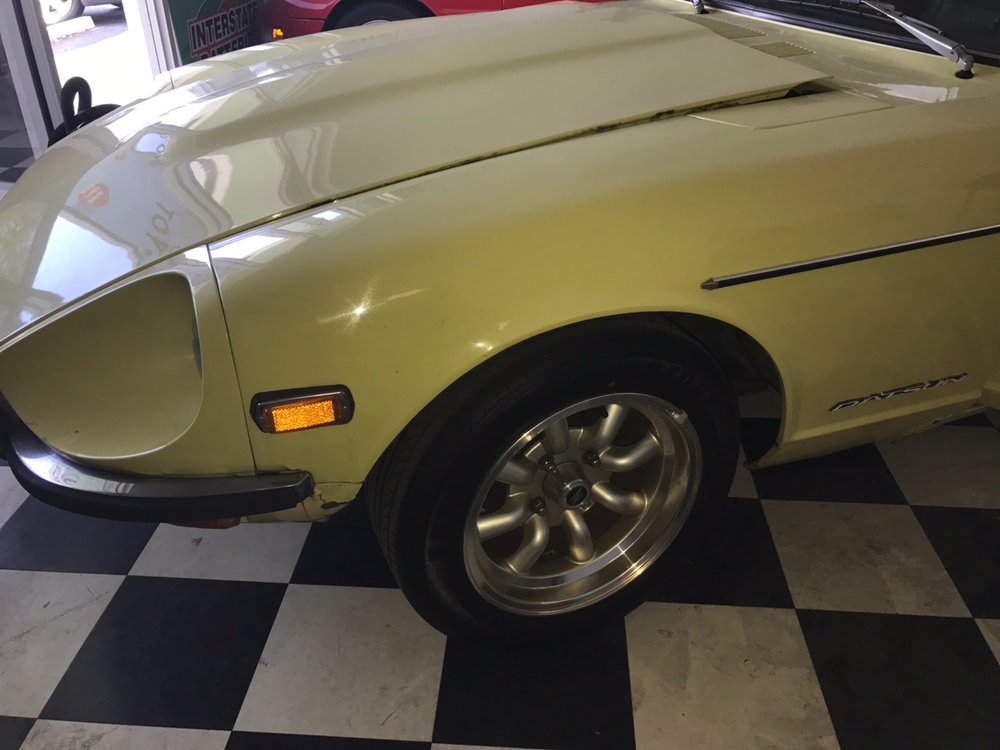

The gaps on the passenger side are off and the paint looks mismatched.  Like it's had some accident repair done.

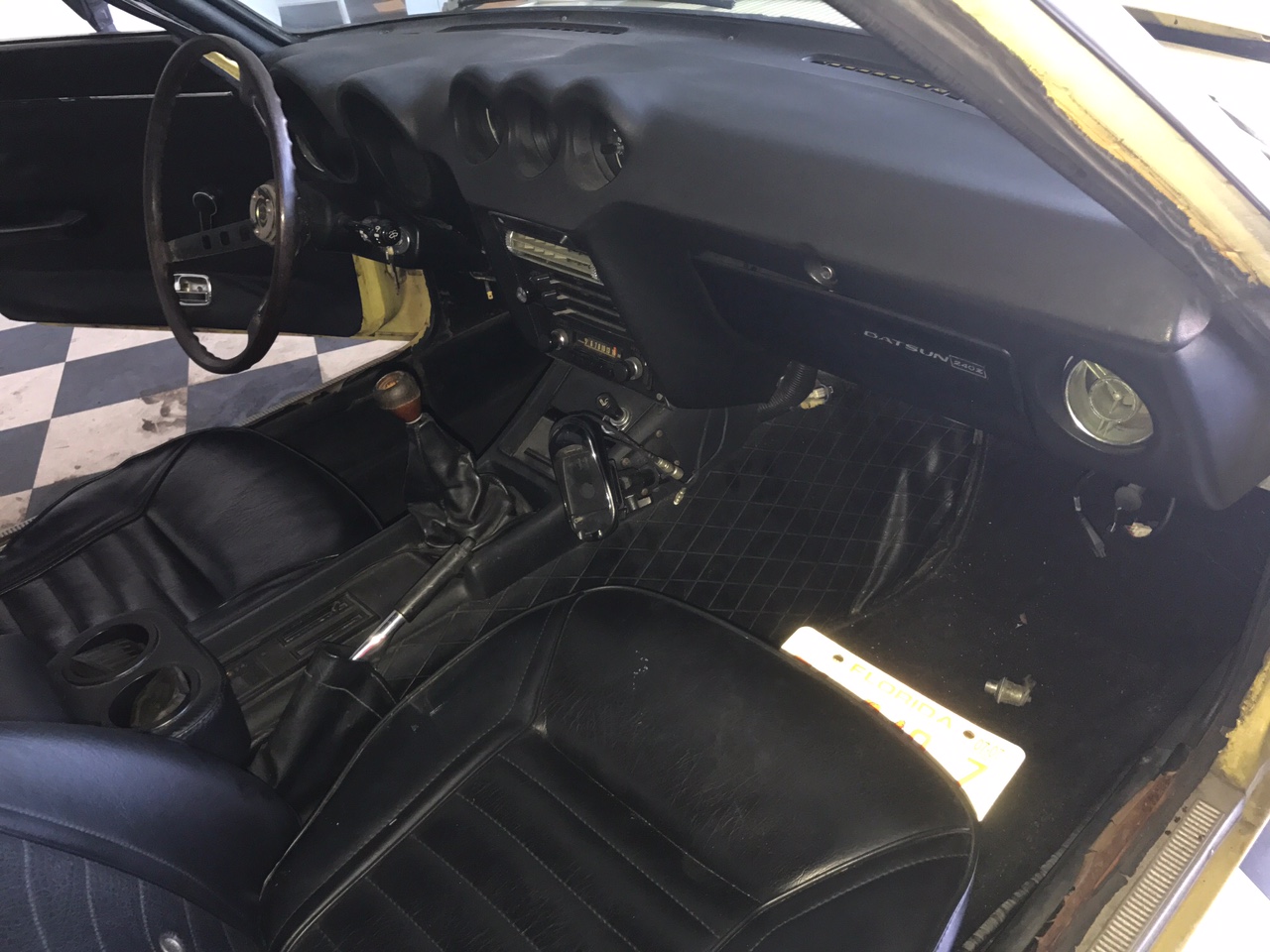

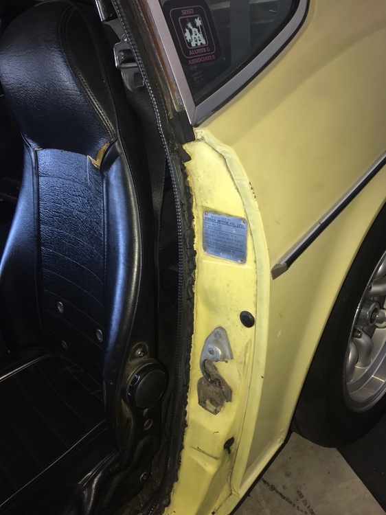

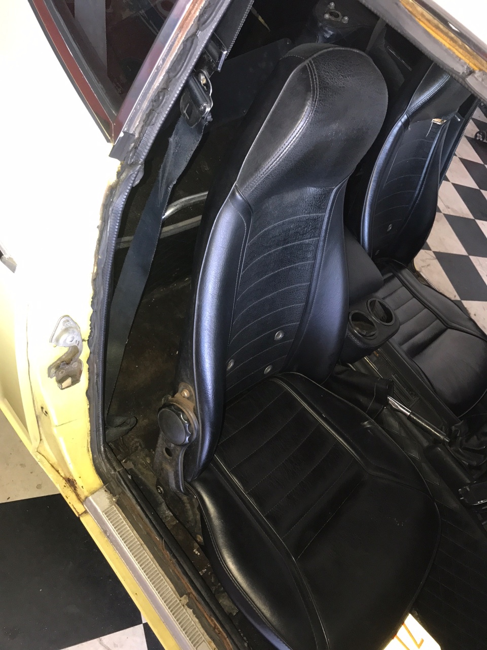

NO SIREE BOB! Could be a daily driver and car show quality after much time effort and $$$$$! If you were getting it for 5K or so you would have plenty leftover to at least get the valance below the doors and the rest of the known cancer areas squared away. This rig needs lots of metal work and if you are no good with a welder you better have plenty of $$$$$$$ to pay someone who is. Normally cars in this shape need to be completely taken apart and worked thouroughly. BTW I agree with the CRACK PIPE PRICING assessment!

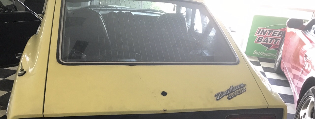

Passenger's side of the hatch is a lot tighter than the driver's side too.  Looks like a damaged car to me but if your son likes it oh well. LOL
When you see lots of visible rust coming through the paint, beware of what you don't see.  As others have said, not a $14K car.  For that money, you could do better.
