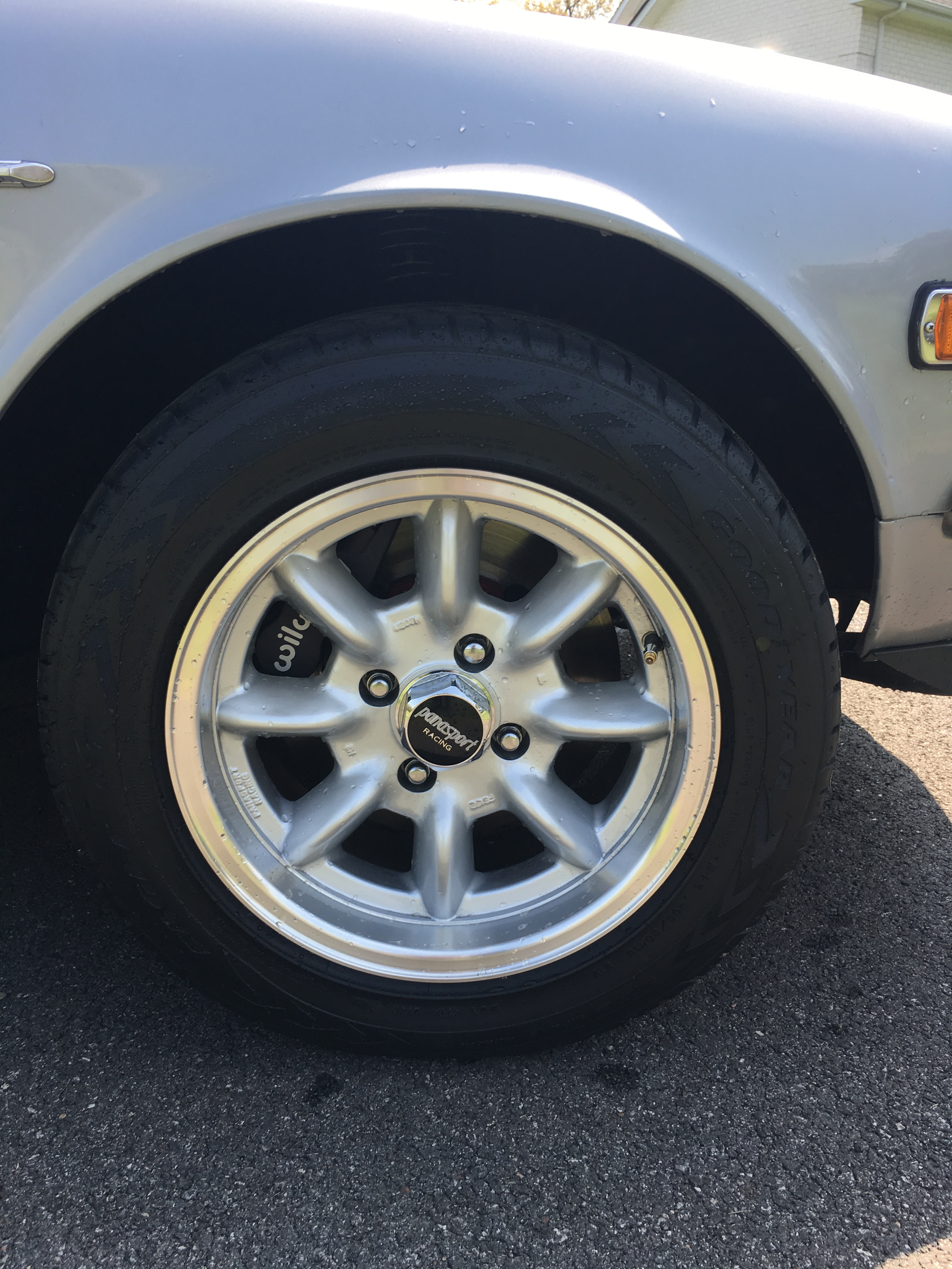

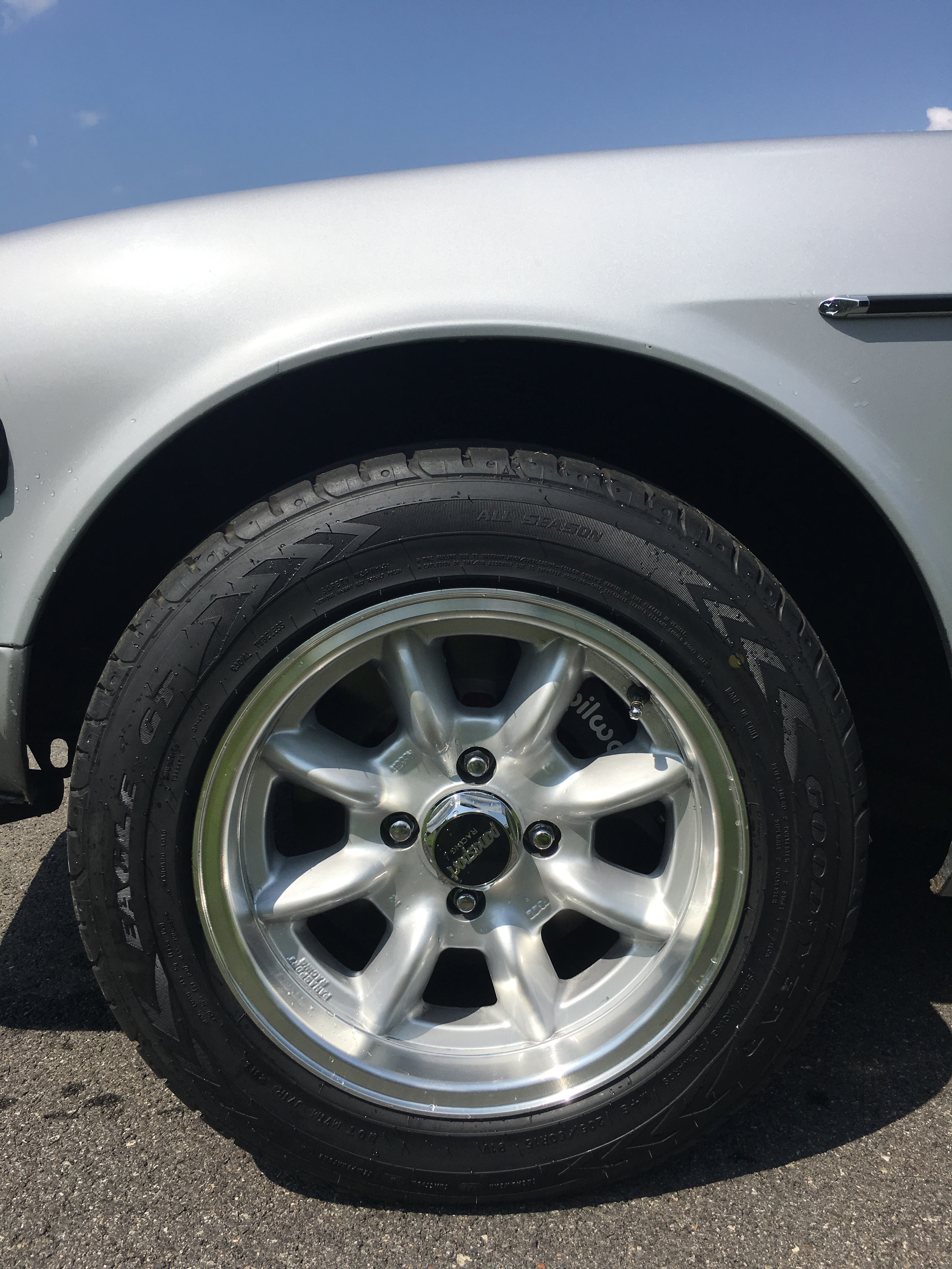

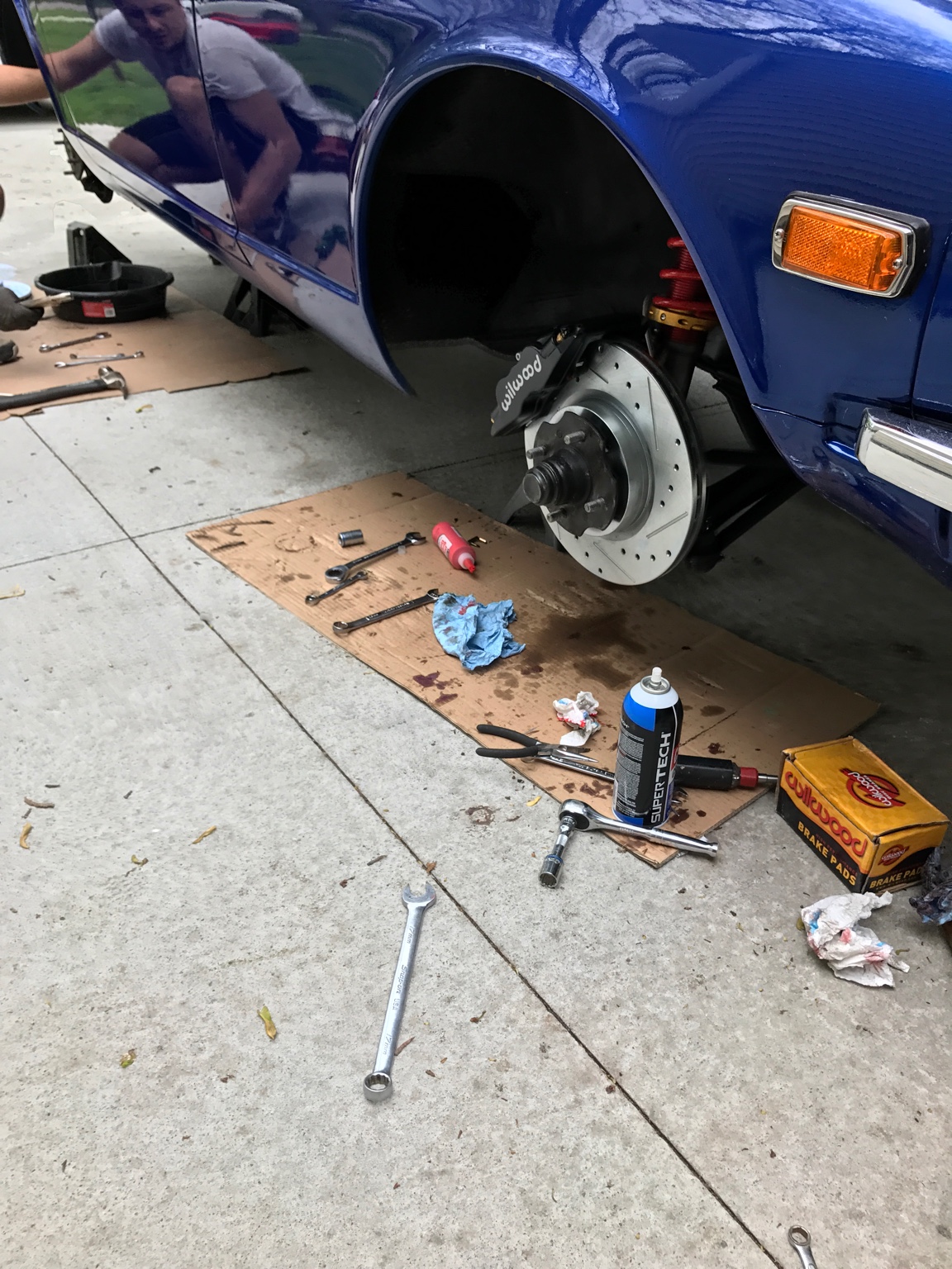

All finished with the 73......new shocks, springs, ball joints, tie rod ends, wheel bearings, Wilwoods and bushings. I really like the way she sits and handles with the new Eibachs.....car drives like new. Now the car is as fun to stop as it is to go. If anyone needs help with any of the above improvements, feel free to ask.

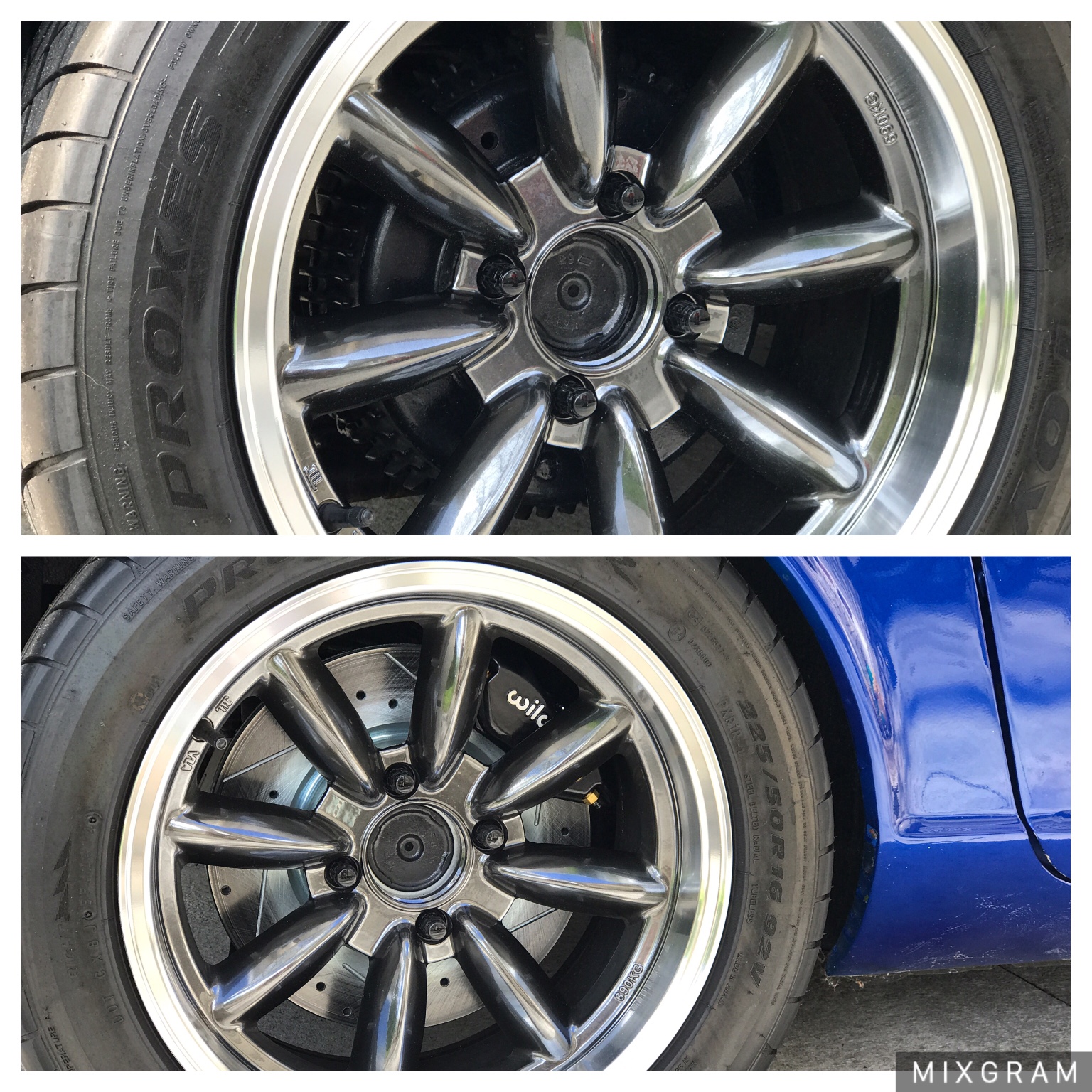

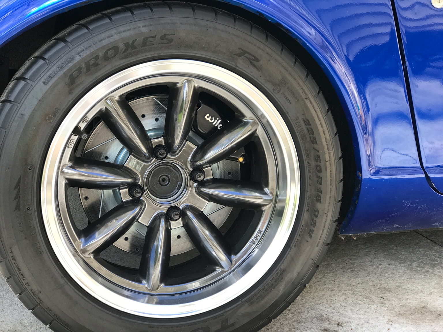

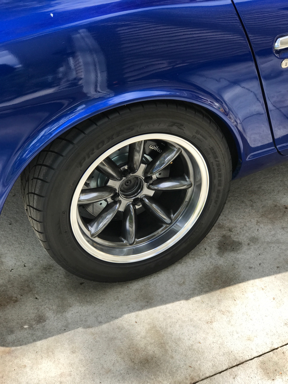

What are your wheel specs? Square or staggered? Offset?
Not staggered.
16x8 +4 offset
Need to have coilovers in front with that set up and the 225/50's I have on.
Rear is okay with regular springs with a slight rub if I hit the right bump. If you zoom in you can see where it rubs.
