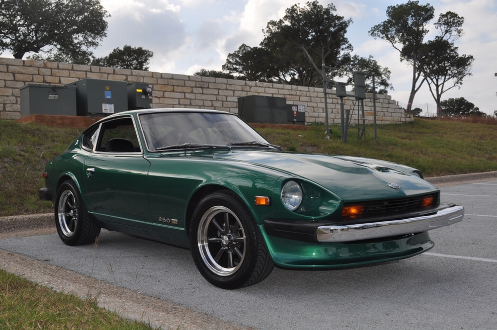

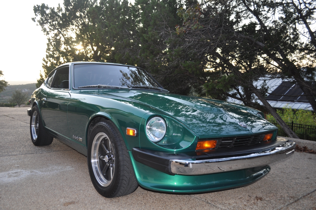

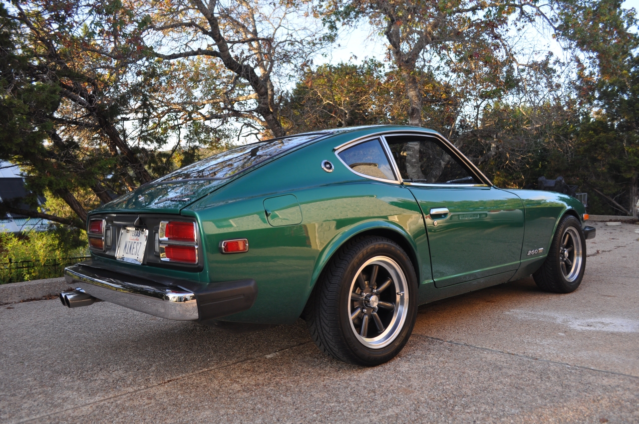

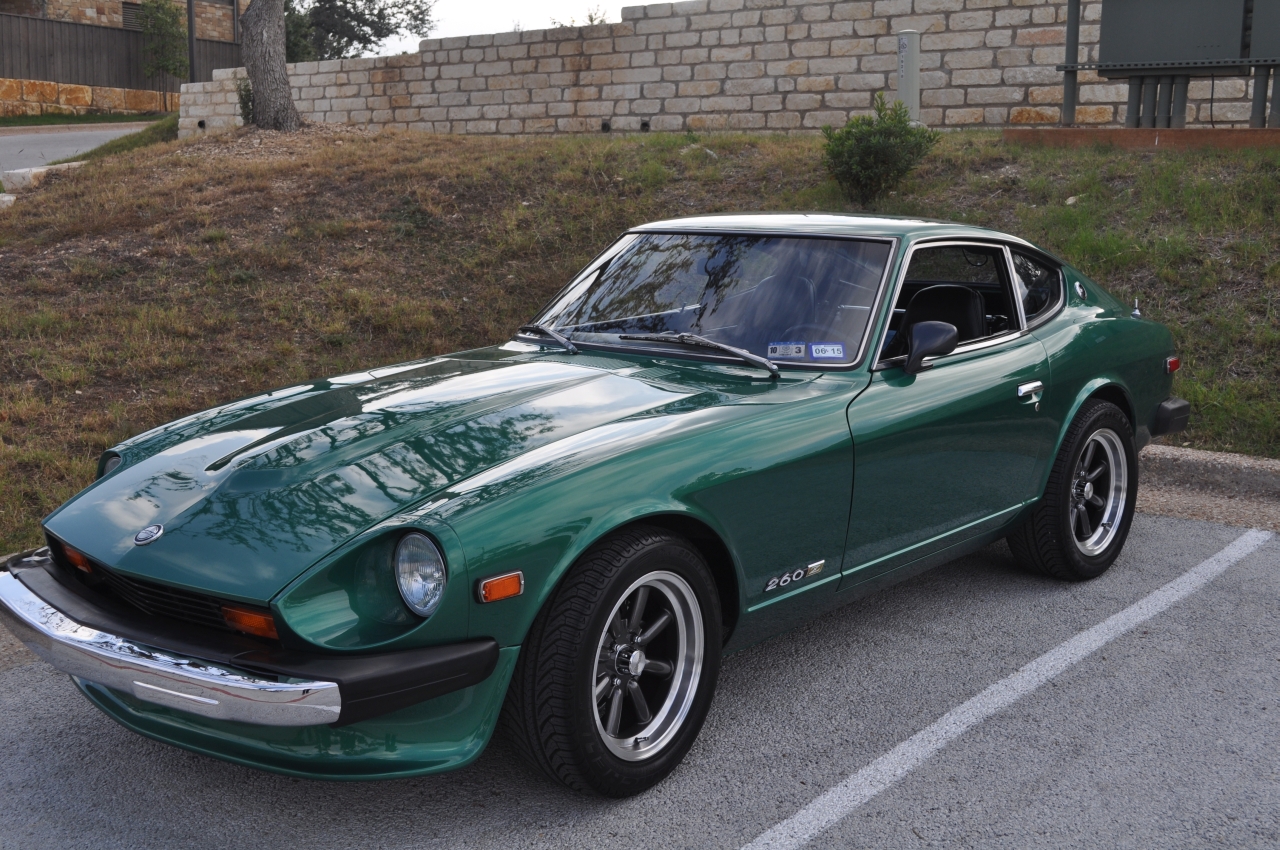

February 14, 20178 yr comment_512896 Zedy, Nice choice on the Rewinds. I run the gun metal grey version, 16 x 7. I went with the 16's as I felt there were a better selection of tires, both now as well as in the future. I also went with 225-50's for tires but did have a slight issue with rubbing in the rear when I went over big bumps in the road. Ended up rolling my rear fenders which solved the problem for the most part. Still get a little rubbing on rare occasions but definitely livable. I also have Eibach lowering springs as well as Tokiko Illuminas. I think the car has a really nice stance and definitely handles nicely. Here's a few pictures (before I completed my brake upgrade). Link to comment https://www.classiczcars.com/forums/topic/57060-msa-satin-black-konig-rewinds-are-coming-need-tires/#findComment-512896 Share on other sites More sharing options...
February 14, 20178 yr comment_512897 ^^^^ Looks great. I will be running the same setup soon myself. Good info. Link to comment https://www.classiczcars.com/forums/topic/57060-msa-satin-black-konig-rewinds-are-coming-need-tires/#findComment-512897 Share on other sites More sharing options...
February 14, 20178 yr Author comment_512899 Mike your car is always stunning. I recall your 225's looking very beefy at our rally. I will have to run some numbers on the 225/50 and how it compares to the 205/55 or 205/60  by the way, I have decided to go ahead and get my Z painted. Probaby going to use your guy in Austin you recommended. Thinking later in the year, but I think it is time to make another investment.   Edited February 14, 20178 yr by Zedyone_kenobi Link to comment https://www.classiczcars.com/forums/topic/57060-msa-satin-black-konig-rewinds-are-coming-need-tires/#findComment-512899 Share on other sites More sharing options...
