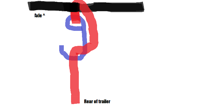

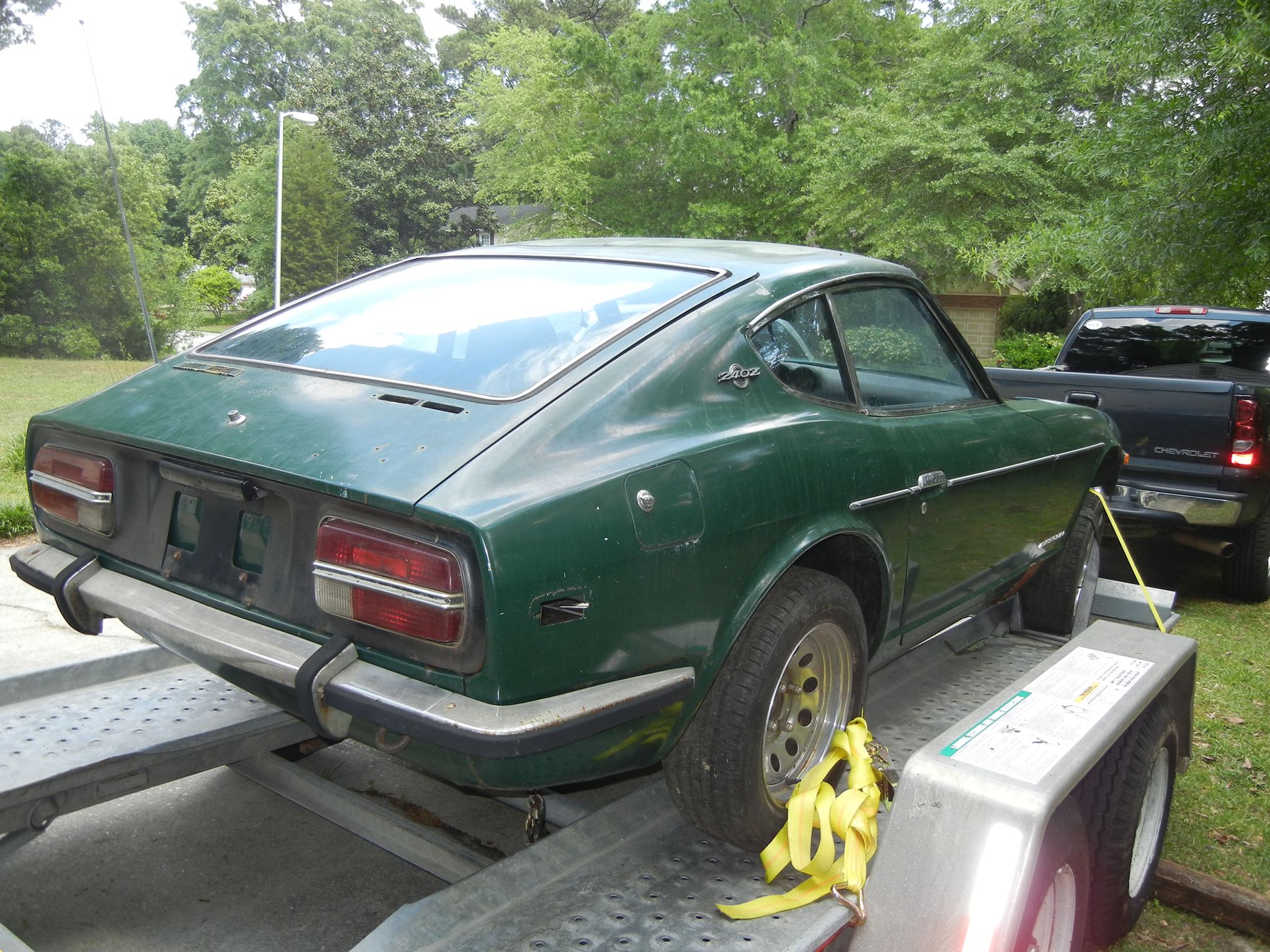

The one I got was grey like Mr Arnett's and the tie down hooks were at the rear, beside the brake lights.  I used regular cheapo ratchet straps and looped the ends around the axle and connected the hook to the strap, as I tightened them it pulled that tighter.  To be honest the front tire harnesses and ratchets will hold the car fine by themselves.  The rear ones just kept the rear of my car from bouncing while in transit, FYI, no need in anything fancy.  I didn't even cross mine, just straight back.

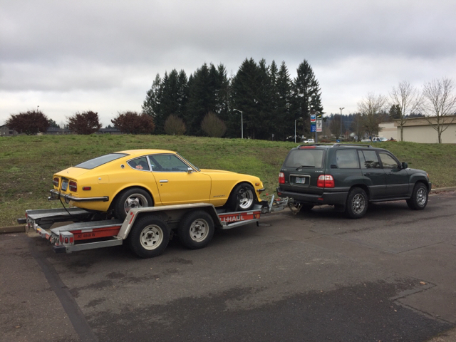

I have used a U-Haul trailer to haul 240Zs several times across NC.  The trailers are great. Put the Z on nose first (I usually have to use a come along for parts cars).  Once on, use the provided straps for the front tires.  Then, make sure you have a good set of heavy duty straps, not the cheap 4 pack from Harbor Freight!  Make sure to use the straps in a way that the car does not roll backward...or forward.  Cinch the car down and them drive for a mile.  Stop and retighten.  Then, every time you stop make sure the straps are tight.

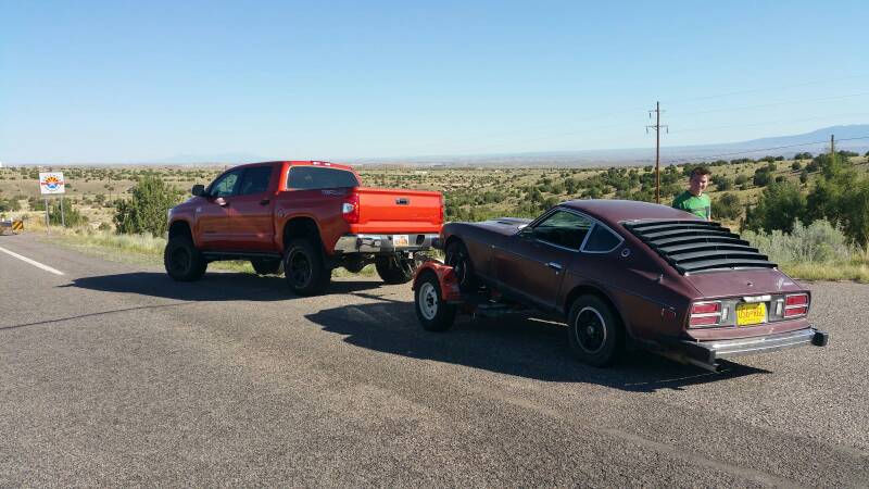

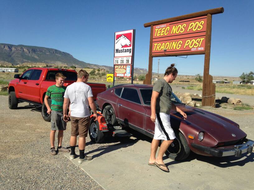

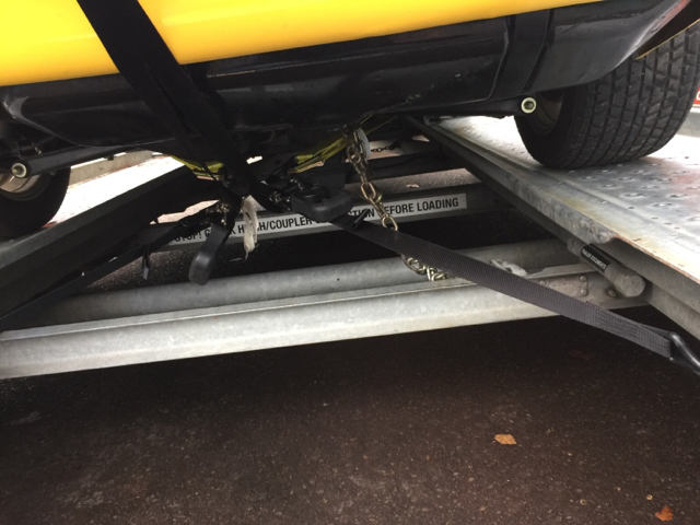

20160814_091906.jpg.bf23dace6dfbdbf9d081 When I bought my z we took it about 60 miles like the picture, but heard that it puts a lot of wear on the transmission.? Not very sure, it was a while ago. Bdcause of that, after the first 60 miles we turned the car around and backed it on the trailer. We just locked the steering wheel then put some tow straps around the steering wheel to make sure it was secure. It comfortably went about 250 miles at 70mph sitting like that. I apologize for not having a picture, I am trying to hunt one down.
15 hours ago, rcb280z said:
Just recently helped a neighbor load his daughters suv on a dual axle trailer and was told to center the vehicle on the trailer axles. He said it was "safer" this way. Interesting. Made it to the shop with no issues but then again it was a short trip. So forget what I said in post 6, feel stupid now.
Don't feel too bad.  With the U-Haul trailer I used the car had to be pulled all the way forward with the front tires up against the front lip of the trailer.  The front tires roll over the strap then you pull the strap up and over the tires, ratcheting them down.  Really no other way, the straps and ratchets are not movable plus you have to have some tongue weight.
Like Loudoun's picture above.
13 hours ago, idgemartin said:
20160814_091906.jpg When I bought my z we took it about 60 miles like the picture, but heard that it puts a lot of wear on the transmission.?
only if it is an auto transmission. manual trans doesnt matter

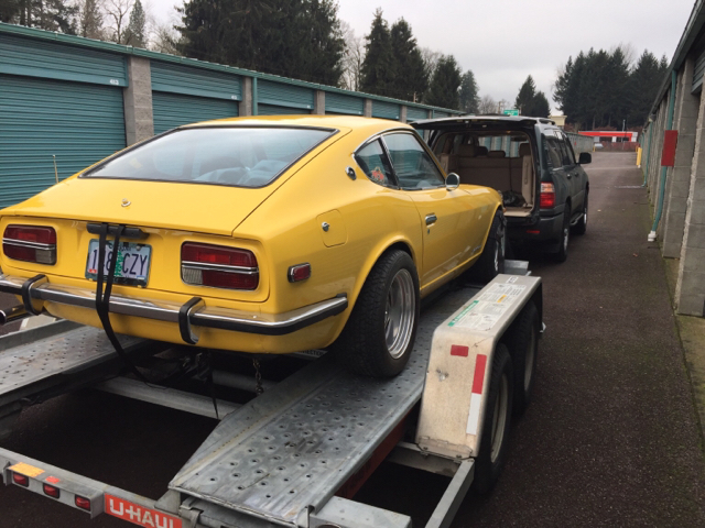

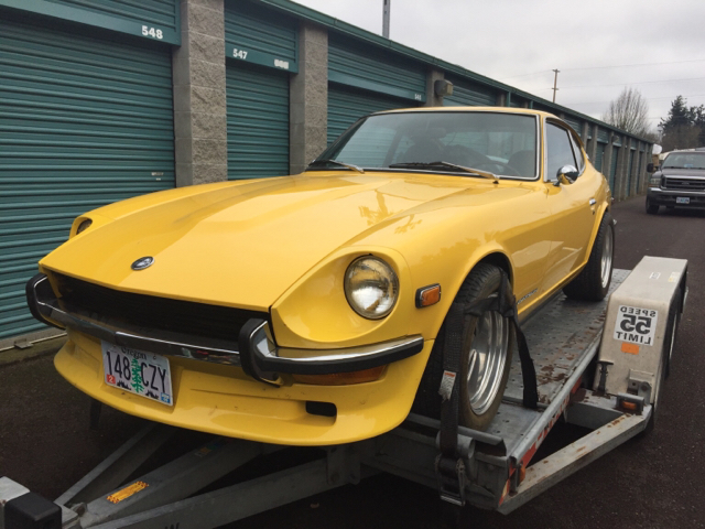

Well I have her loaded up and ready to go. I purchased a few things during my visit to u-haul. I picked up a set of differential straps, which I used for the rear cross bracing. I also noticed my existing hitch ball was a bit low so I purchased a new ball and flipped the tongue over to give it a bit more lift. Other than that it all looks pretty good. Check out some pics I took this morning. On the road now and typing this from my rig while I fill up with super unleaded. ;)

By the way, the straps going into the hatch are just the left over excess from the ratchet tie downs. I'm not actually tying down to the hatch. ;)
