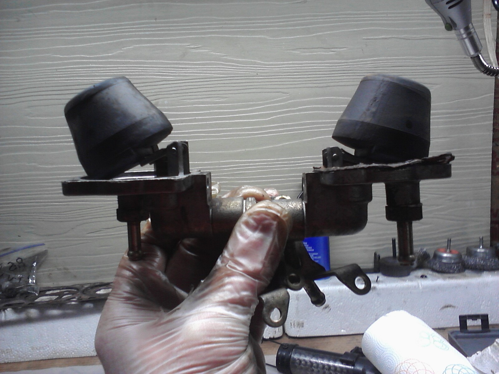

I'm thinking if you removed the float chamber lids you'd see something similar to mine when I first bought the car.  The floats should sit fairly level or parallel with the lids.  The opposite of my picture. ROFL
Fuel at the carbs does not necessarily mean fuel in the engine. There are small screen filters in the banjo bolt. The needle and seat maybe screwed. The hoses from float bowl to carb maybe kinked
took my floats out and they're NOT parallel like yours @siteunseen. checked the hoses and they're fine too. but i'll keep checking other areas of the carbs
