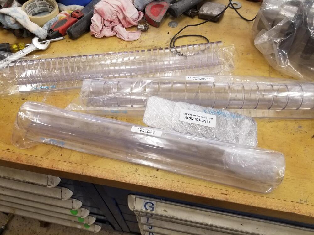

I thought the 18" curved would be nice.
I thought about getting a 24" straight but there are almost no straight sections on the whole car. Im not even sure the doors are truly straight.

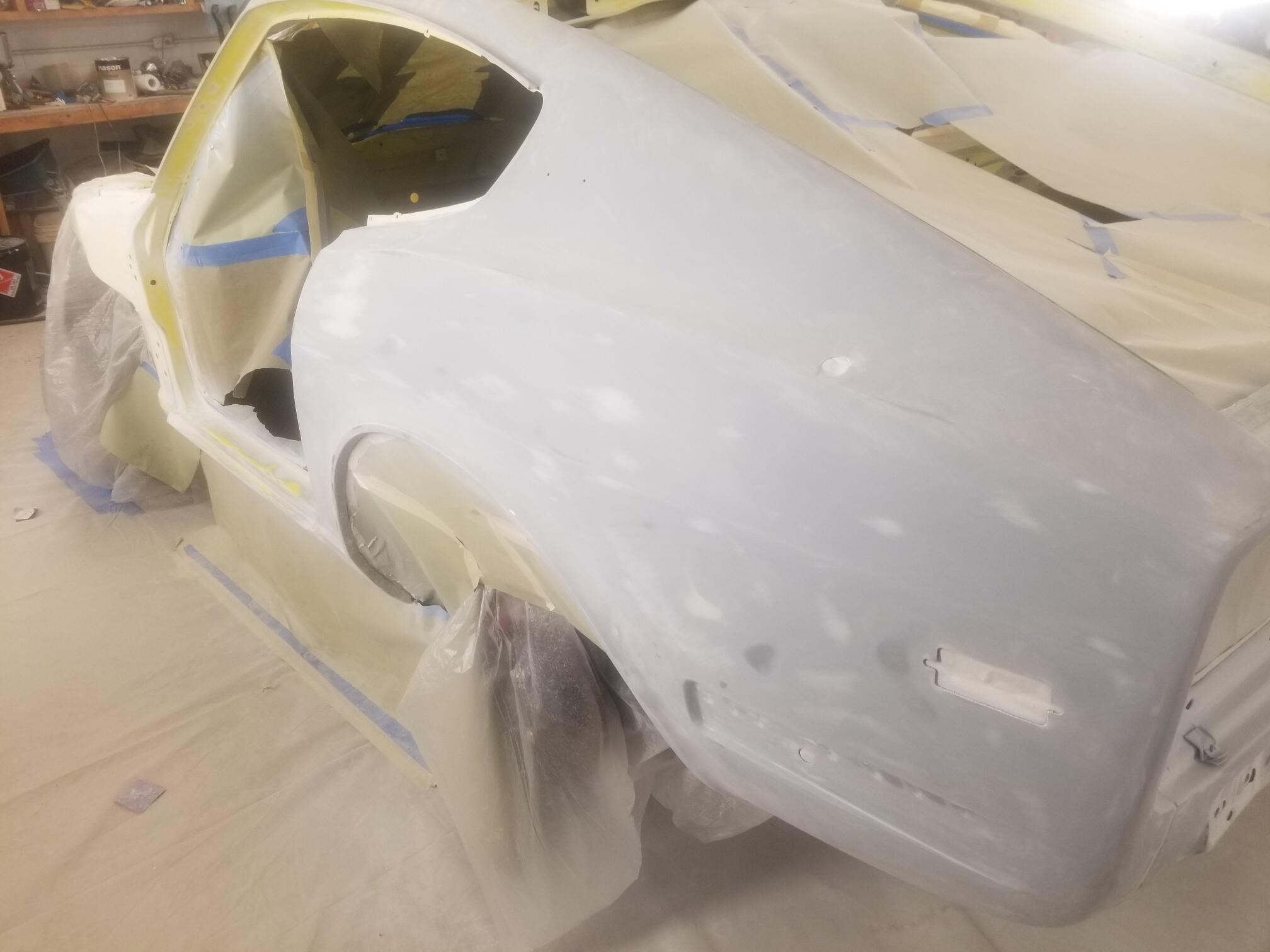

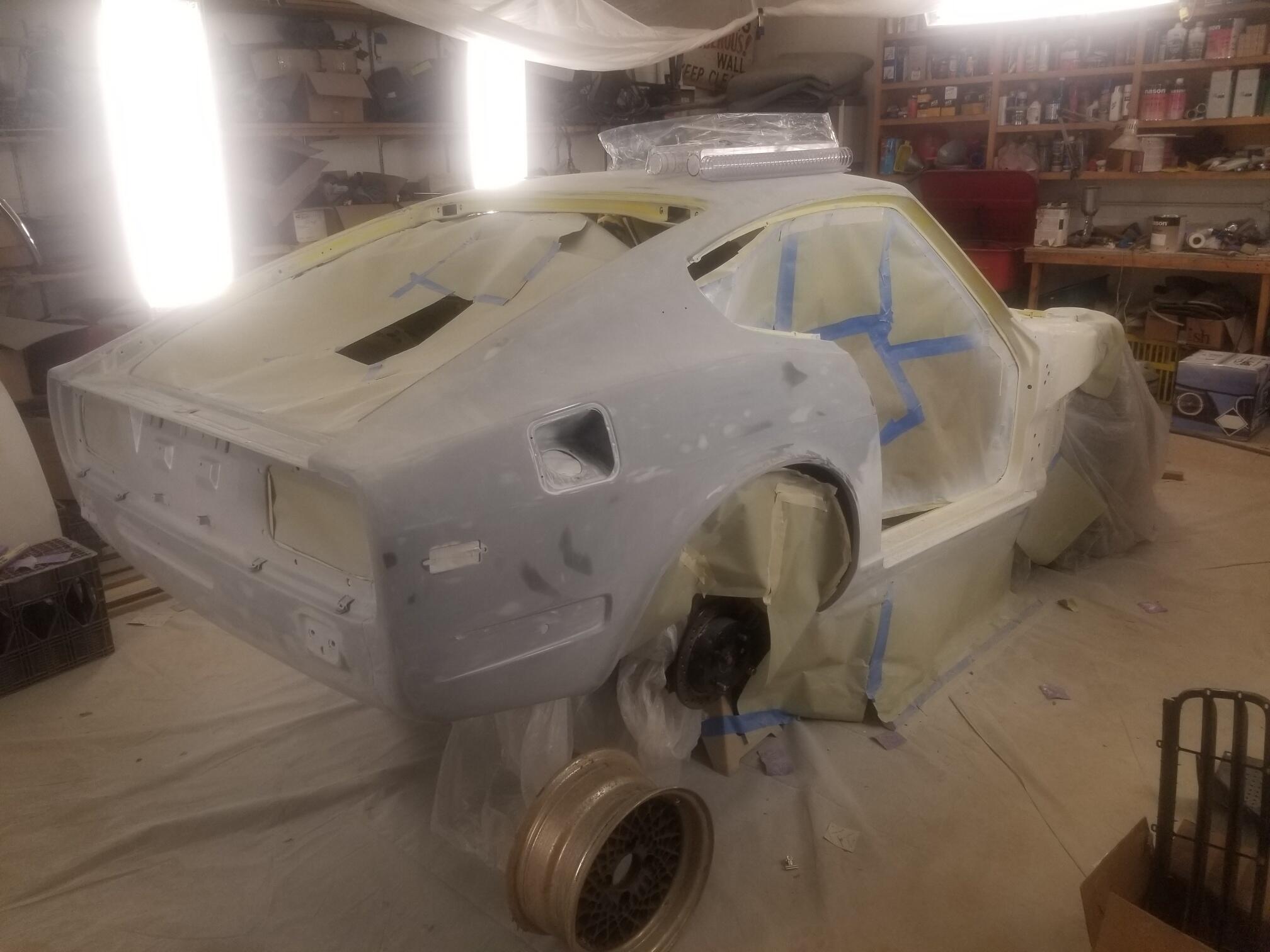

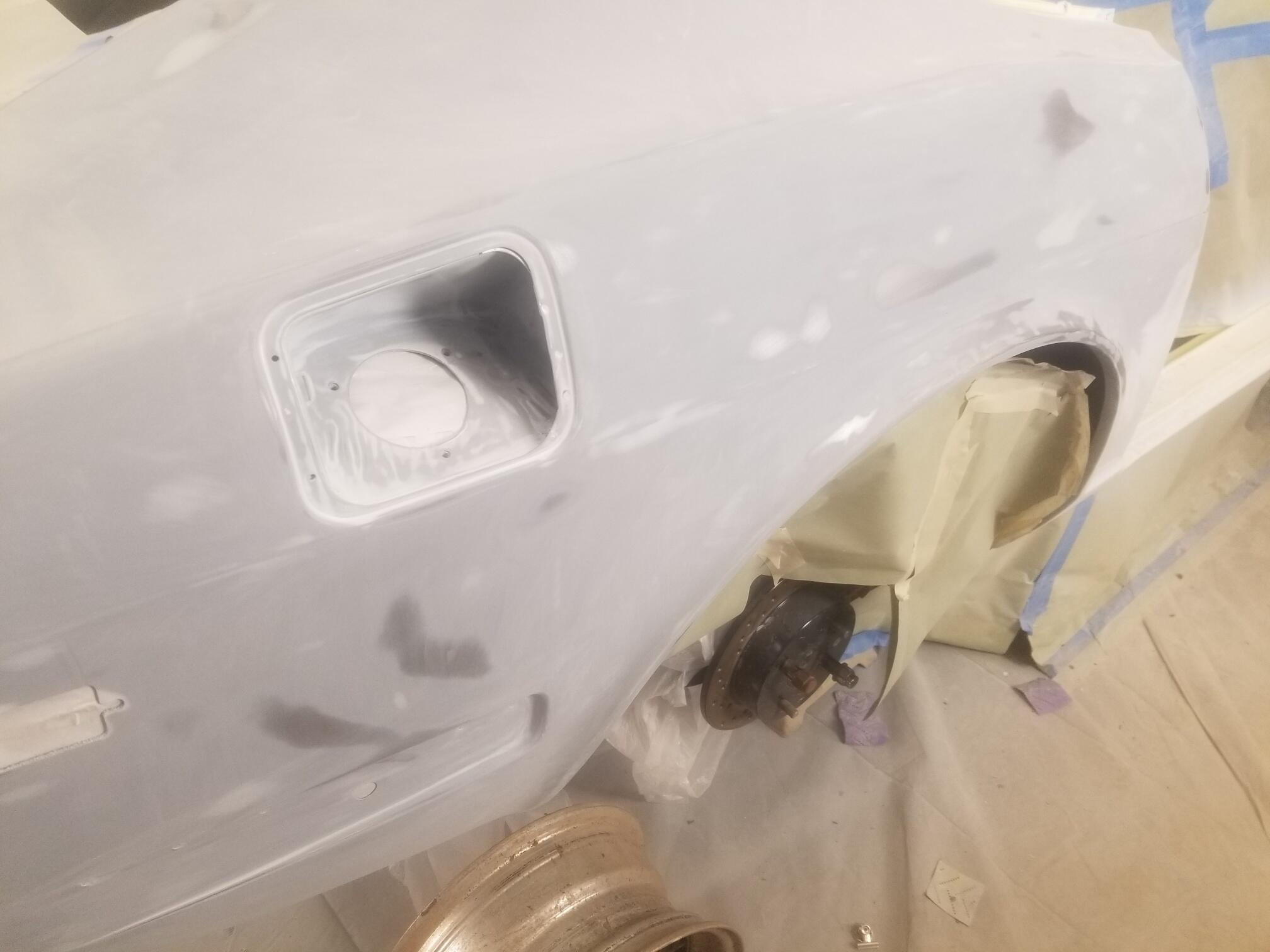

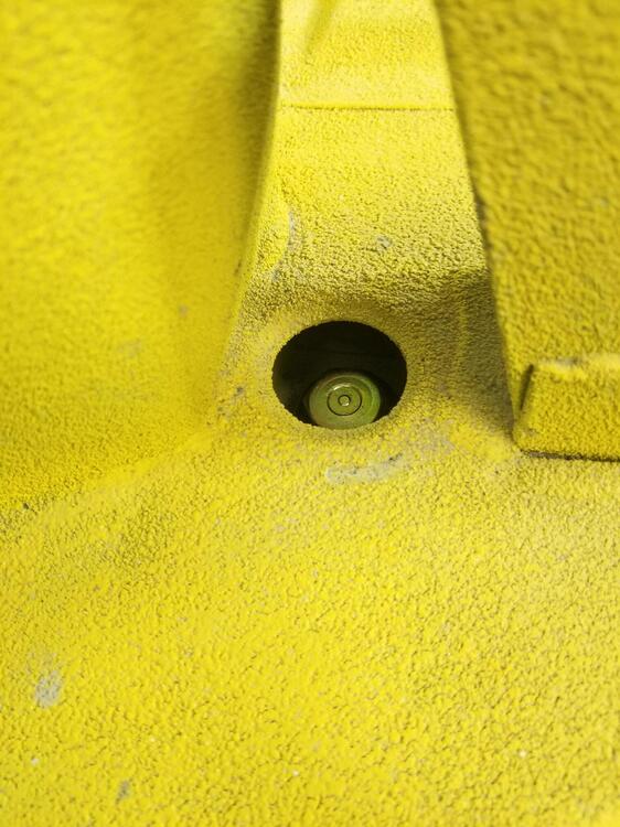

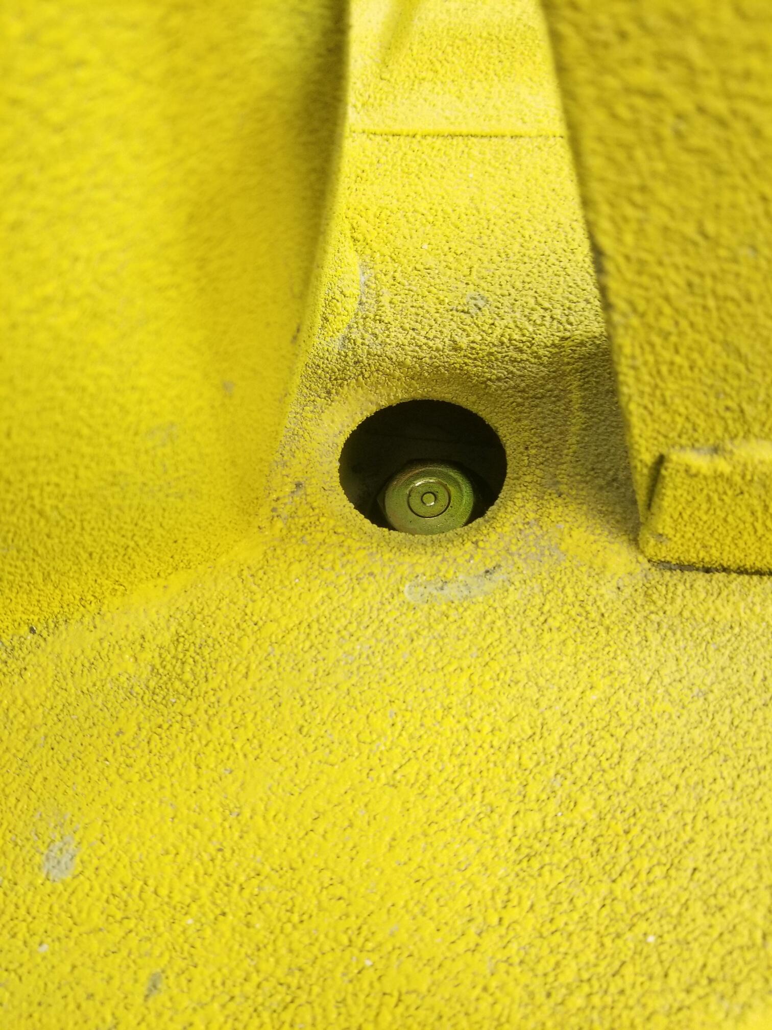

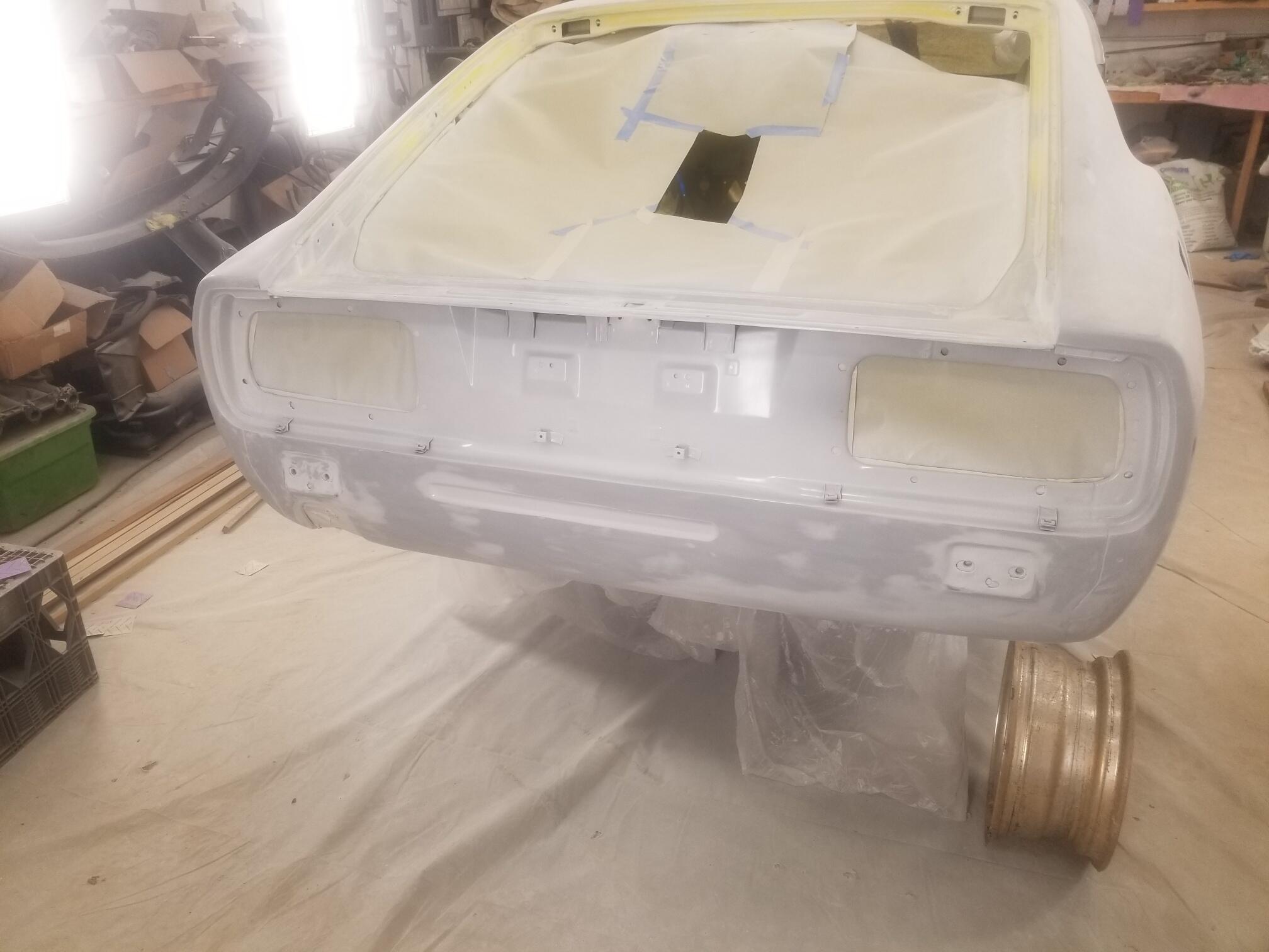

So here is where I'm currently at
20220129_141655_resized.jpg20220129_141702_resized.jpg20220129_141708_resized.jpg20220129_141713_resized.jpg
Most of the sealer is off the big surfaces. Still a lot of detail work to do! I just don't think I can get my shop up to temp and keep it there for painting. My shop is concrete filled block walls and floor. Totally uninsulated. There is an incredible amount of thermal mass to try to heat up and hold at temperature when it's 40dF outside. So I think for now I will switch gears and try to work on some other aspects of the car since it's too cold for me to paint. Possibly brakes, differential, drive train or other systems that I can bag up and keep clean while painting. This isn't my preferred method but it would allow some progress while it's cold outside...
When I do get back to paint, I have some new blocks to try and some Mirka PSA paper

Did you narrow down what happened with the sealer?
Not totally. I know it was mis-mixed but I dont know where the grit came from, chemical reaction or dirt...

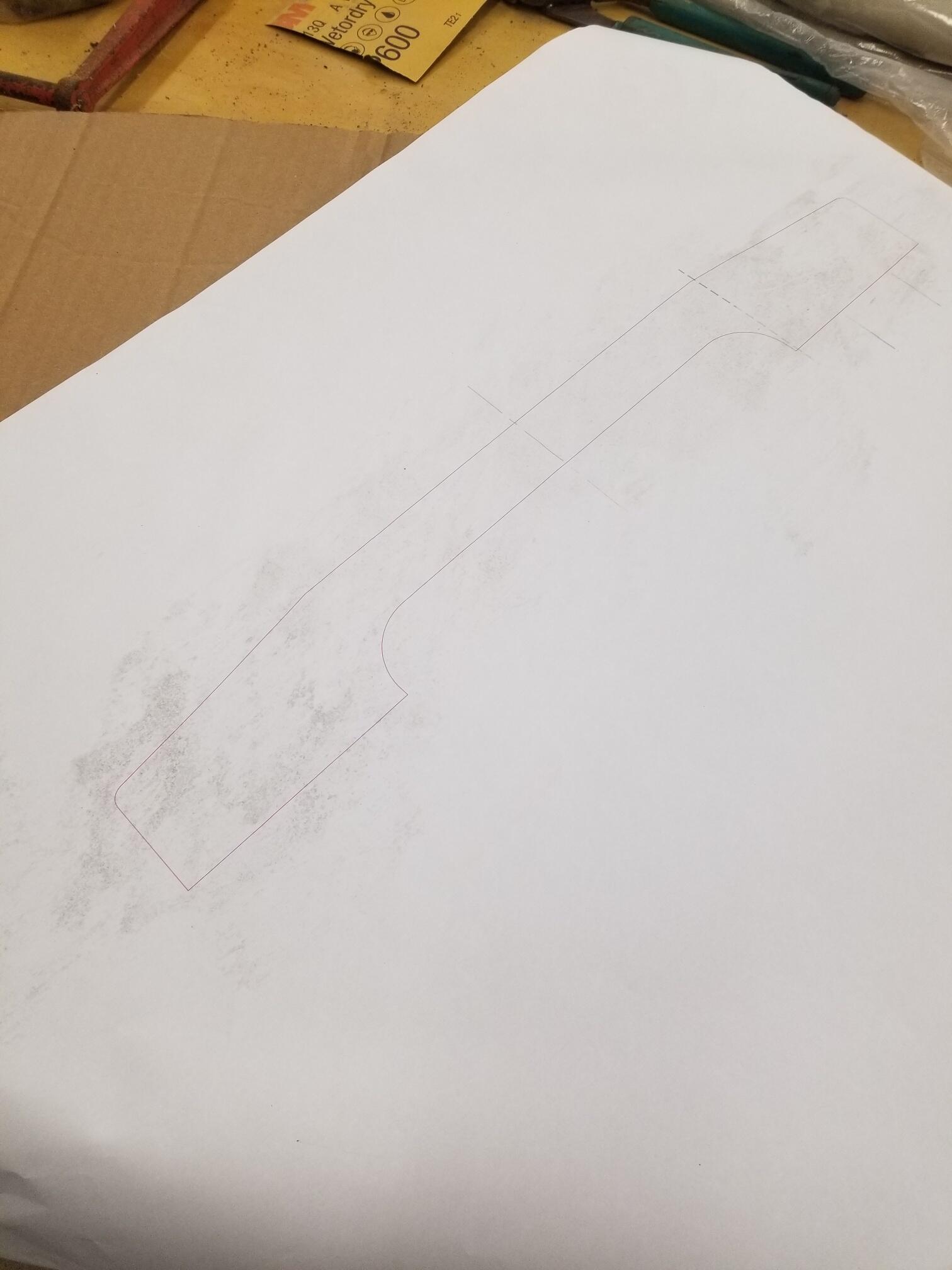

So I started working on the differential and differential brace to accommodate an LSD diff

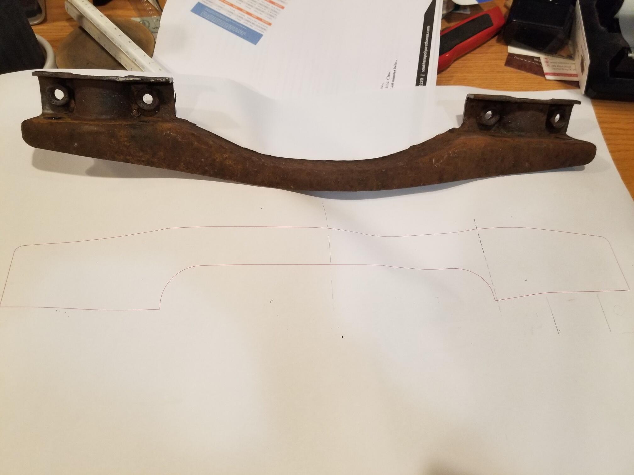

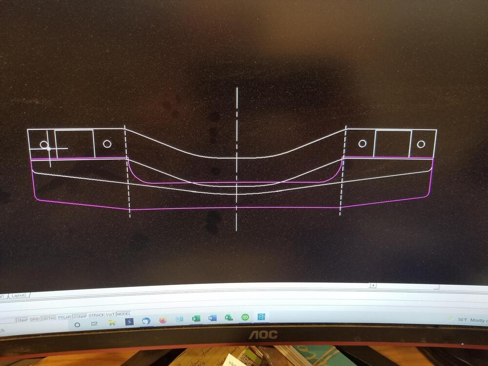

I drew the transverse assembly member in AutoCAD
Then I plotted it out on my big plotter and mounted it to cardboard
I also got the bolts for the musache bar back in the chassis. I had asked a year or to ago for torque values but never got an answer so I Googled generic torque values. They're 18mm thread and I assume they're 8.8 so I torqued them at 130#'s with a little blue lock tight. I could have gone all the way up to 200#s supposedly but that seemed like enough.
I got the mustache bar hung. It's interesting you can't install it with all the other suspension in the way. I was able to thread the chassis bolts up and down so I didn't have to disassemble the suspension

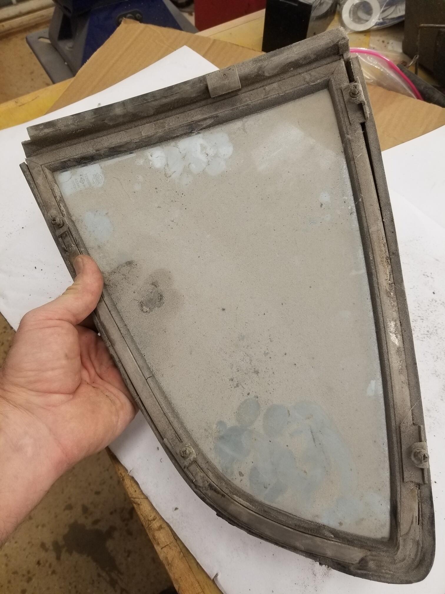

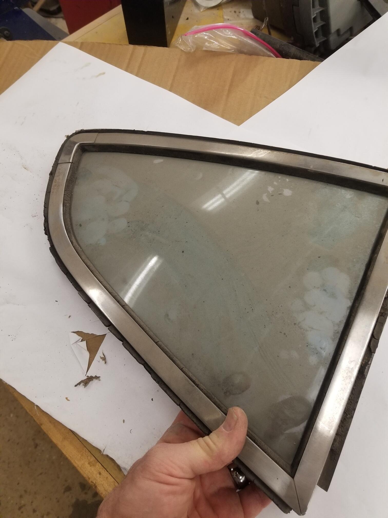

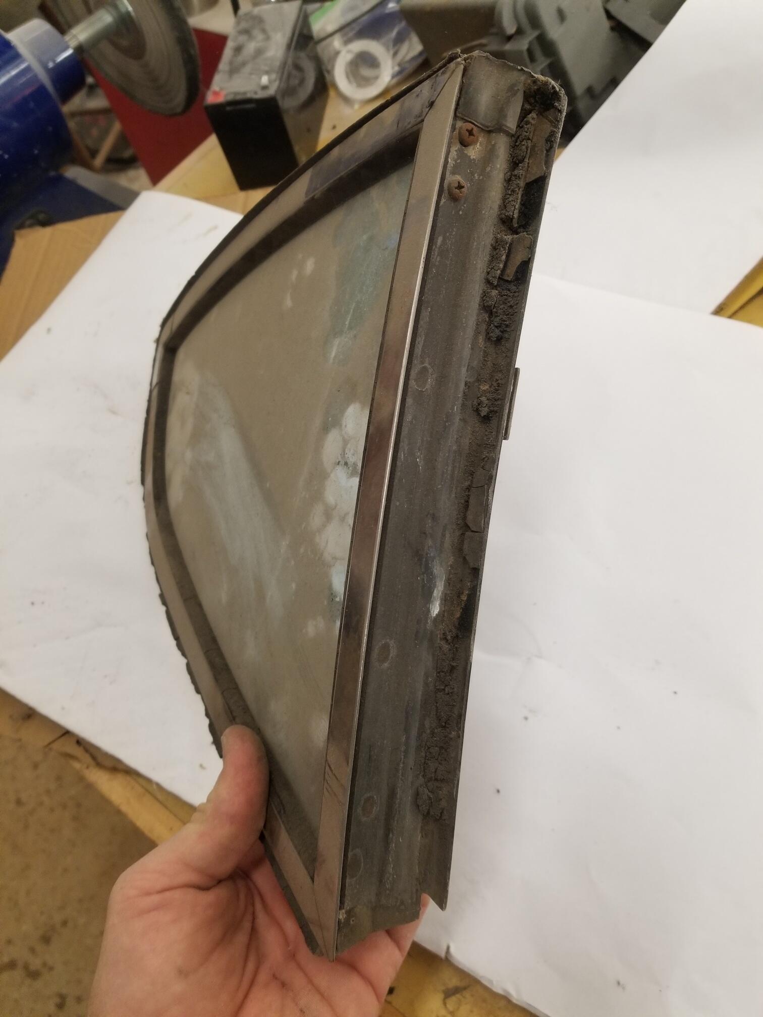

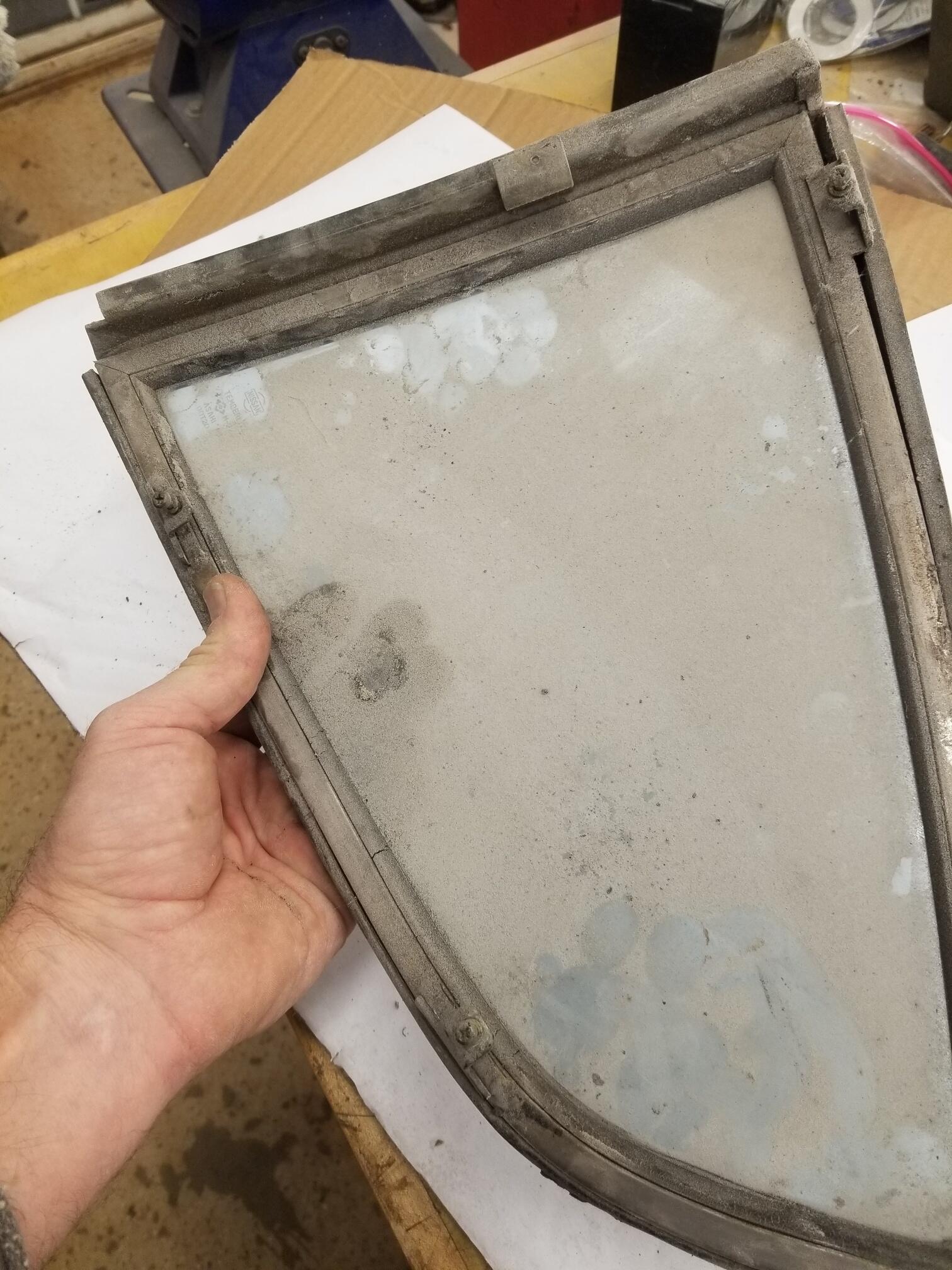

And.. yes those are the right rear side windows.. 🙂
