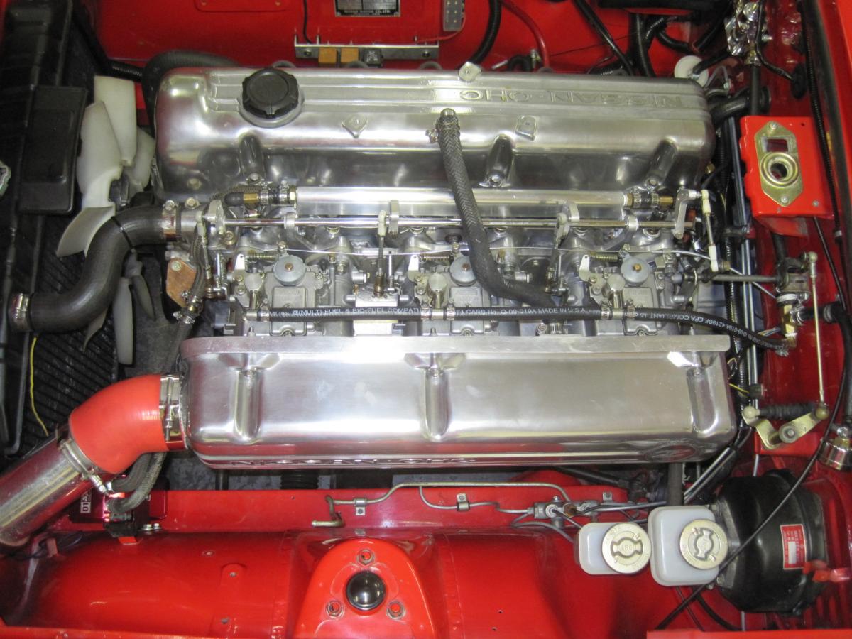

Do you have SUs and their air filter?  That's where my valve cover vents to.  And then the block goes to the balance tube, where the PCV valve is.
If you have triples, nevermind.  There's some guys on here that'll chime in later on that have that set up.  Keep bumping the thread up. :)

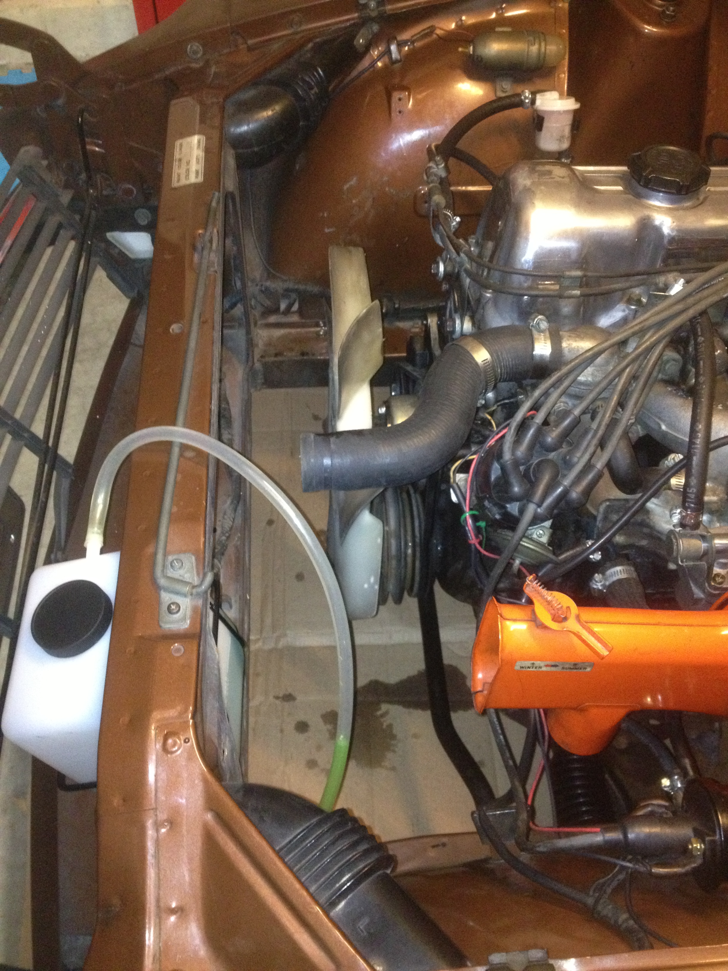

Probably hard to find and or follow on mine. Down in left front corner . I pull vacuum off the center of the vacuum log. Got lucky that an old booster hose actually routed correctly around everything. I went with the catch can because I also run a MAP sensor off the vacuum log also. I was actually getting oil condensation in the MAP hose.

Not entirely sure how well this works, but it was already on the car when I bought it and the PO generally seemed to know what he was doing when he set the car up, so it stays.  It does take in a little oil from time to time though, so it saves mess from accumulating elsewhere in the engine bay.
Basically just rubber lines from the crank case and valve cover meeting at a y-pipe, then running into the catch can.  I had a K&N style filter on there before, but it regularly became saturated with oil, so I switched to a fancy billet Earl's filter, which handles the job a little more tidily.
